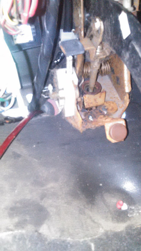

Here's the test for the switch.

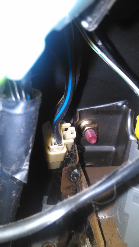

I'm pretty sure the one on the floorboard is the interlock switch.

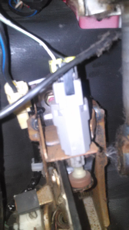

Pretty sure this is the interlock switch.
This one's for the cruise control.

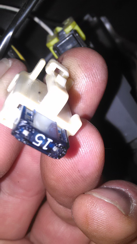

One guy bypassed his interlock switch so he could start his car without pushing the clutch.
You just unplug the connector and plug in an old school sized fuse.
You could bypass the switch and see if your car starts all the time then replace the switch or just leave the fuse in.
(I don't like that "mod" because I'm sure I'll end up starting it in gear and driving my car though the neighbors house. lol)
I bypassed the interlock switch on my parts car. (it's not going anywhere. lol)
It's a regular fuse from our car that fits.
