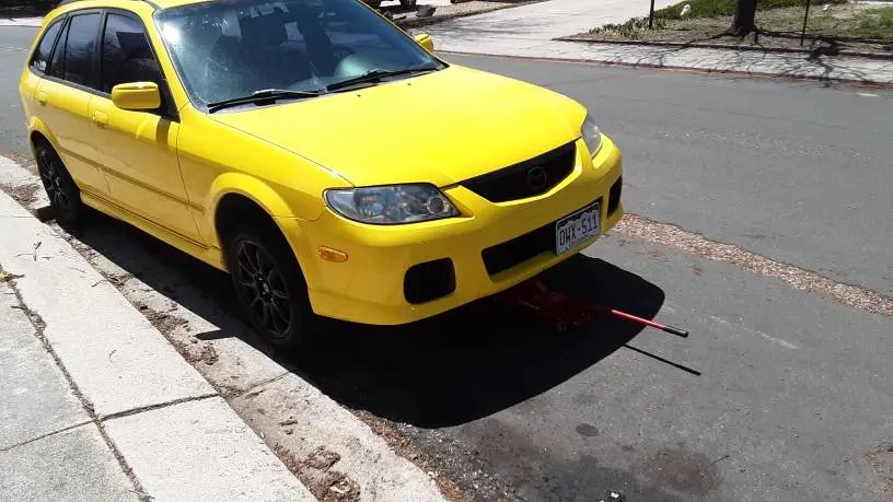

I want to try knocking on the starter, but I can't get to it safely. As it sits, there's not enough ground clearance for me to get under. It's also parked on a hill, which is turbo-sketchy when you try to jack up your car. And even then, jacking up one quarter section of my car at a time (thanks to no real middle jacking point) is even more dangerous, since my stiffened chassis lifts up the rear wheels right along with it.

Do you have a jack and access to these jacking points ??
I have to lift from there, my frame rails are all rotted and crunched in.
The front one is about 1 1/2' underneath and about 3" towards the drivers side.
It's a 3" round bump that fits nicely into the lifting point of the jack.
I jacked up the car lightly so that both wheels were still touching the ground. I reached underneath with a ratchet, banged on the starter a little, and it wouldn't start.

Jeez...it's been about a week since my car stopped cranking. As good as the beater van's 3.5L V6 is, it doesn't give me the same joy as my P5. 20190415_125505.webp
