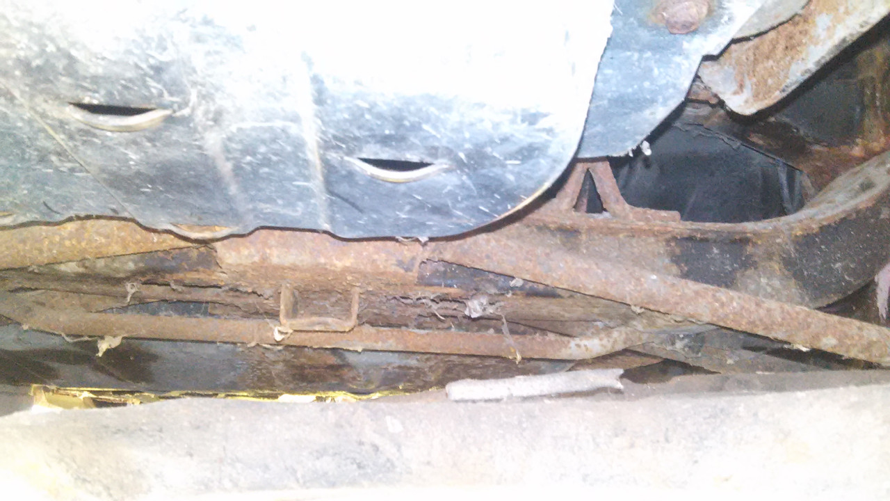

.., I think I'll bite the bullet and replace my rear subframe with a new one. My jury-rigged swaybar setup tests my patiencd, lol.
I've got rear subframe I'll sell ya for real cheap !!
I'm sure it will polish up real nice !!
It's super lightweight too because there's no metal left !!
It all turned into rust and fell off.
Lol.
You know what? You make a really good point.
Only problem is that in order to install the lateral links, I need to drop the subframe a little, which means risking breaking weld nuts I can't fix.
Now I'm paranoid!
Really slow, really careful and do it by hand maybe using a torque wrench.
It says it's tightened to 27-46 ft/lbs so I'm sure you can crank it to at least 100 before breaking anything.
Horseflesh broke the heads off his bolts not the welds.
That's actually better because you can drill out the stud or even have enough to grab on to.
You could also apply some heat and try your impact driver.

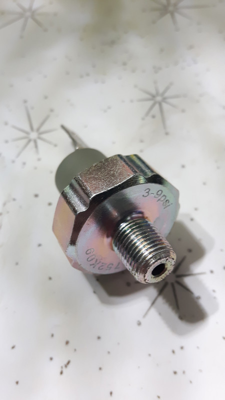

You simply unscrew this thing and screw in the new sender unit, feed a wire to your dash gauge and maybe B+ and you're good to go.
(note how the pressure switch is rated 3-9 PSI)

... However, I've been told that I need to T that connection off, since unplugging the oil warning light unit keeps it lit eternally...
Our oil pressure "sender unit" is just an on/off switch.
If unplugging the wire turns the light on, then you just ground that wire to permanently disable it.
The output wire of your new sender unit will probably be a variable voltage depending on the amount of oil pressure.
I don't think you want to T-off to that wire.
If it were me I'd want an oil pressure gauge that shows the pressure but also has an low pressure alarm as well.
You would set the alarm for 3-9 PSI for city driving then set it to whatever for race day.
The alarm should go off at idle on race day but shut off when your RPMs climb then go off again when you start sucking bubbles.
