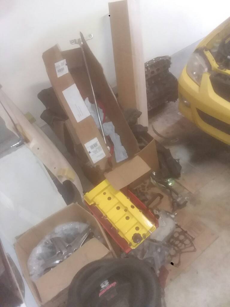

Yellow for the win, it's kinda buried right now but it's yellow haha
Heck yeah, looks nice! Hope I can get mine to look as good as yours, but I'm going to try and keep my letters :^)
Did you use any kind of engine degreaser product? I'll be honest. I did a half-assed job cleaning up the intake manifold upper-half DP sent me, and want to do a good job cleaning an aluminum part for once.
What all did cleaning and polishing your valve cover entail?
Honestly I shaved the letters because I couldn't get them clean enough. First I sprayed it down with brake clean and a green scrubber pad. Then I just went over it with some sand paper, i sprayed it down with brake clean at the end too. It turned out pretty good, just make sure you do really good on the sanding. The paint doesn't like to stick to aluminum unless it's got a rough surface, I think I used like a 60 or 80 grit.

Alright, valve cover's base paint layers are on!
It came out mostly good; there are three notable spots where I missed some paint layers. However, it'll be hard to gleam from the above image. I did, however, forget to pull that rubber boot the PCV valve slides into at the top of the VC. Dang!
Now, I got to find a way to paint the letters black. Judging by how intricate the letter shapes are, this is not going to be easy. I'm half-tempted to just file off the letters and have them stay silvery, but I dunno. I'll be thinking about this. If I could use a paint pen, I definitely would.

Yours turned out real nice man, are you gunna clear coat yours? I almost left my pcv boot in too. It's a real pita I had to cut mine out, was like a rock.
I actually did after that picture! It's really nice from the front, but I really goofed up the rear. The coats in the rear are far too light, but I can fix that. However, my attention is on some pressing issues in my car now :^(
