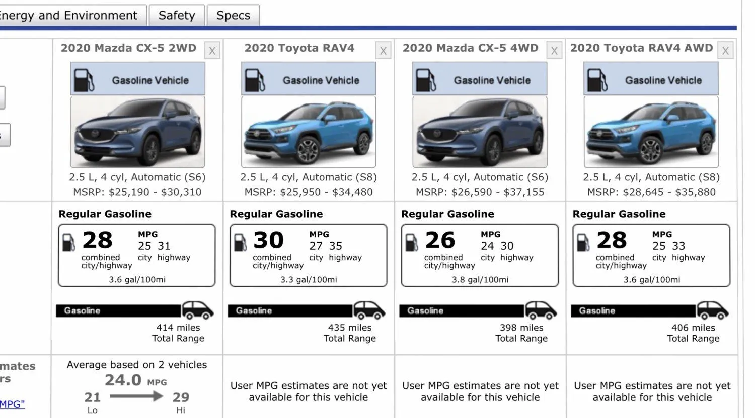

By comparison, 2020 Toyota RAV4 with 2.5L has better MPG (see EPA comparison)、more horsepower (203 hp vs. 187 hp) without use anything like cylinder deactivation that CX-5 2.5L uses
It would be interesting to see the CX-5's fuel economy rating if it gained two gears and lost 180 lbs. like the RAV4.
And the thermal efficiency from the engine. Toyota’s Dynamic Force 2.5L has 40% / 41% (hybrid) thermal efficiency which is the industry best for mass-production engines.
