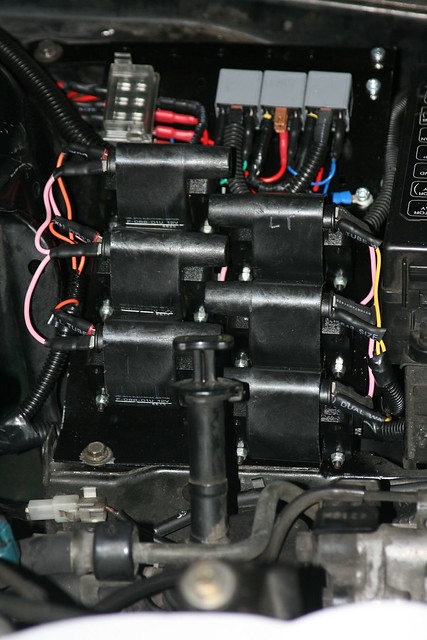

I like how you mounted the coils. do you have any more pictures? I mounted mine on top the rotor housings, and looking back I wish would have mounted them someplace else. I think while my engine is going to be out of the car I will relocate them.
I would have preferred to of mounted them on the housings, however because I had to retain the factory loom, it meant that I just didn't have the space. The battle with mounting the coils where I did was getting them low enough in the engine bay so that they would clear the bonnet when closed. I had to make custom brackets out of aluminium to get the right the clearance as I couldn't find anything pre-made that suited. I just used some 90 degree aluminium to do it.
IMG_8556 by bertybeatle, on Flickr

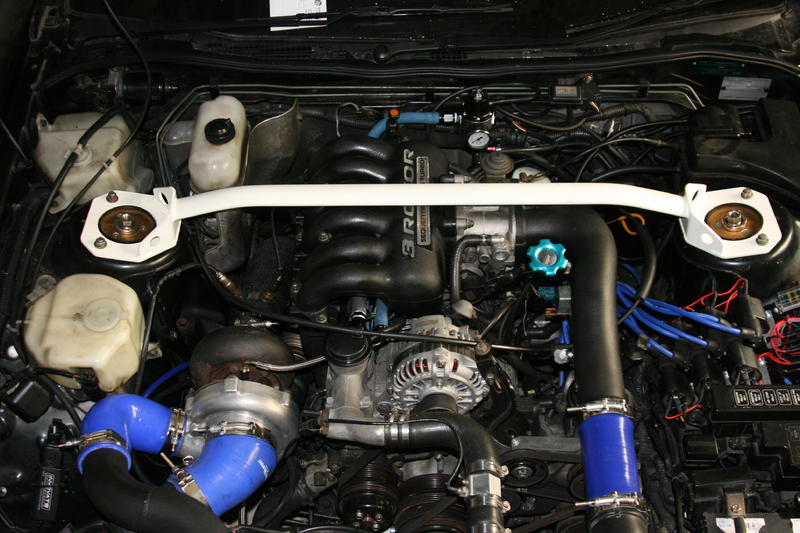

I am just test fitting the injectors at this stage. Note the fuel hose I am using in this picture was just a place holder until I could get the right stuff. I had to grind the throttle cable mount of the thermostat housing to fit the rail in.
Turbosmart FPR2000 to match the AN8 fittings on the rails. It was a real pain getting to mount properly to this point of the cars body. Lots of stuffing around to get the drill onto the right angle.
Ignore the blur, it was meant to be artistic shot of car parts. (oxymoron?)
Here is the wastegate just chilling out. The picture really doesn't capture how big these gates are. I had to a new hole plumbed into the top of the gate due to its new mounting positing. I replaced the 7psi spring with a 14psi, that way I can ramp the boost up to 28PSI via the DSBC.
Loctite 567 is my savior.
THIS... was a pain in the ass. If you want to run AN8 size rails, then you need to grind your manifold down to accommodate the extra size. Don't do what I did though and grind right through the bloody injector runners. GRRRR.
Took the LIM to the fabricator and he welded some 2mm aluminum to hide my shame. This manifold also got the black crinkle coat treatment.
Bling.
