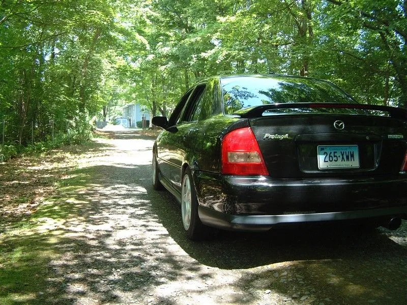

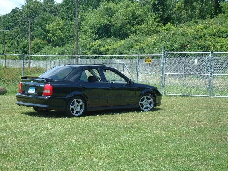

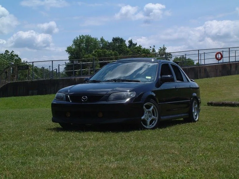

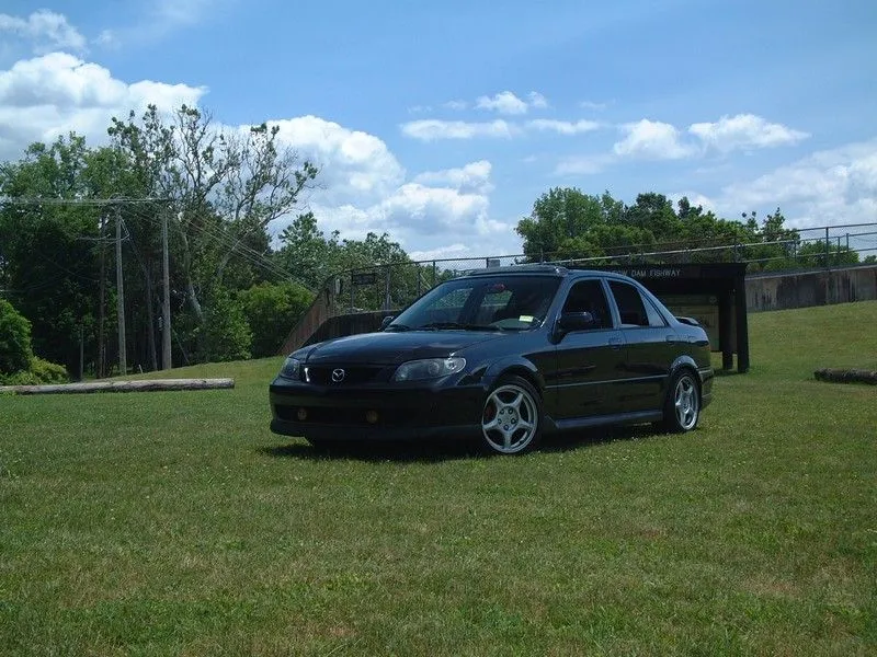

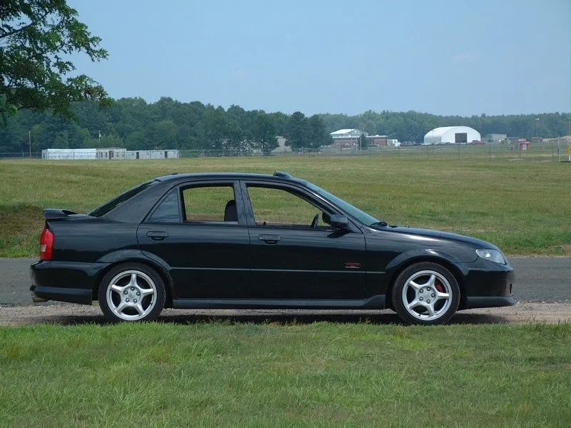

here are some shots from last summer. the set-up fits very well on the protege sedan. i have ZERO rubbing.
i'm not sure how they would fit over the mazda6 brakes. i "think" they are the same size as the MSP front brakes? if so, then they will fit fine, as i have the MSP front brakes on my car, too.
