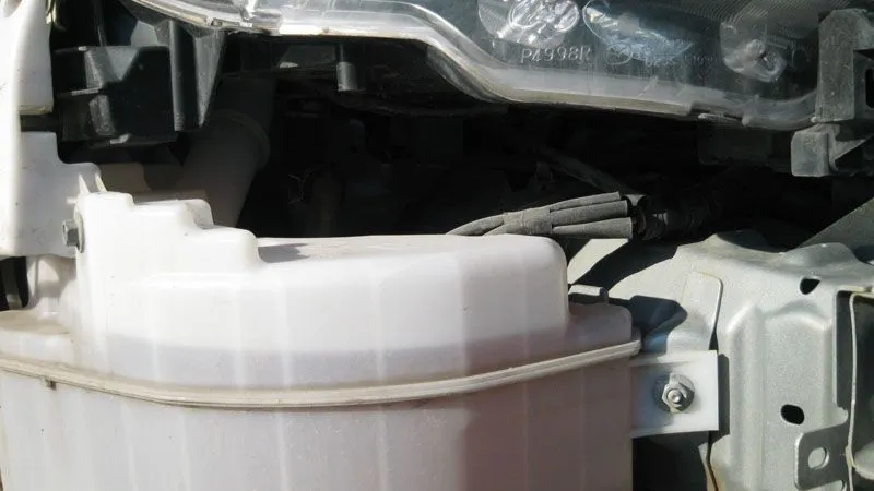

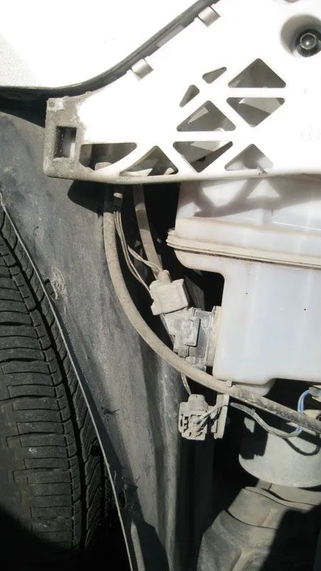

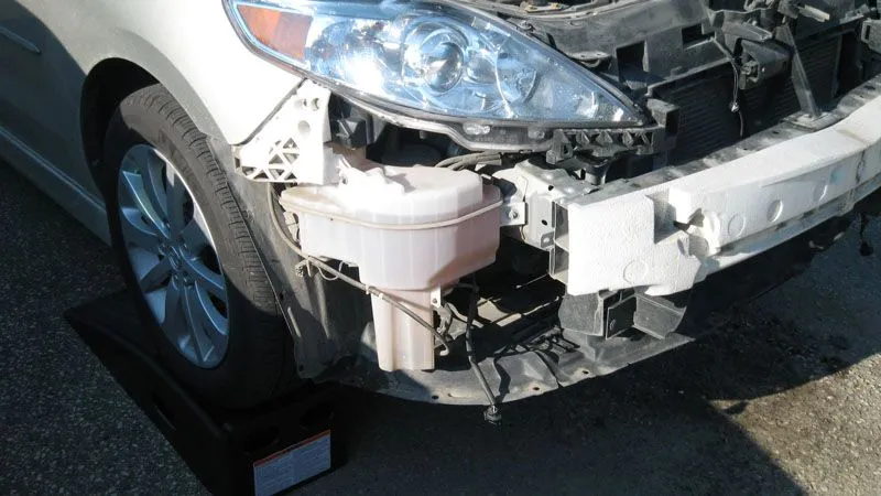

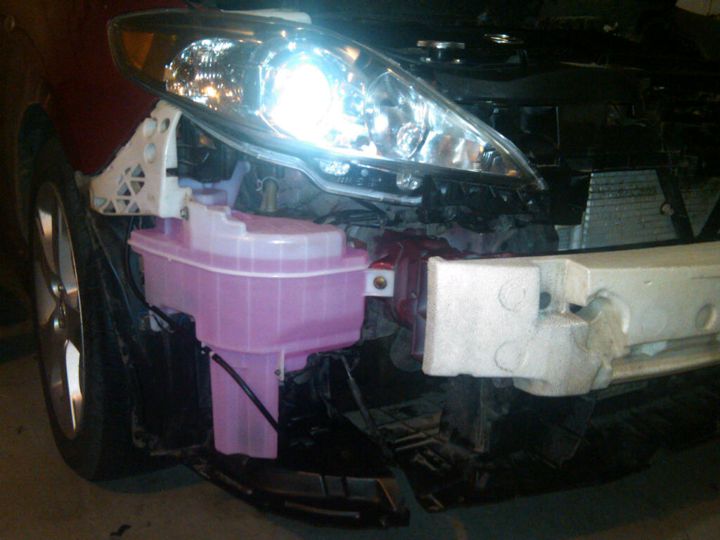

If you do end up replacing the reservoir here's the pics as promised. It doesn't look to bad. The only problems I see are the connection points for the low fluid indicator and the feed tube. They look like the kind of connector where you have to look at it with the exact right expression on your face to get off.

Thanks these pics are great, I haven't had a chance to get to it yet, will most likely tomorrow. This pics at least show me that it will definately be worthwile to rmove the bumper so that I can get the access I think I'll need in order to patch the hole properly.
