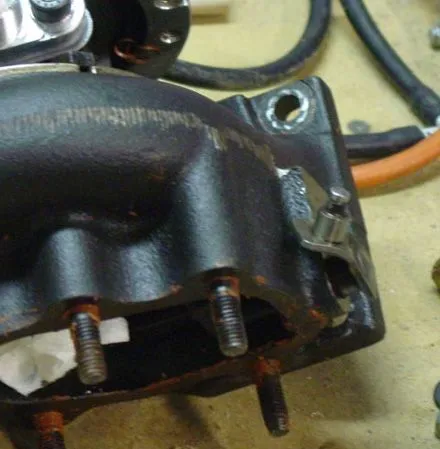

I have a question for you MSP turbo people... I was wondering if my wastegate actuator bracket is bent. I attached a picture. It is bent at 45* angle. I couldn't find any pictures of other turbos where it was visible.

Mine had a slight bend it it as well. I thought it was to accomodate the wastegate actuator arm which comes in at an angle.
