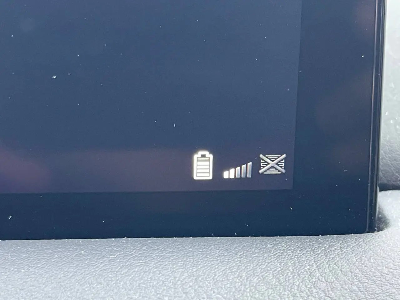

Managed to disable the TCU calling Mazda. All of 14 minutes on the phone. Validated with their rep on the phone, i now have the X in the bottom right corner. App is disabled/uninstalled.
I'm puzzled about disabling the TCU. From the posts above and other threads, it seems like the only way to disable the TCU is to call Mazda.
However, a couple days ago, my 3-year trial for Mazda Connected Services expired (2022 CX-5 Preferred). I did not opt to subscribe.
I noticed that my indicator on the Infortainment appears like the photo from TwinPeaks above. Is Mazda now doing something different, or do I still need to call to confirm my TCU is disabled?
