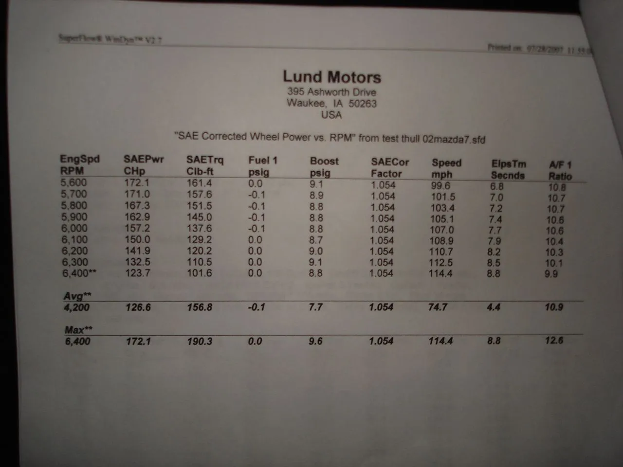

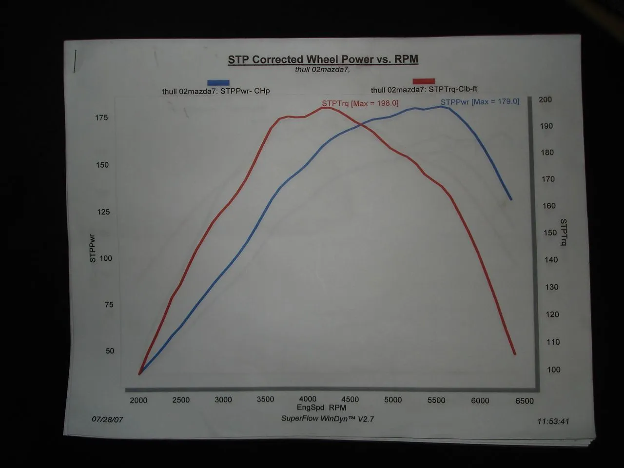

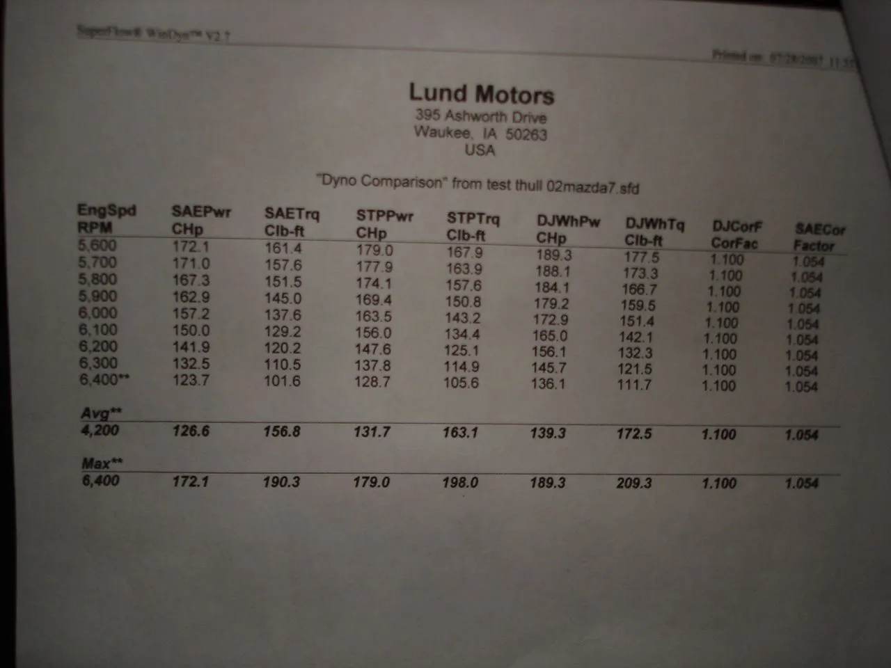

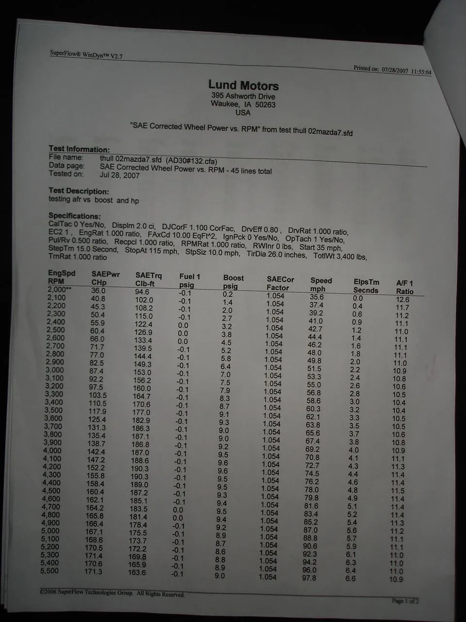

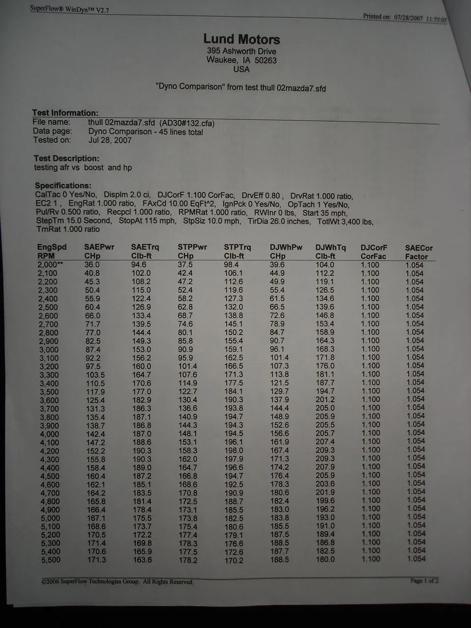

Dyno'd... 200 wtrq; 180whp @ 5500rpm then it tapers off. I'm definitely having some issues that need to be sorted. I'll post the logs later.
max power at 5600rpm 9.1psi 10.8 afr
max torque at 4300 and 4400rpm 9.6psi 11.4 afr
6400rpm... 123hp and 101tq, 8.8psi and 9.9afr eeeeww!!

I made about 3 or 4 runs; a little change in the tuning each time. The car has fell flat around 6k since I went turbo, now I have dyno evidence to prove my theory. It WAS hitting max duty at 6k+ and cutting out, but I'm not sure if it was after I made some changes. I can just go out on the street and do a run real quick with the laptop logging and check.
The Microtech logs timing but I didn't take a look at that yet. As far as fuel goes, we couldn't figure out how to easily hook up their system to monitor the pressure. That would have been nice to figure out what was going on with the max duty... I don't think the injectors are too small (440s), but perhaps the stock fuel pump can't keep up.
I'll post the sheets with AFR, power/torque, and boost pressure in a little bit. I have to type them in or something. Maybe there is a program that can convert the jpg to xml, that'd be nice :D
This was pretty much a baseline and got my boost section cleaned up a little bit. Now I have an idea of what areas need lots of fuel taken out and which don't. Eventually I'll take a road trip to a shop that can better tune it (and maybe mess with timing).

wow that's a painful torque fall off.... usually can even that out with some timing advance as you pull through redline, but don't know what the operator was or wasn't doing and I didn't see an AFR log tied on there... but overally looks good... what psi were you at?
stock fuel pump could explain it... I know we were able to push 250-260 whp at 15-16 psi on stock fuel injectors with a walbro in-tank pump and stock FPR.
wow.. they have you just sick rich at as the rpm's go up.. I usually try not to ever let a car go richer than about 11.5 unless I have detonation issues I can't solve with timing... I usually tune to about 11.8-12.1 through boost...
Unfortunately that was me tuning. We did about 4 pulls and in between each I'd mess with the maps. I have the ATP wastegate which should do about 8psi, but I did turn my boost controller up a decent amount. For whatever reason, the boost also tapers off in the top end. I may have to try a new in-tank fuel pump.
