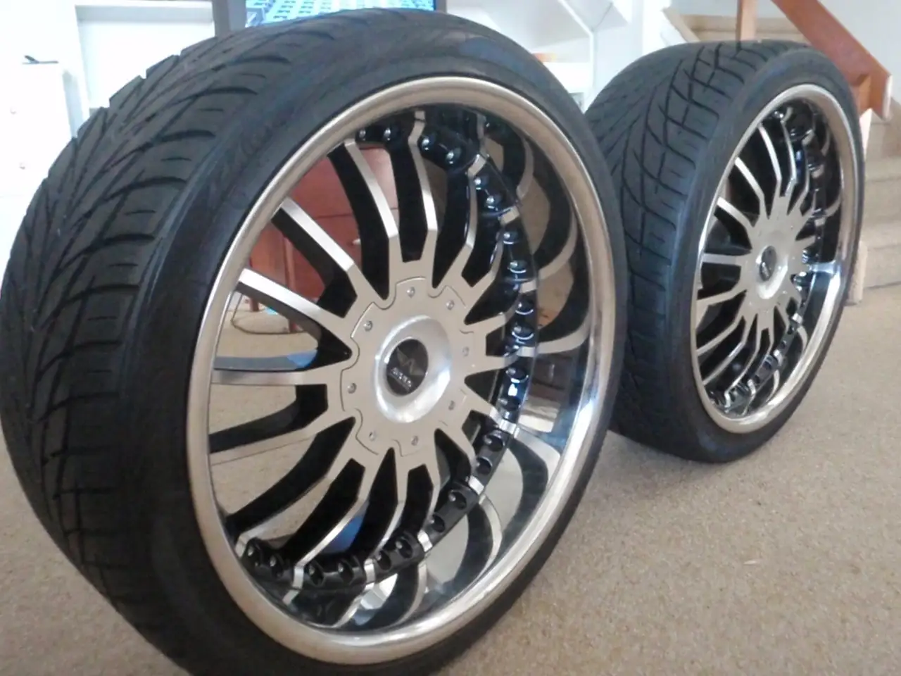

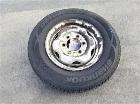

I'm curious do you think the tire size also helps in preventing cracked rims or bent damage.
My 235 70 R16 set up is a lot of cushion vs a 205 65 18 etc?
vs
No.
65% from 225 vs 70% from 235.
less than an inch is about right. Even that its enough more sidewall. Are you looking for more cushioned ride?
Its not only the sidewall but its also about the rubber and tire construction. But 235 70 16 should be a bit better for comfort. Unless using some cheap replica tires :)
