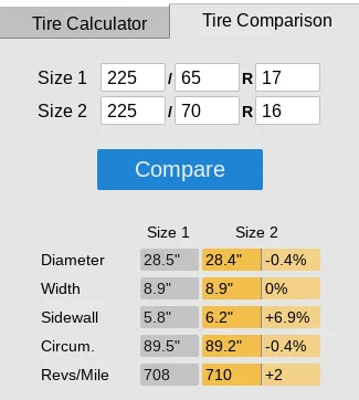

225/70/16 I think or even 235/70/16 if I get bigger rims

Thanks for the advice and sorry if I thought you were banned. The 16" tires would be cushier than 17"?

Just picked up four slightly used Tribute GT wheels and ordered four 225/60R16 Winters for my CX-5 pictures to follow when I get it together.
