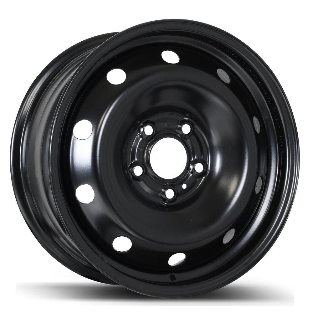

Hm - I found 5x114.3mm, 16x7.5 or 16x8 steel rims. The only problem is centre bore is a bit bigger than OEM. Isn't it supposed to be 67.1? I'm getting 70+
I also live where roads are in really bad shape Montreal Quebec...These wheels are probably multifit i.e universal and lug centric meaning the wheel will be centered by the lug nuts, not the hub. I've had similar wheels a while ago for a Kia Rondo and they would fit some Mazda, Kia/Hyundai and Mitsubishi models.

😲 I talked to the owner of the website, and he said I can use 5x114.3 16x6.5 rims for the 235/70/16. I will be doing so I think it's safe. I couldn't find any rims for 7.5" or 8" that don't impact my wheel offset a lot.

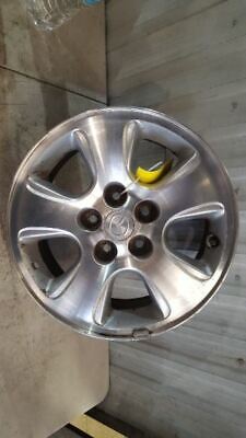

There are likely some Mazdas that come with 16" wheels you could use.

If you don't mind, what steel rims 16" can accommodate a 235/70/16 with no issues 😅
I want the basic steelies look no fancy design 🥺

I've found some: Fast Wheels Flair Gloss Black 16x7 +45 5x114.3mm 67.1mm
Not my fave look. But this looks like a good start? Will look for more but this is correct for 235/70/16 :) Also steel rims have problems with not accepting hub centre rings if lug centric?

I put 67.1 centre bore or larger and it's giving results like 72.6. So I would need hub centre rings to close the distance to 67.1?
I found these -fairly cheap but not in stock. The center bore is 66.1 - shy of the 67.1 I need.
And steel rims don't have any centering rings? This might be an option because I shelled out good money for the CX-5 and need to start saving ;)
Won't fit the hub. My experience has been that OEM is best for these types of wheels. Also offered on Mazda Tribute but you might have to locate them in a salvage yard.
Practically all Mazdas have almost the same wheel mounting but slight differences in the offset.
Wow so just 1mm difference 67.1 to 66.1 makes it not fit?
I love the Enkei wheels might get those. The damn thing is 72ish though 😞
I dislike OEM design too looks not as good as aftermarket. Can't I get hub rings to close the fit? Wheel shopping is so tedious 😭
