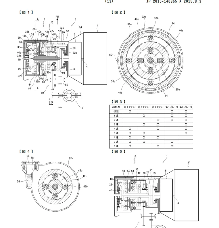

Mazda has an 8 speed FWD/AWD transmission that they keep updating the patents on throughout the years. Whether it will be produced or not is another story.
