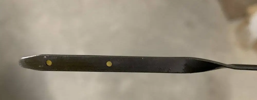

Yes, the dealer changed it a two months ago. I checked it right after it was changed and it was above the top hole. I have been checking it every 1000 miles or so. I do feel that it has gone down more from 4000-5000 miles than it did from 0-4000. I am going this afternoon to have the dealer do the oil change and will show them this pic and also the TSB. I have had my light come on twice as well so they are aware.

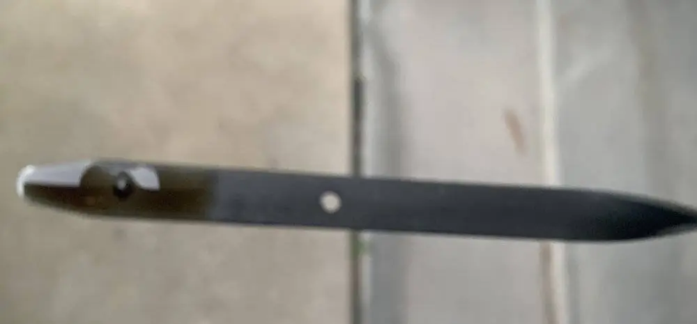

So, I am scheduled to get my oil changed today. The car has 5039 miles from the last oil change. At the start, the oil was slightly above the top hole. This is it this morning.
I just want to clarify the distance is not proportionate to the amount of oil you have. You'll probably need 1/4 quart to bring it up to top mark.
From bottom hole to top hole it is 1qt, so you are a half of a quart low
When my low oil warning light has come on, it was just slightly below this level. And when I added a quart of oil, it went to slightly above the top hole - to basically where it is right after a fresh oil change.
Currently, the low engine oil warning light it not on. But I think if I tried to go another 500 miles, I bet it would come on.
So, I took the car in and the service guy tried to say that that level was normal as the normal level comes right in the middle of the two dots. I did tell him that I looked at the oil level right after the last oil change and it was right above the second hole. This is what it looks like now after this oil change (it is thin so you can barely see the line right above the last dot).
