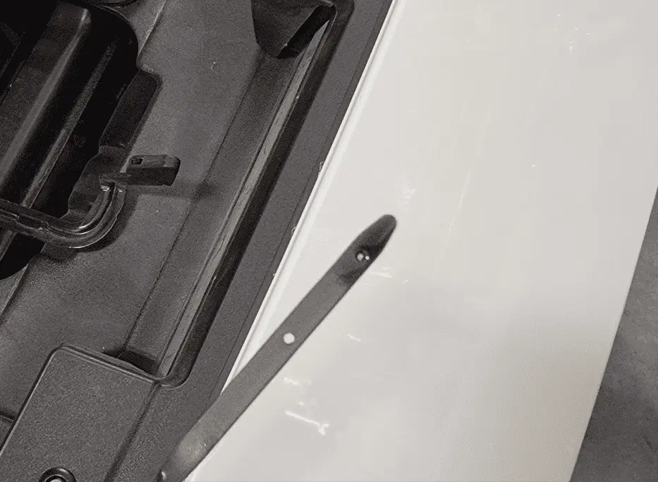

Yes the oil level was a tad above middle of the low/high indicators of the dipstick. It was the entire 5qt jug.
It looks like you lost a pint to me. 5 qts only puts it slightly over half.

Then the consumption may be only ~ 1q per 8,000 miles. I think you need to do a much better effort to measure how much oil you are consuming. Possibly us a graduated cylinder and add a small amount at a time to find out how much is needed to replace at a given mileage. Ed
Mazda CX-9 Grand Touring 2016
The engine is fine at the high oil mark on the dipstick and at the low oil mark on the stick. Fill it cold to the high mark, check the cold level frequently, note the miles it took from high to low, add back to the high line, note how much was added. Many quart oil bottles have graduations on the side to show how much remains in the bottle.
