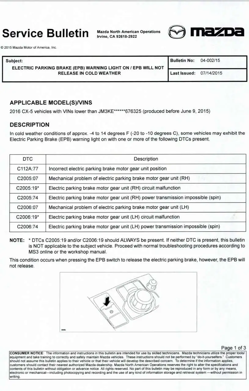

There’s a TSB for EPB rear disk brake caliper failure but that only applies to 2016 and part of 2016.5 CX-5’s. And the updated calipers had been introduced into production since then.

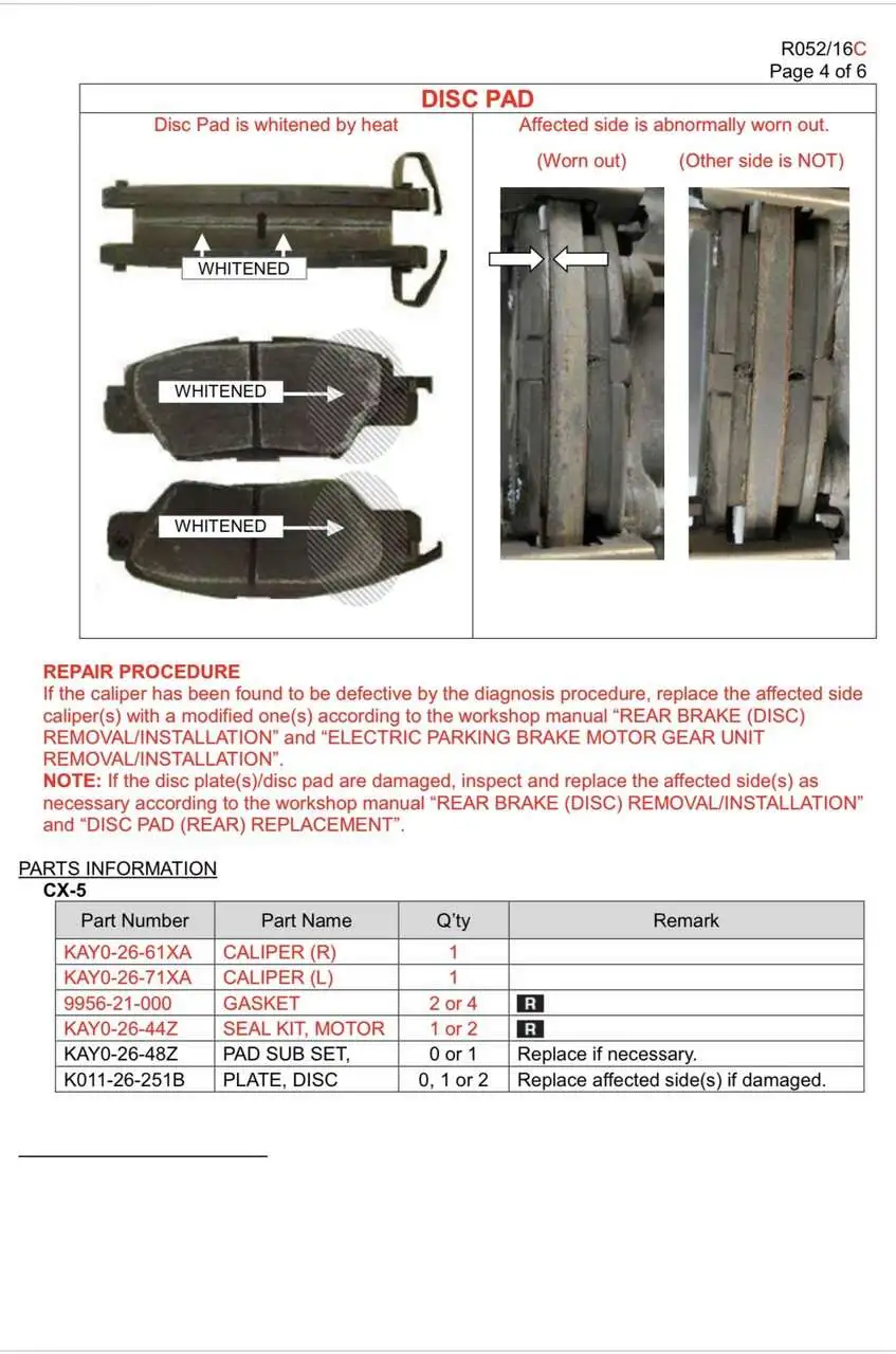

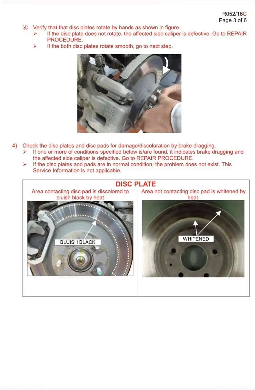

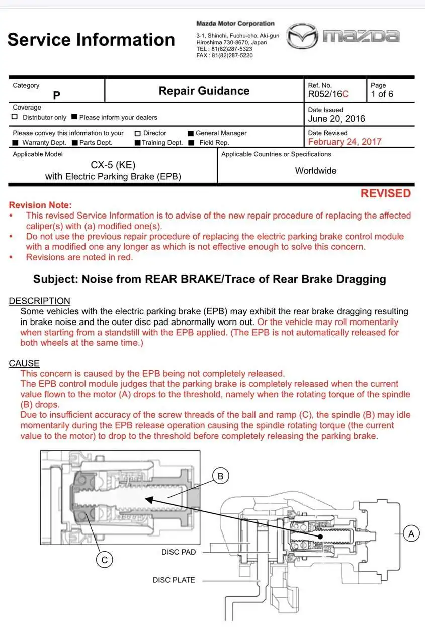

Here is a TSB related to DTC C112A and C2005 / C2006.
TSB 04-002/15: Elecrtric Parking Brake (EPB) Warning Light On / EPB Will Not Release in Cold Weather
And if you’re getting C2005 (RH), not C2006 (LH), only your RH EPB motor gear unit is failing. This TSB is calling to replace both motor gear unit and the disk caliper. But both of yours should be the updated version on your 2018 CX-5.
My guess is still somehow the water got into the motor gear unit on the right side, could be the previous brake job somehow didn’t put the motor back properly?
Again, if your 2018 CX-5 is an AWD, make sure to change at least the gear oil in rear differential ASAP as you‘ve driven through the deep water.
