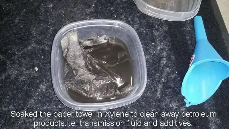

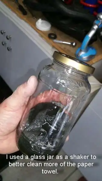

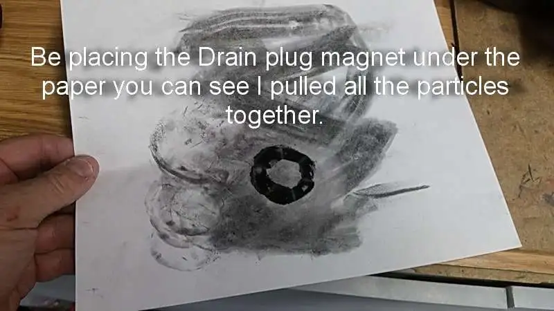

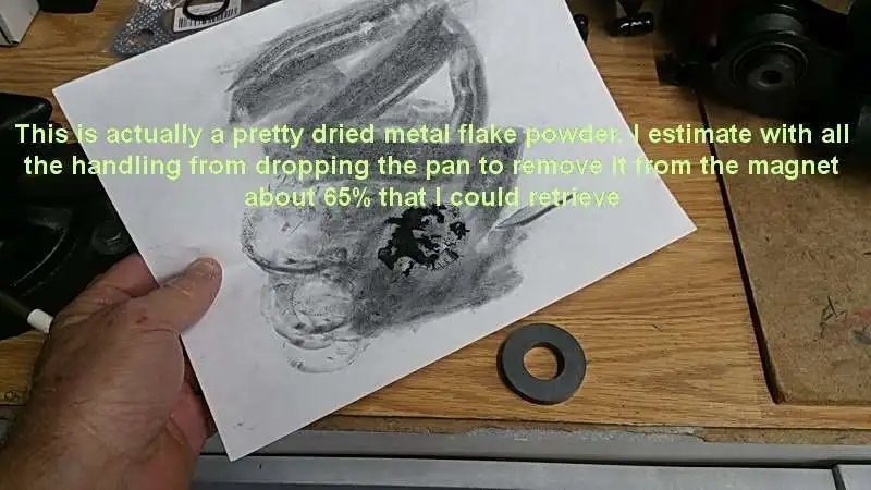

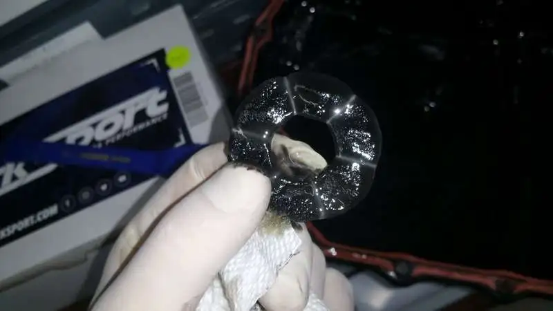

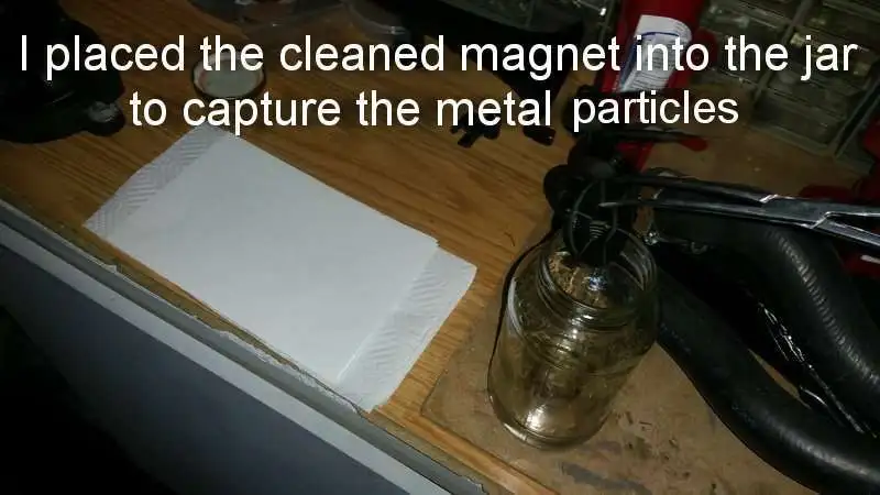

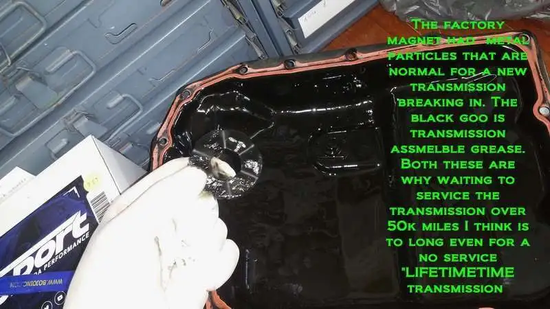

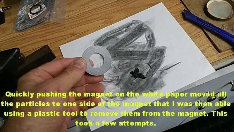

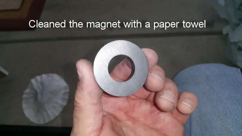

Here is a MAZDA pan and magnet showing all the great stuff that is in MAZDA "LIFETIME no service transmissions at about 30,000 miles that most don't realize is there. While most of this will not directly hard the transmission it does at as a catch all for other things that may. Things MAZDA does not tell you.
The actual filter was to the sys clean with nothing of concern. ;)
