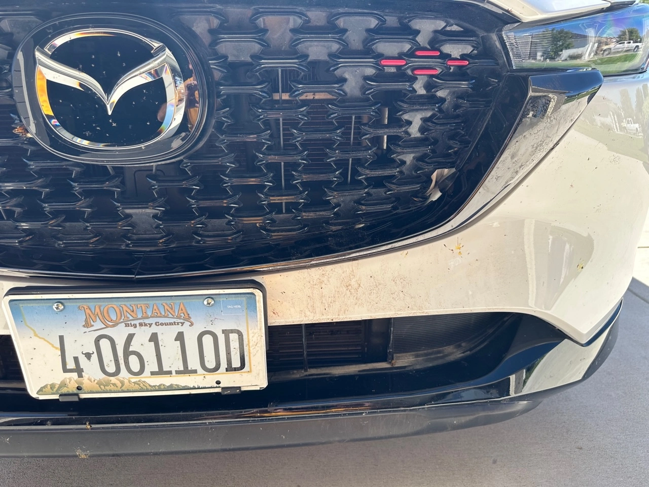

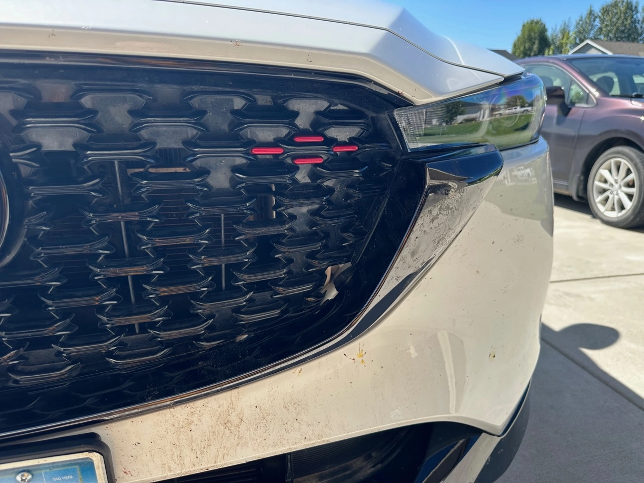

How to remove accent in grille?
I want to remove the accent so I can vinyl it but how do I access it to remove it? Any guides or instructions?
Totally not worth the effort if I remember correctly. If you can’t see the screws holding it to the grill from the backside (via the engine compartment), you have to remove the whole GD bumper from the front of the car.

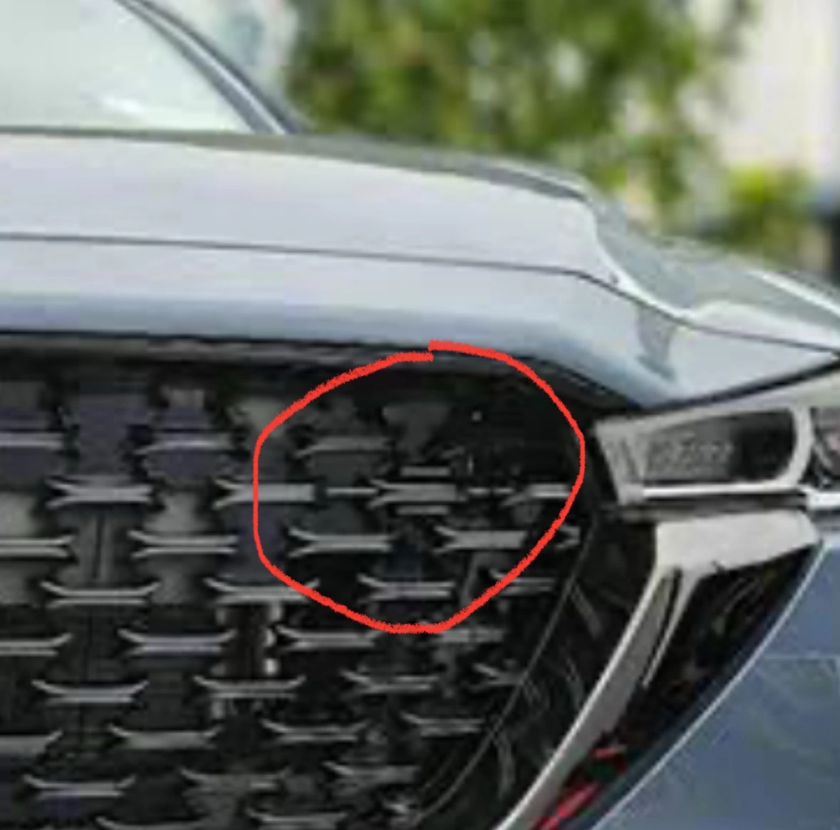

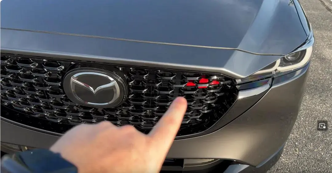

The Akera G35 is turbo but the piece is black. Haven’t check the other models but I wouldn’t be surprised if it’s the same with the rest of the line up for manufacturing purposes.
I can confirm my 23 Turbo is actually a black piece painted red from the factory.

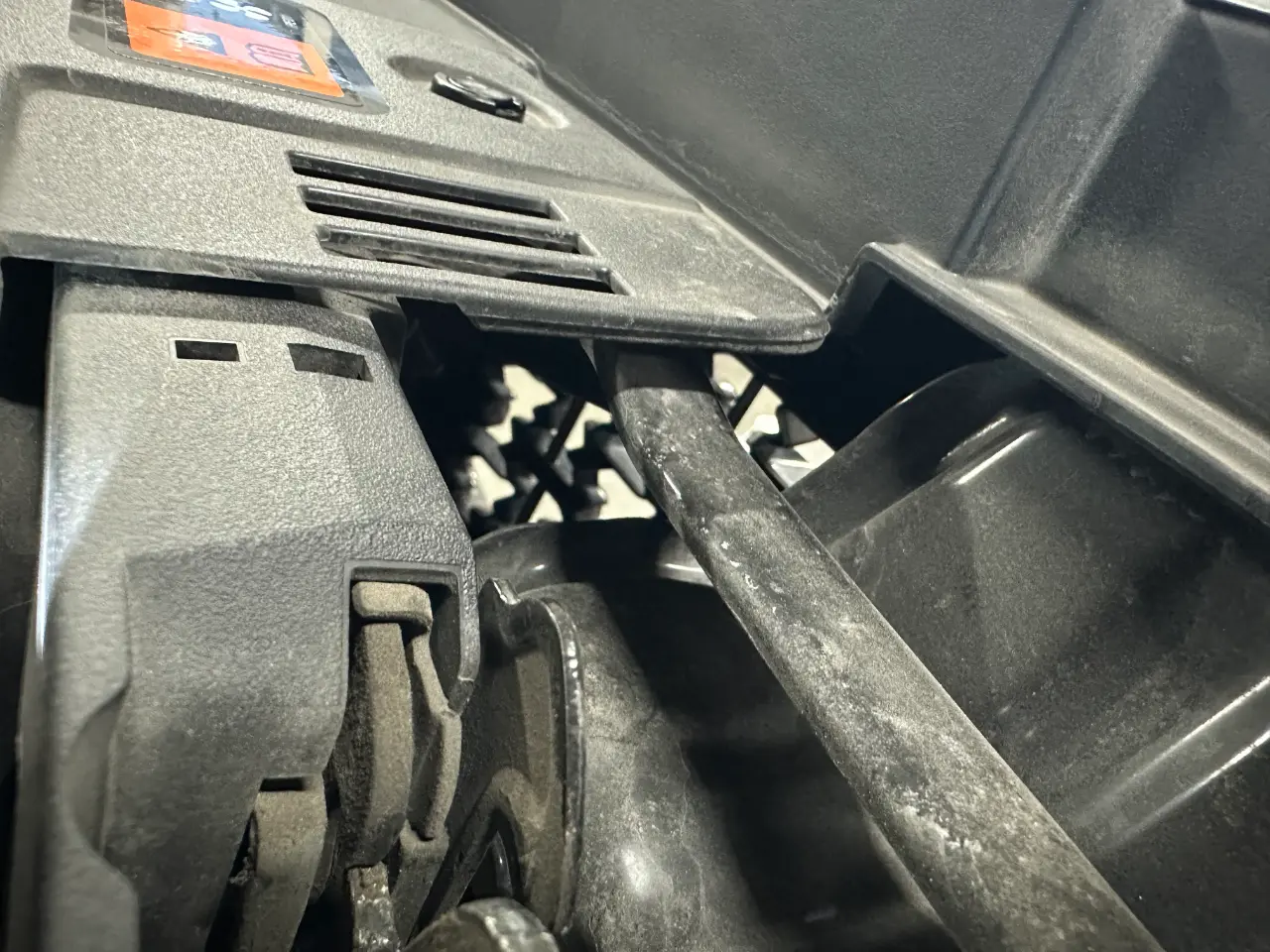

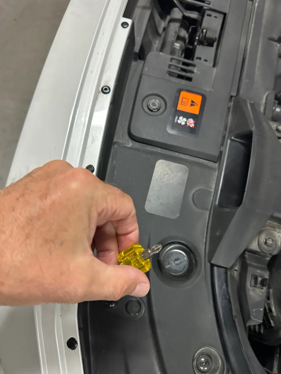

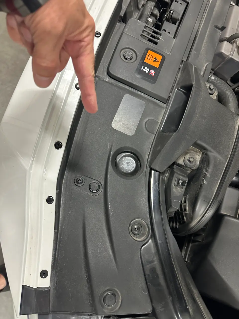

I think if you open the hood you can probably remove the inside trim and get to it..If you look behind the grill you can see the horn.. there are some push pins and rivets holding the trim just pop those and you should be able to get to the screws from the top..it almost looks like you could get to them from underneath as well if you remove the panel from underneath..I used a little mirror and could see the screws so I bet it would be fairly easy once you kind of see how it is held in place.

also if the M emblem pops off which I can't remember if it does or not there would be plenty of room to reach through the hole in the grill and remove it..I should have saved that piece when I hit the bear and destroyed my grill..

@jadmt @ruthrj do you have a photo that could help explain?

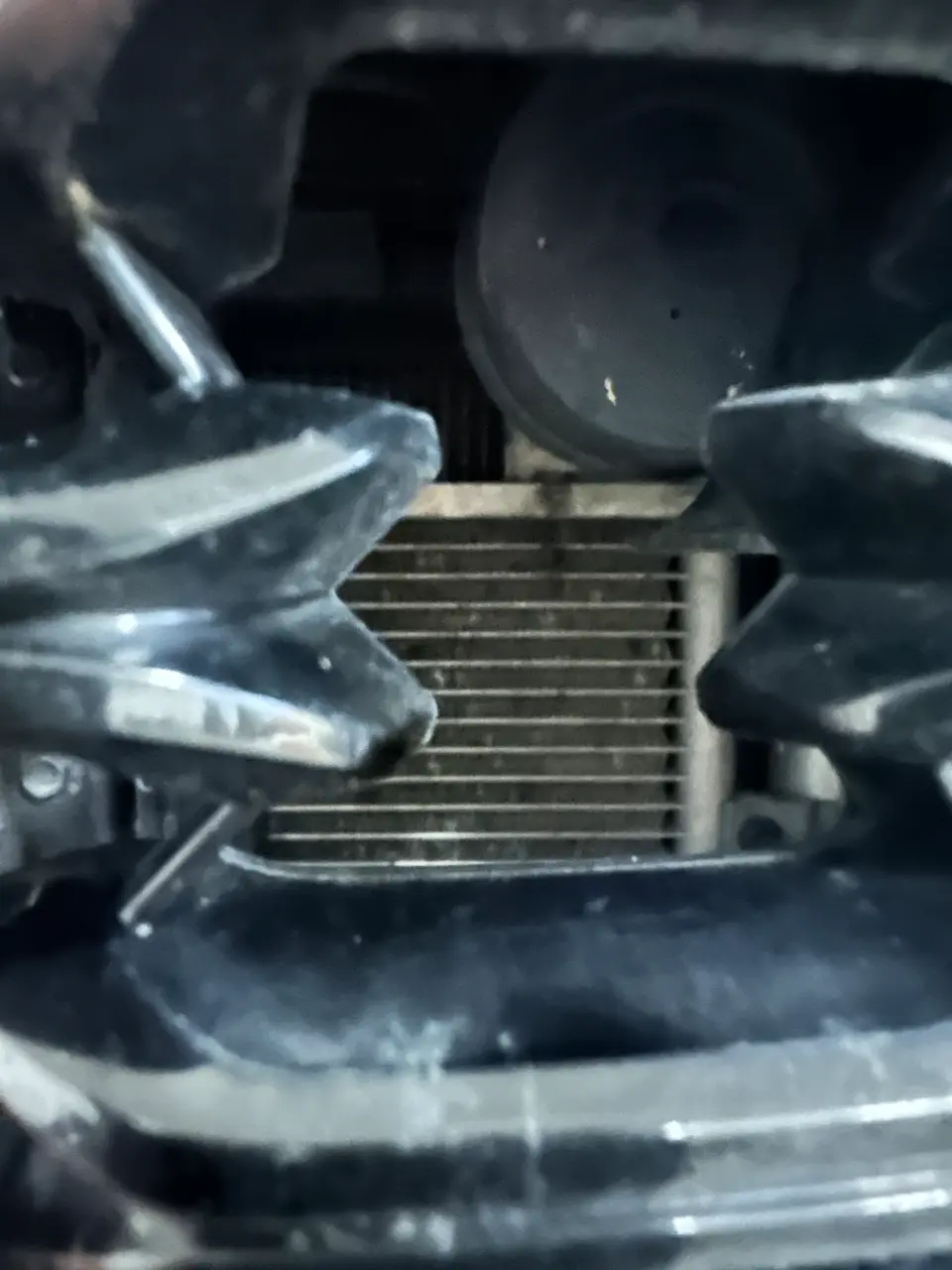

I took a look in my engine bay this morning, but I’m still skeptical. I don’t think all of the screws will be exposed. I think you can get one screw out but I think another screw is covered by another piece of trim attached to the car. That’s what makes me think the bumper still has to come off, but taking the plastic trim out of the engine bay is easy enough to confirm if this is true or not.
The emblem slides rearward out of the grill. Might be trim on the car blocking this rearward movement too (same stuff that I believe is blocking another screw).
