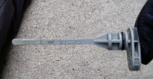

Mine was just shy of this lower mark at 122F
So another conformation that Mazda low-filled ATF from factory to our automatic transmission. The same on engine oil, engine coolant, and rear differential. I don't know what to say.
For those who use the quantity drained as the measurement to refill the ATF, you simply can't do that. You have to measure the ATF level at proper temperature with dipstick.
I'd guess you would need about 3.7 quarts to refill for proper ATF level at 122F similar to what ColoradoDriver had found.

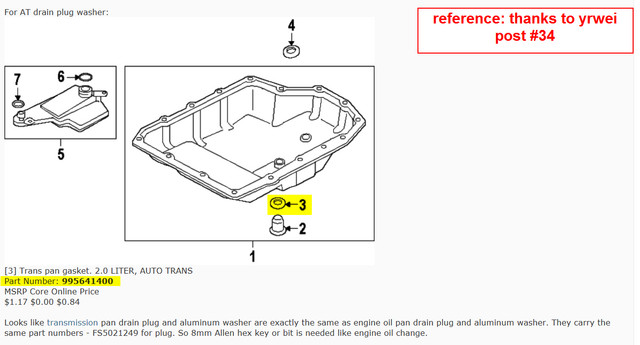

And only use a new aluminum drain plug washer during the 3rd ATF change.

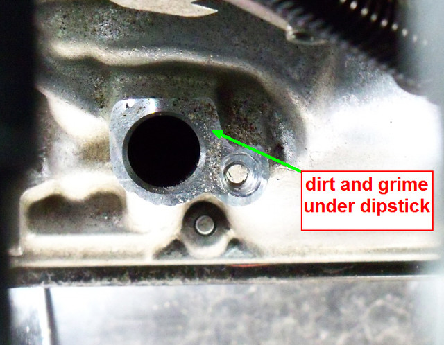

tomcat1446 had mentioned in the How-To thread that be careful of the dirt accumulated around the dipstick by bad design and they would easily to fall into ATF fill hole when you pull the dipstick. By accessing the dipstick from bottom, you can't really see and control the accumulated dirt.

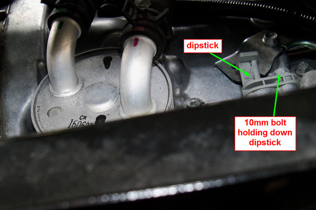

just FYI, I was able to check the transmission dipstick WITHOUT having to disassemble the air intake........
I can understand why some may want to, it makes it easier, but just giving another option that it's not necessary......

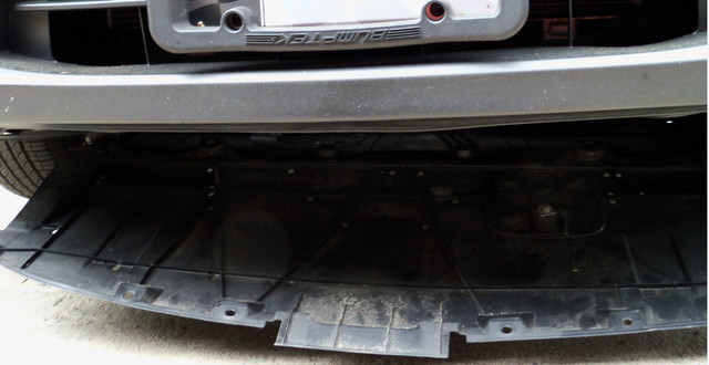

first need to drop the plastic panels, for the CX-5 you DO NOT NEED to lift up the front of the car,
there is more than enough clearance.

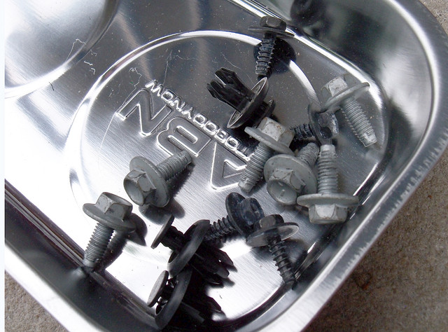

these are the type of screws to remove, some philips, some 10mm, and some 8mm panel fasteners...

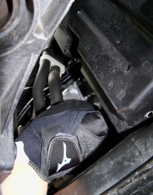

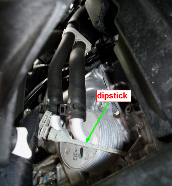

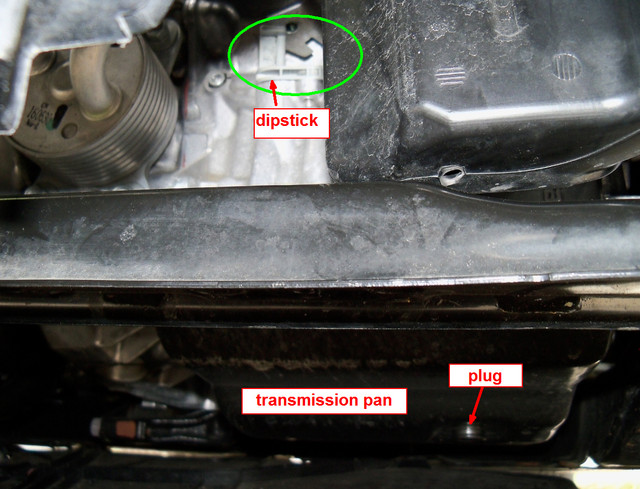

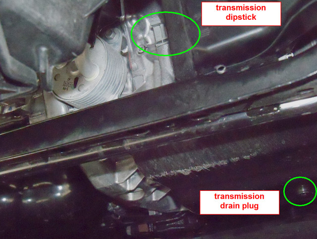

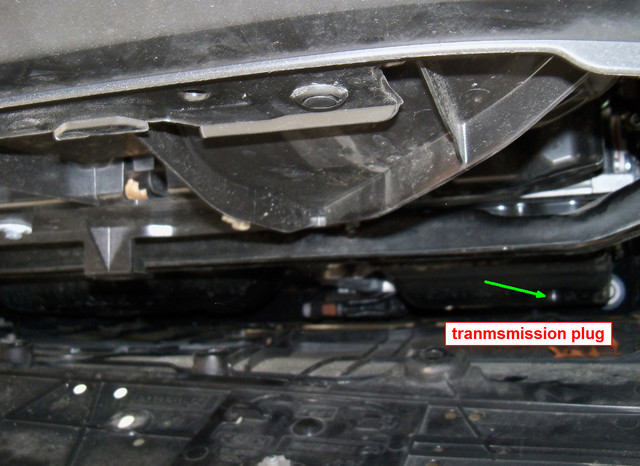

here is picture from underneath, you can easily access the dipstick and dipstick bolt:
it is reachable from underneath:
there's plenty of room to get a stubby ratchet with 10mm socket

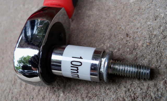

the bolt holding down the dipstick is 10mm size:
this picture shows the dipstick can easily be removed from underneath without having to disassemble the air intake
dipstick reading, hard to tell but looks ok to me, not low not high, just in the middle.... fluid is super clean though, I have 16,000 odometer miles

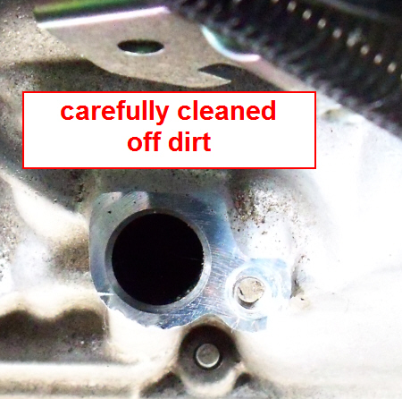

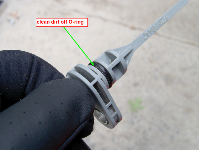

as others have mentioned, Mazda design allows dirt to accumulate as shown:
dirt can get under the dipstick, I cleaned it carefully making sure dirt doesn't go down the hole:
I ripped a small piece of my detailing clay bar and used clay slowly over the dirt and the clay grabbed most of the debris,
then like Gova used a damp cleaning wipe to clean the remaining residue, worked quite well, obviously, I threw out the clay,
no way I was going to use it again for detailing, the encased debris will cause scratches.
make sure to clean off dirt on O-ring before putting it back in:

safety glasses, stubby ratchet with 10mm socket

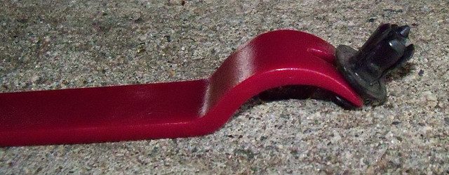

panel fastener tool remover:

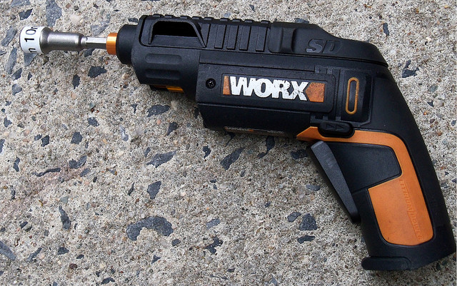

my trusty Worx for the underpanel 10mm scrwes, my wife thinks it looks like a gun :)

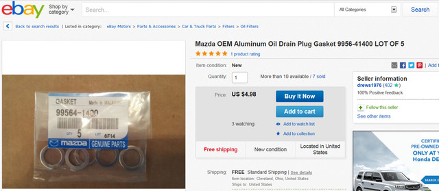

also just an FYI, if you plan to drain and fill, I recommend changing the aluminum washer, thanks to yrwei52, here's the part number, Mazda 99564-1400 (same washer for the engine oil plug)

- Removed bottom splash shields
- I checked dipstick from bottom
- I filled from the top with long reach funnel
- I didn't need to disconnect anything up top.
- Loosened fill plug from top but removed from bottom. One could as seen posts above remove from bottom as well.

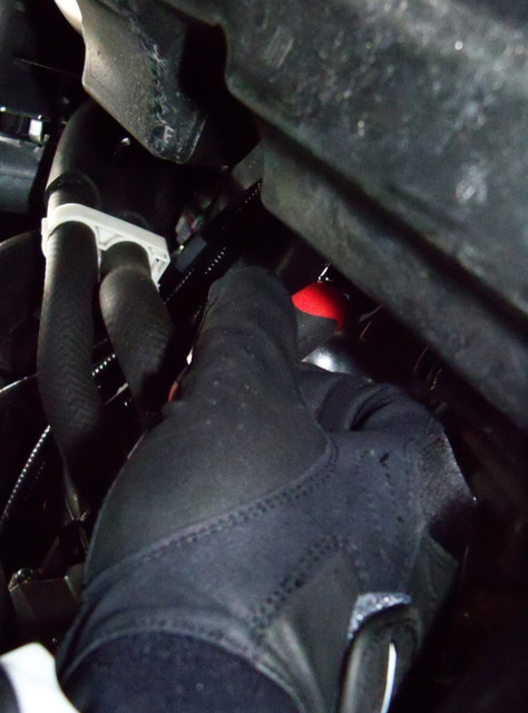

I suppose some might be able to get their arm down from top to pull dipstick. For an extra safety piece temporarily unplug the electrical connector on that driver side fan. I did that during mine for a just-in-case scenario.
