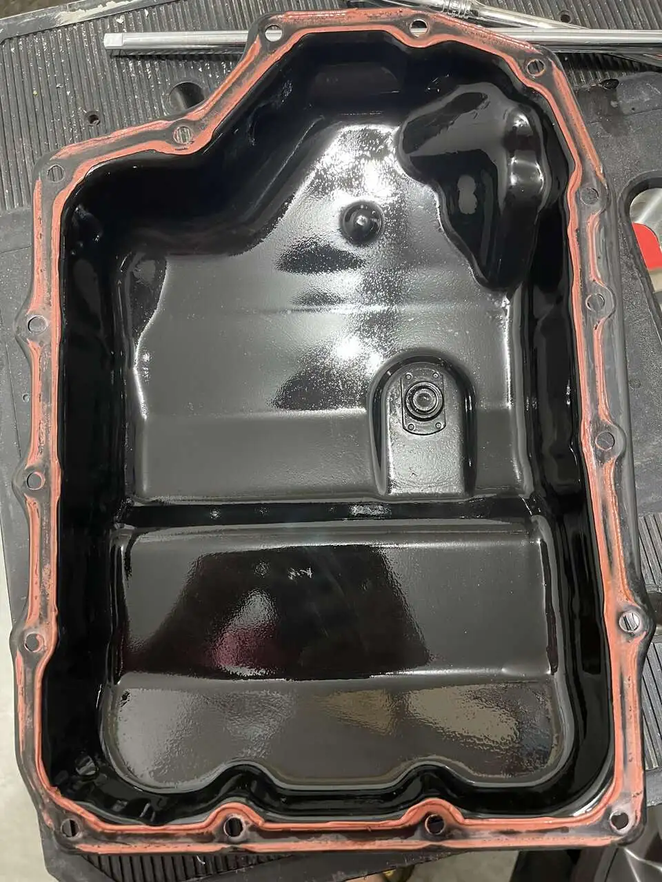

Did mine on my 19 CX5 GTR. Went pretty smoothly (knock on wood). The hardest part was applying the RTV and getting it into position. Everything else was pretty standard. It only took less than five minutes to get the transmission above 122 F per the OBD Fusion Mazda package. I don't need to drive the car again until Wednesday so I'm going to keep the skid plate off and monitor for leaks. This was my first time applying RTV. I felt more comfortable with the RTV vs. the gasket. Too many unknowns on the correct torque and the actual quality of gasket. I used the Mazda grey RTV and it dried very fast. I applied it, hand tightened the screws, waiting 10 minutes, tightened to about 45 inch/pounds and then fully tightened at 1 hr to 85 inch/pound to prevent all of it from squeezing out immediately. I let it sit overnight and then added the fluid.
I was afraid that I applied too much RTV as some squeezed out of the sides. I looked at the pictures I took before cleaning away the old stuff and it seems Mazda was pretty generous too. Cleaning off the RTV wasn't awful, I got some non marring plastic blades and it made short work. Less than an hour to clean both surfaces.
Drain and refill (with filter replacement) was exactly 5 quarts.
While I was down there I did the transfer case and differential fluid as well. After filling the first time I drove it and then refilled. Tbh this was a bit unneeded as I only got a few more pumps in. I don't think I'd make that effort again.
I did notice some rust on the frame where water got trapped between the skid plate and the frame. I plan on hitting those spots with rust inhibitor.
Picture below is the Mazda RTV application from the factory. As you can see they were pretty generous.
