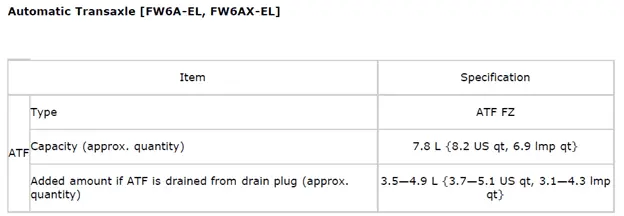

Thank you for the links! I went through a few of the threads you posted and I see that it is pretty much impossible to flush the transmission since there's no inlet/outlet lines leading from the transmission to the cooler but in my service manual there appear to be an oil cooler with an inlet/outlet that's mounted onto the transmission but it has nothing to do with the automatic transmission I think? I did some more reading and it appears that the drain and fill method only removes 30-40% of the fluid and I don't know how effective doing this 2-3 times would be and I rather do it correctly the first time so I was thinking of alternative ways to do a flush to get rid of 90-95% of the fluids.

Even if you let the CX-5 sit for several days, you still can only drain about 3.5 ~ 4.0 quarts of old ATF out based on member's reports here. There's no way you can drain the full ~8.2 quarts out. Those ATF staying inside of the torque converter, valve body, and some on the ATF pan due to the drain is not flush with the pan, can't never be drained out through the drain hole. With fluid exchanger, transmission has to be running letting the ATF pump to circulate out through the ATF line and into the exchanger, then feed the fresh ATF back into the transmission. Notice that this process still would mix fresh ATF with old ATF inside of the transmission during the circulation, in essence this is a bit similar to the process of doing drain-and-fill multiple times. Since each drain-and-fill should replace about a half of the ATF, doing it twice should make about 75% content of fresh fluid, doing it 3 times should make about 87.5% content of fresh fluid. Even if you do it once with 50% fresh Mazda ATF FZ fluid, it's still better than not to change it like Mazda recommended.
The video in post #2 showed he drained 4,200 cc / 4.438 quarts with pan drop and filter cartridge change. And the ATF pan cork gasket available from after-market has its drawbacks. It requires re-torque the pan bolts from time to time, or it's prone to leak. That's why most transmission now switched to RTV to form the ATF pan gasket, so as the engine oil pan.

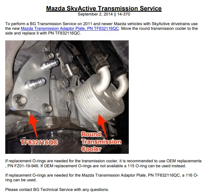

I saw this transmission adapter on another thread that was posted a while ago. Out of curiosity, how would this be any different from using the "Round Transmission Cooler" which Mazda refers to it as the "Oil Cooler" aside from the fact that it is considered an adapter and it's machine serviceable? It seems to go into the exact same mounting ports. Not sure if anyone has purchased and used this either...
The ATF cooler adapter plate you saw has 2 ports. But don’t get confused with these 2 ports on ATF cooler. These 2 ports on adapter plate is the ATF outlet and inlet ports instead engine coolant ports found on ATF cooler. The ATF pump does feed ATF into the ATF cooler from inside of transmission to cool down the circulating fluid by engine coolant. The adapter plate provides ATF ports which are not available on ATF cooler to let fluid exchanger hooking up and exchanging the ATF. While doing that, you just let ATF cooler hang to the side by the engine coolant lines with transmission running.
