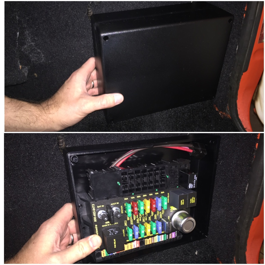

Tail light module for a trailer will serve as relay for brakes and turn signals. Easy to replace if it fails because I added quick release terminals. This particular model has a separate 12v power supply so I won't have high current running through steering column switch.
Additional bank of relays for low/high wipers and low/high headlights. This along with the trailer module should tuck up under the gauge cluster out of sight.
Took me a while to translate the OEM wiper relay box into a dual SPDT format I could understand.
The OEM harness had full power for headlights going through the steering column so I'm going to intercept those feeds and power the lights from a higher gauge cable.

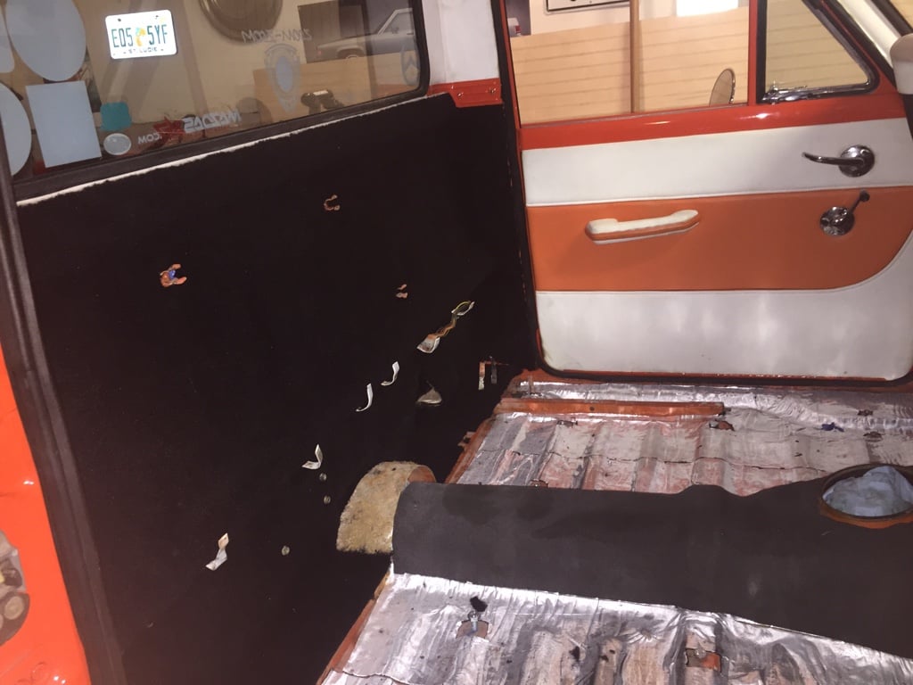

I also added some RAAMatt BXT to the transmission hump and rear of the cab. I ordered the wrong carpet so finishing it off didn't happen.
More carpet came in today so I took a break from wiring to trim and install the rear cab carpeting. Lots of cutting and gluing. I hope the Super77 holds it in place.
I'm going to probably drill some holes for heat dissipation.

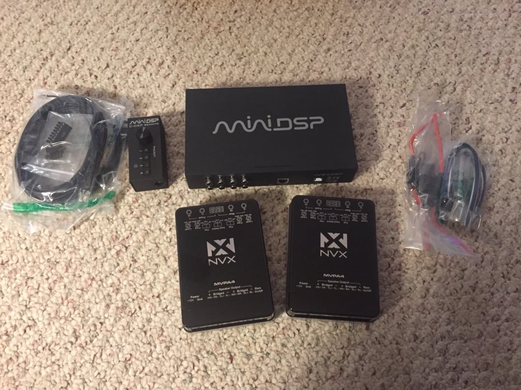

Mini audio equipment for a mini truck. 8 channel digital signal processor and 8 channels of class-D 50 watt power.

Your radio probably has more power than the engine.
(mad)

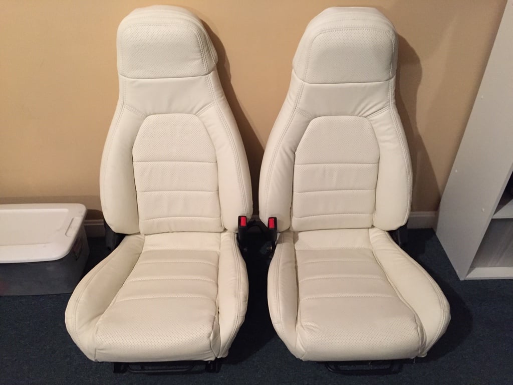

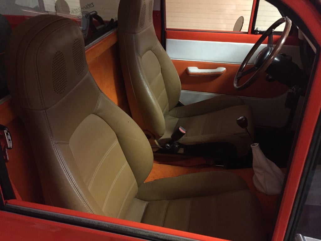

Spent some time on the seats this rainy afternoon. First shot is the old leather, second is the new Katzkin Leather kit.
I know I know. I've been gone every weekend in July. I need to get cracking on the rest of the wiring harness installation and get the dash back together and seats mounted. I would have had the seats in already but I have to drop the pre-silencer and heat shields to bolt them up.
