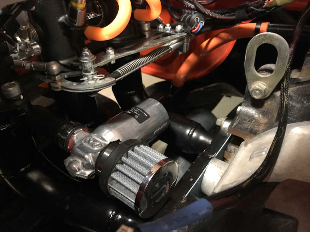

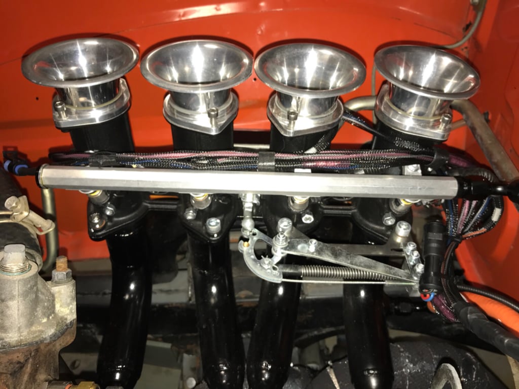

While I wait for the IACV to arrive I ran the new wires for it and cleaned up the harness so I could tuck the wires tightly behind the fuel rail. They’ll be out of sight when I put the air filter back on.

So the 2-wire Ford style IACV is not going to work. What I have ascertained is that they require a significant amount of air volume and consistent vacuum to stay closed. In resting state, a spring keeps the valve open. Suction through the valve will somehow pull the plunger and seal the opening. Sending power to the solenoid will open it back up. Sending a frequency power signal can keep it partially open, assuming of course the motor is drawing enough air to pull against the plunger.
My engine just doesn’t draw enough air so the valve never closes. Looks like I’ll be returning this one as well and seeking out a 3-wire valve that can forcefully close itself electronically.

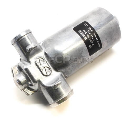

Played with the Ford style 2-wire valve a little more this afternoon and I simply cannot get it to close. I shut down all the other ports on the intake and closed the throttle as much as it would close and still it wasn’t enough vacuum to pull the valve’s plunger and cut off the air supply. So enough with that. I’m running another wire so I can use a BMW style 3-wire Bosch valve. It’s more expensive, but I don’t see another way to affectively meter air.

The FC BAC valve would serve the same purpose but it falls into that 2-wire category that may rely on vacuum to operate. If I had one lying around I would certainly try it but they are very expensive (unless you buy a questionable eBay used one). You’ll have to fab up an manifold adapter whereas the Bosch unit above can be connected with just hoses and won’t be dependent on vacuum to open and close.

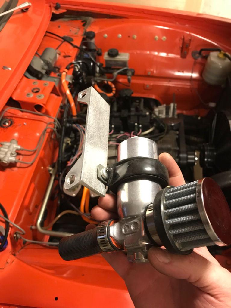

Guess I never posted the bracket.
Winter has arrived so progress has slowed. I’ve taken it out here and there and messed with the tuning software. The fuel map seems fine but the transient throttle is still touchy and I haven’t solved the stalling issue. Last time out I moved on to using the ignition PID controller for idle control and had a thought about a way to solve the off throttle stalling. I’m going to advance the timing on the ignition map so when I lift off the throttle it has some torque to hold a faster idle...and then I’ll get the idle control to drop the RPMs down further. Makes sense in my head, just not sure i can get the software to do it. This is sort of how my stock FB RX7 does it. First it opens a valve to let more air in under decel, but it also seems to hold the mechanical advance momentarily before it drops down into idle.
