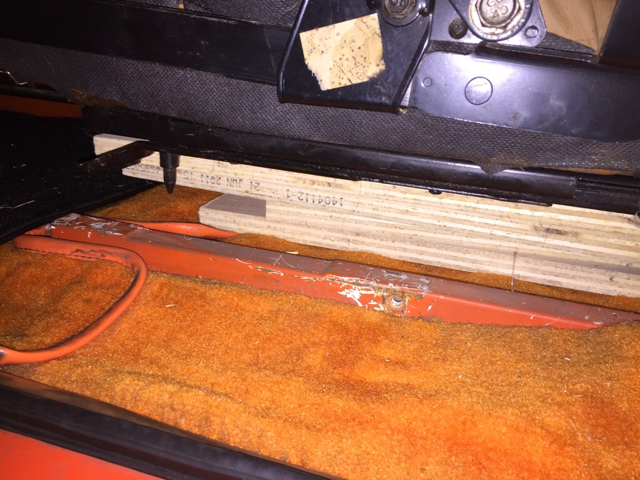

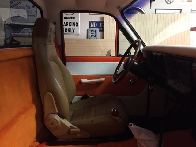

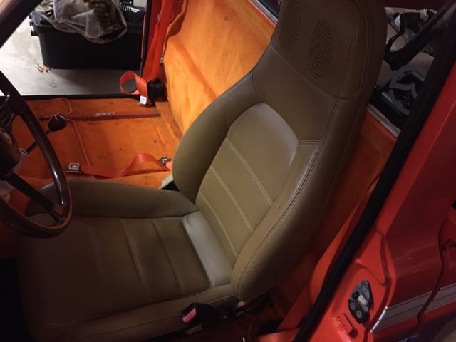

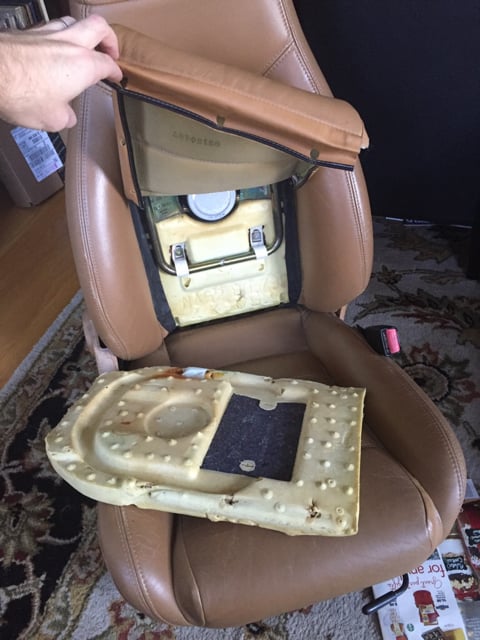

Did some test fitting to see what Miata seats will feel like. I need a bracket that will lift them up about 3". After placing them on some scrap wood the seating position was quite comfortable. Removing the lumbar padding gave me more leg room but I would have to put some of it back in so I don't have a thumper up against my spine. I don't plan to use these seat covers. I will order new ones from Katskin.
And before you ask...yes, I plan to hook up the thumpers and seat speakers. I have a JBL MS-8 in my CX9 right now and I will probably pick up another for the truck. 8 channels, crossover, time alignment, and eq in a small package that will fit behind the seat.
