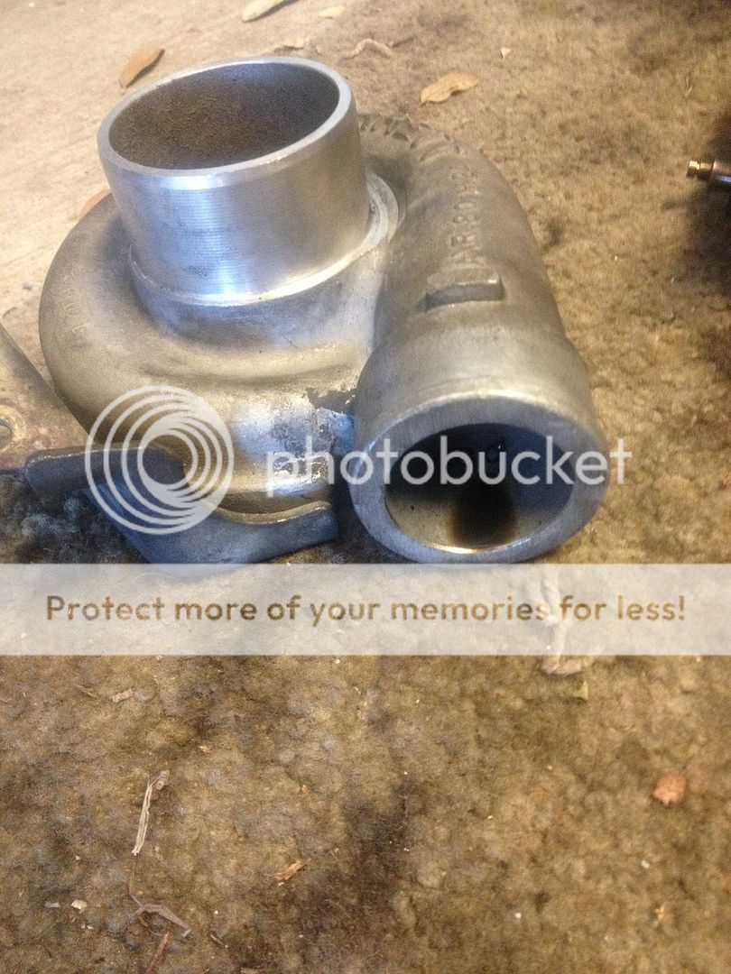

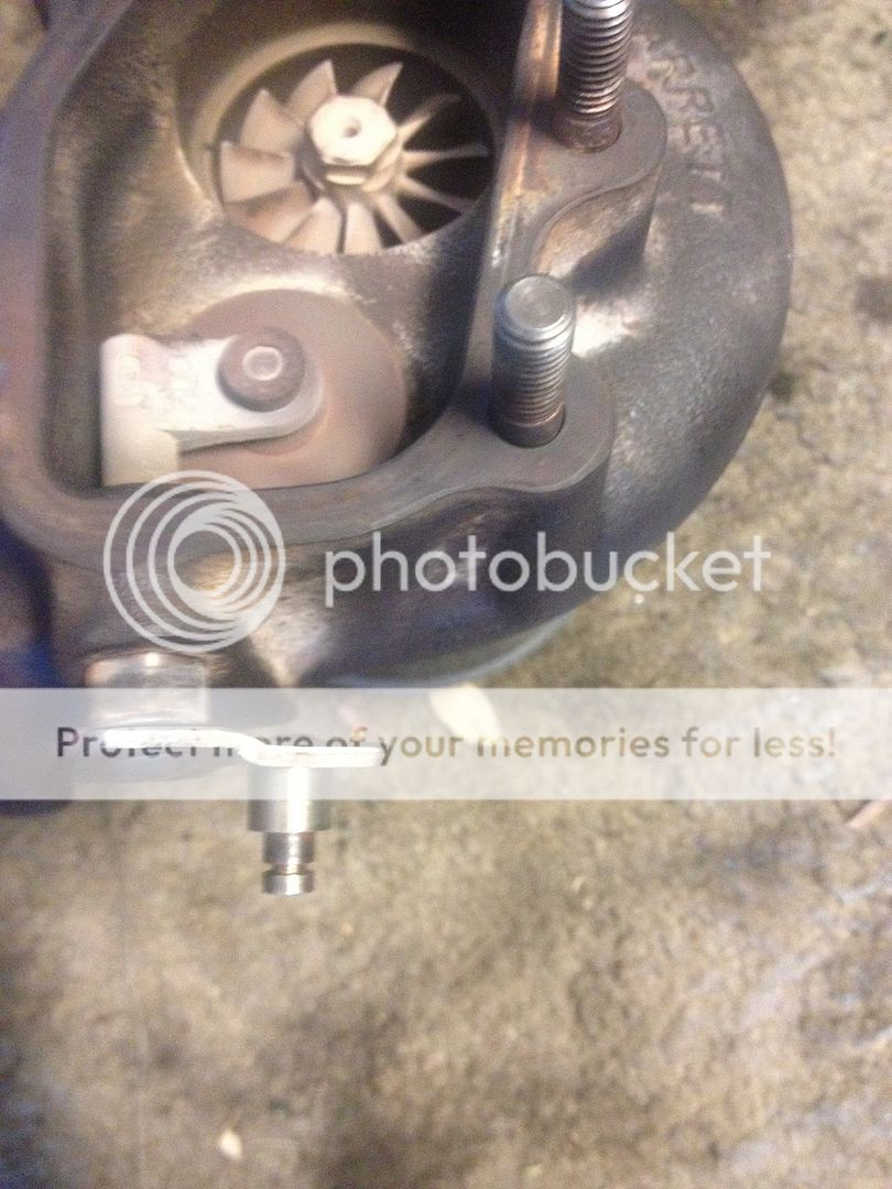

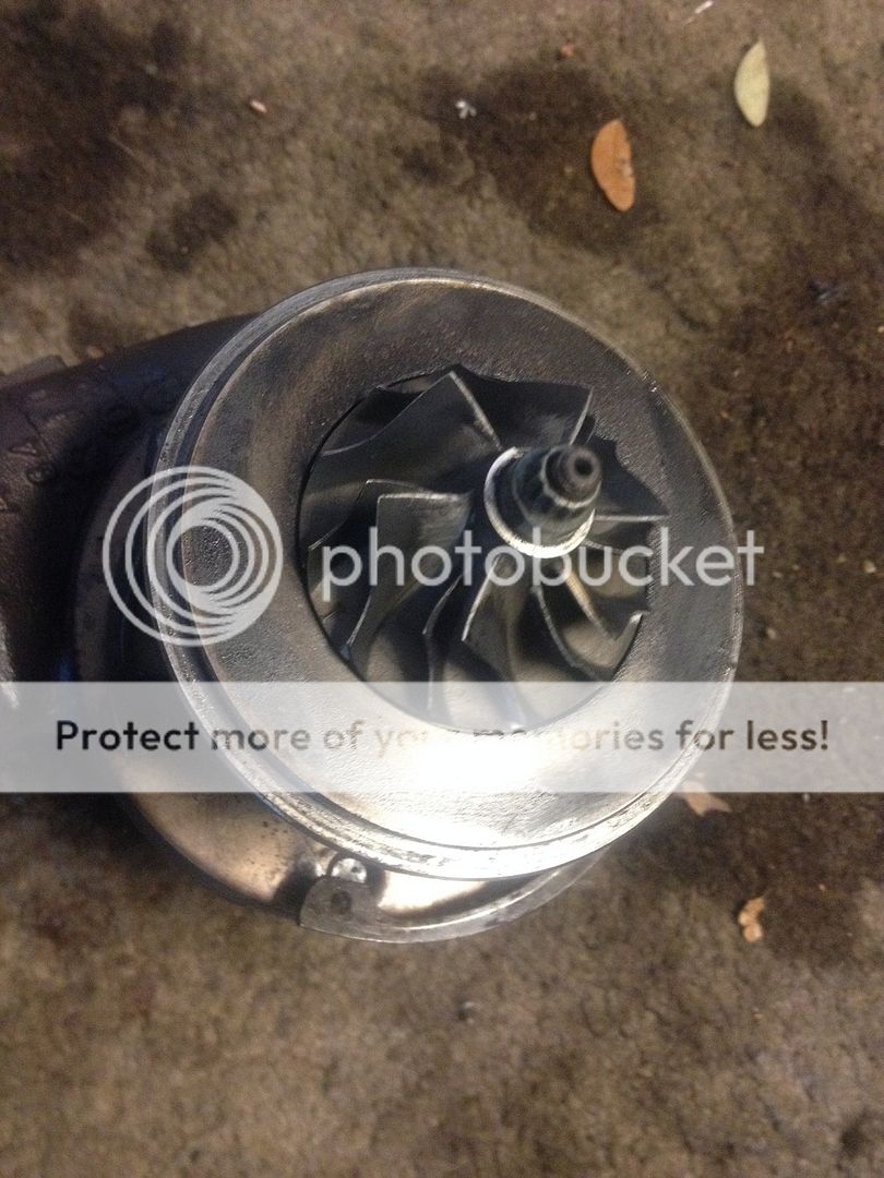

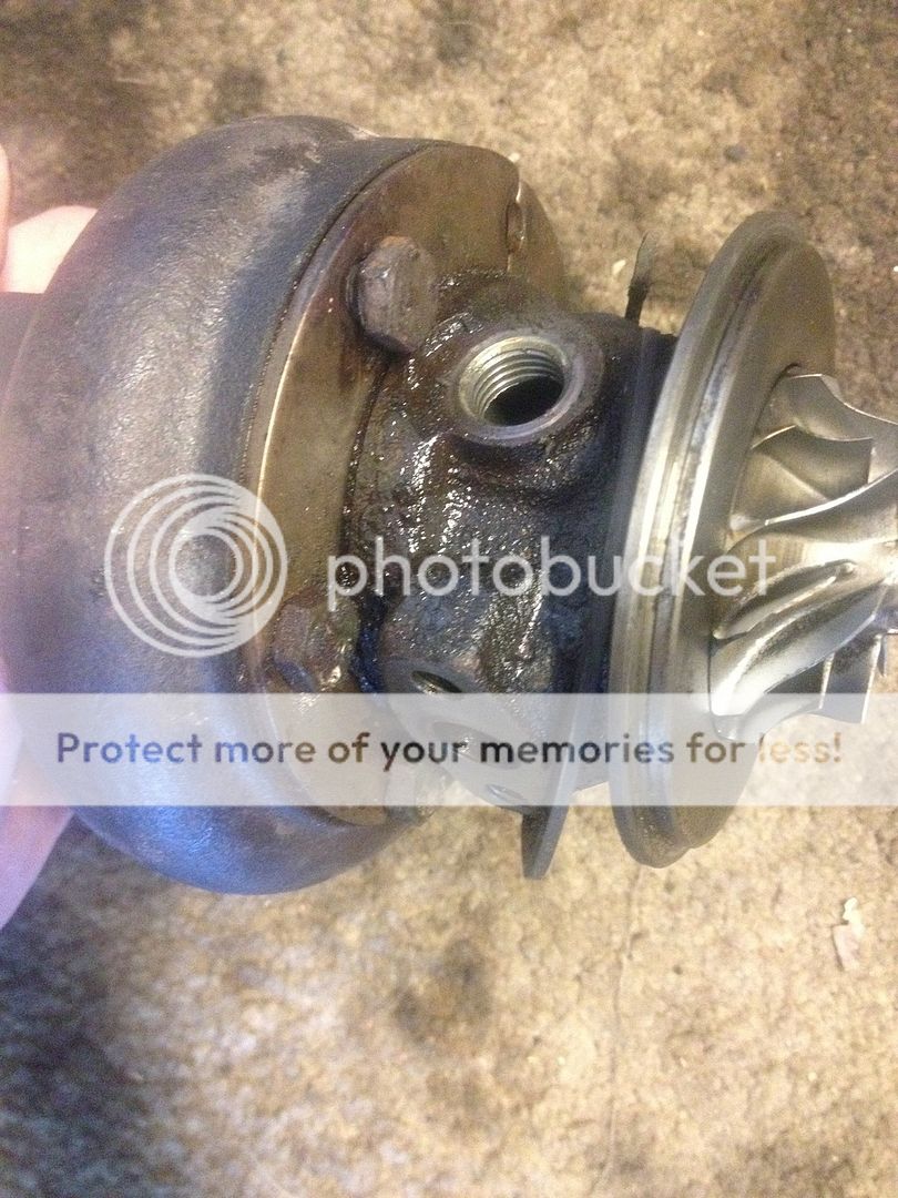

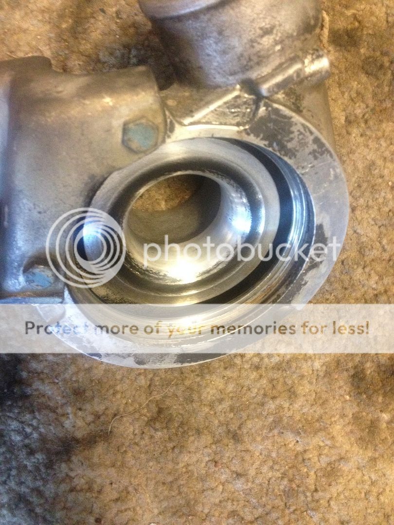

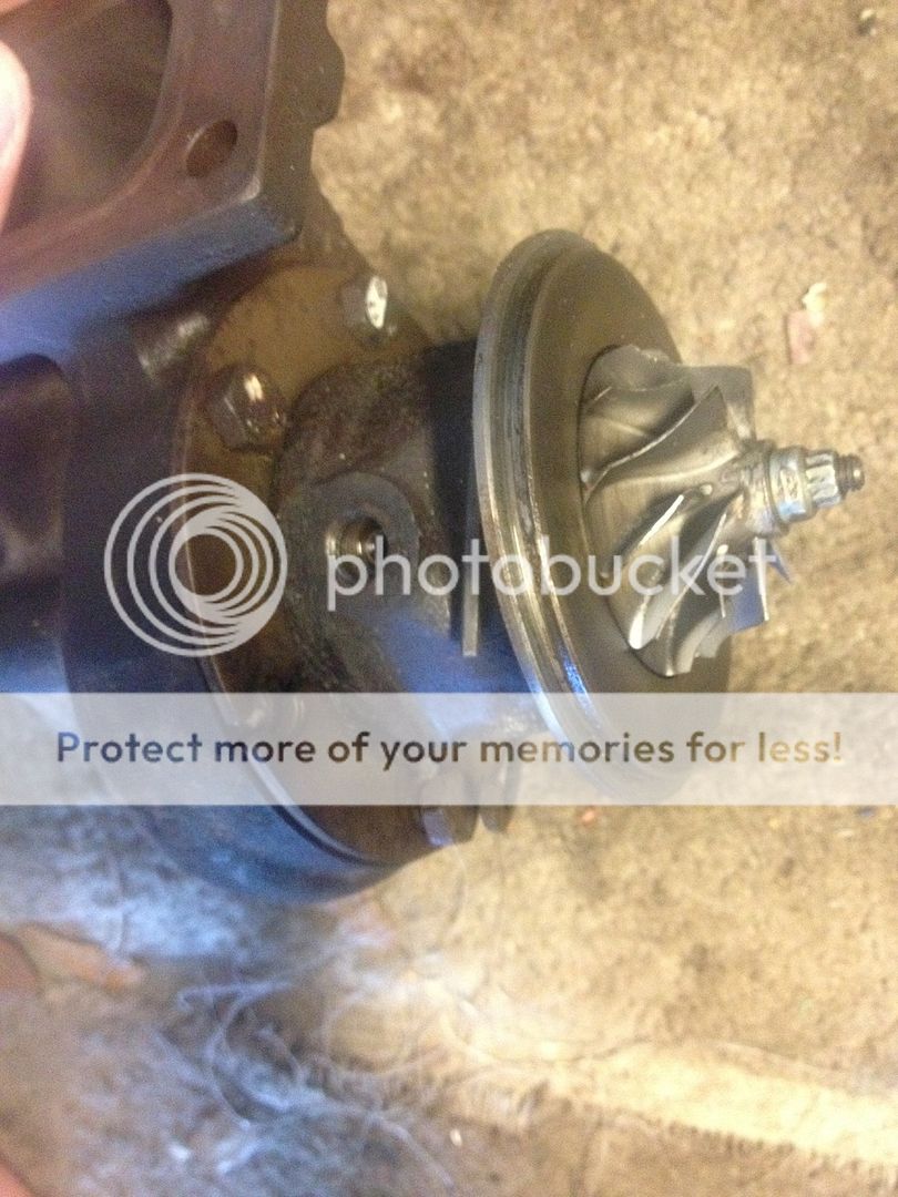

Here are some pics:
There is definitely some oil leaking from the compressor housing but there is some WD40 on it as well so not all of that is oil. Turbine side wasn't leaking as much if any.
And that one bolt broke, that won't cause a leak will it? I don't know how you could have removed that bolt it was rusty and seized in there.
Not much oil in the housing but a lot more than there should be.

Just hammered the WG flap back in on the turbo, popped right back in no problem and it doesn't scrape the housing.
So, the turbine looks ok from what I can tell, clean and dry. The white shows it was running well, no oil. The broken bolt wont cause a leak but can cause other issues, especially if others back out. If the center section comes loose wheels will rub the housings and BOOM. The broken bolt and what looks to be a loose bolt makes me a little nervous but if all the other bolts are good and tight, you SHOULD be ok…. (Disclaimer here)
Just what I expected, the front of the comp wheel is filthy!!! That was all coming in the air-filter or the crankcase breather line before it was removed. Bad maintenance. IF you took the compressor wheel off the shaft and look at the back of it, it would look like the scudge on the backing plate, but DON'T TAKE IT OFF. The compressor blade edges look cleaned off just like the wheel contour of the housing. DO YOU THINK THEY TOUCHED THE HOUSING?
My recommendation would be to get a rag and some brake clean or some other solvent on it and clean everything in the compressor end; blades, housing, backing plate and all. Then spray out the hot pipe with the same. You can also dismount the intercooler and see how much oil there seems to be in there. If lots, clean it out. Then once cleaned, put it all back together, run it for a few hundred miles (with a new air-filter) and then pull the hot pipe to see if there is a bunch of oil in there. If it's only a fine film you should be ok because that's normal on an older turbo.

The backed out bolt I had to loosen to remove the heatshield, it is tight now. There is no evidence of scraping on the housings, and the turbine does not have any excess play. Certainly not enough to scrape. I fixed the WG flap and reinstalled the turbo and it still won't even hit boost. It gets almost up to 0 on the boost gauge and then it tapers off and loses pressure. WGA holds air and has pressure holding the flap shut. Is it even possible for the turbo to be so bad that it won't even build boost? Somehow last week when I was messing with the WG flap on the outside of the housing the car started boosting and it hit 6psi so I know it isn't a massive boost leak. I was able to go into boost 3-4 times then I parked the car and it was back to not boosting again when I drove it again an hour later. And the vac reads steady 23in/hg at idle. I am stumped, don't understand how the turbo can't even build 1lb of boost pressure.
