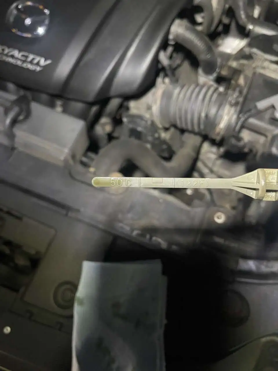

In mean time … got car in Nov, did first drain in December and second in January. I put in whatever I took out and based on car history (I’m not first owner) this service was never performed. Iirc I filled 3.3-3.5 quarts each time. Never got around to checking the levels using proper procedure.
Checked it yesterday… and sitting just above 50. Roh oh. Was trying to figure out the quantity between low bar and top bar just so I don’t overfill. Which lead me to this thread.

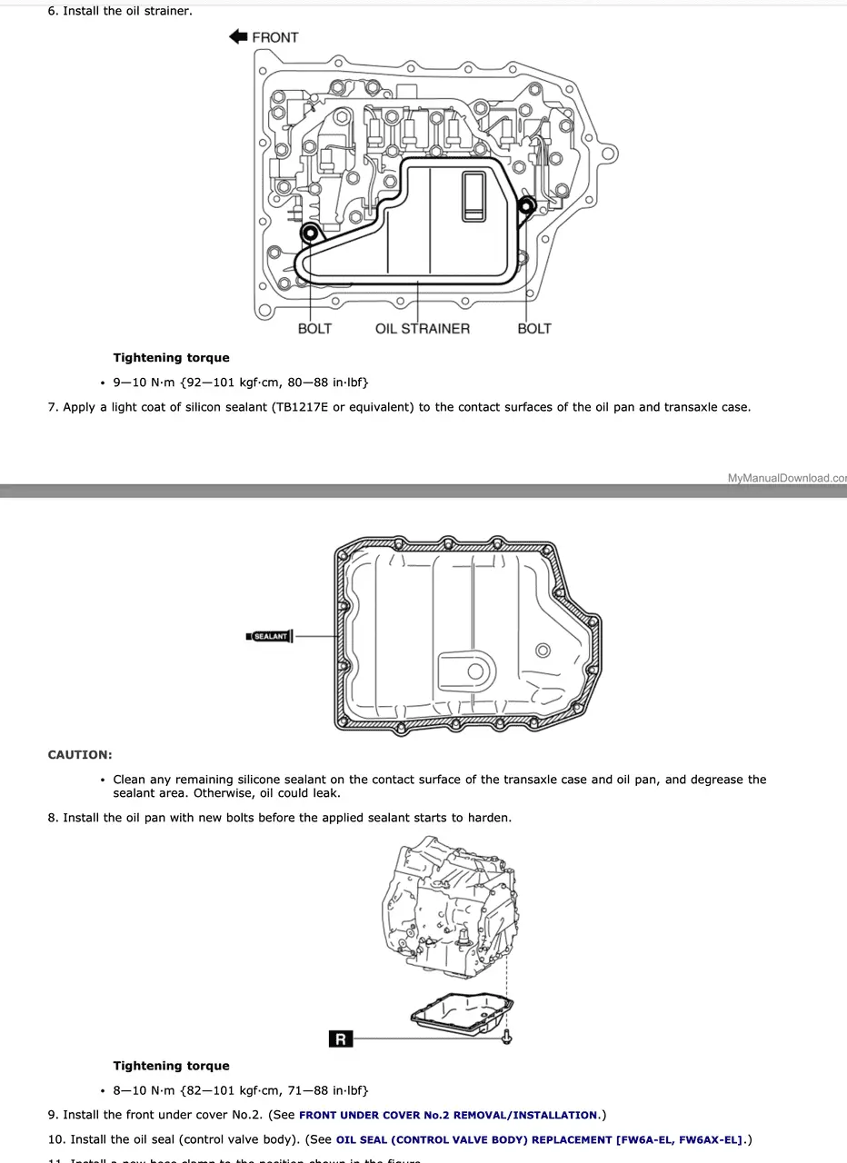

Now… what I haven’t seen is folks applying rtv to both the pan and the transmission as it says in manual. I’ve come across mostly rtv on pan or a gasket on pan. I can see myself applying rtv on pan no problem but the transmission might be a challenge with no lift, lying upside down, and in a poorly lit space. I could see this being messy for me. Anywho, just wanted to share.
Figured I’d share my readings at 150k miles with essentially factory fill.Now… what I haven’t seen is folks applying rtv to both the pan and the transmission as it says in manual. I’ve come across mostly rtv on pan or a gasket on pan. I can see myself applying rtv on pan no problem but the transmission might be a challenge with no lift, lying upside down, and in a poorly lit space. I could see this being messy for me. Anywho, just wanted to share.
You should never fill the ATF based on factory ATF amount you drained out as many have found the factory fill is low. Your dipstick showed the ATF is low on level as you only put in 3.3 ~ 3.5 quarts. 3.75 quarts is a common knowledge here on refill amount for a simply drain&fill.
Update: I warmed up the transmission fluid to 51C / 123F and re-checked level (car idling, level surface) and it was just below the Full line. MS Paint artwork attached.
Summary: added 600ml to factory fluid to bring it up to full level. I did not drain and fill since car has 30K km / 18K miles.
Yeh every DIYer applied the RTV only on one side, the ATF pan, with good result. Here’re a couple of more good threads on ATF change you can read:

I think it’s safer just applying RTV to the pan. I’d rather get the correct amount applied in a controlled manner instead of accidentally applying too much. I saw a cruddy video yesterday of a toasted engine. The cause? Too much RTV on the inside of the oil pan, a chunk broke off and clogged an oil passage and killed the engine. You should be fine with RTV on the pan only as long as the transmission side is nice and clean.
I used gaskets. But if you do decide to go with RTV, Hondabond HT is THE TRUTH. Get that stuff for sure. Absolutely the very best RTV on the market.
Some people here use Mazda silicone sealant TB1217C with good result.
⋯ I went with the OEM Mazda sealant, which looks and smells exactly like Permatex Ultra Grey RTV sealant. I followed the Permatex directions of going finger-tight on the bolts, waiting about an hour, then torquing them to final spec, and then waiting until the next day (18-24 hours) before starting the car.

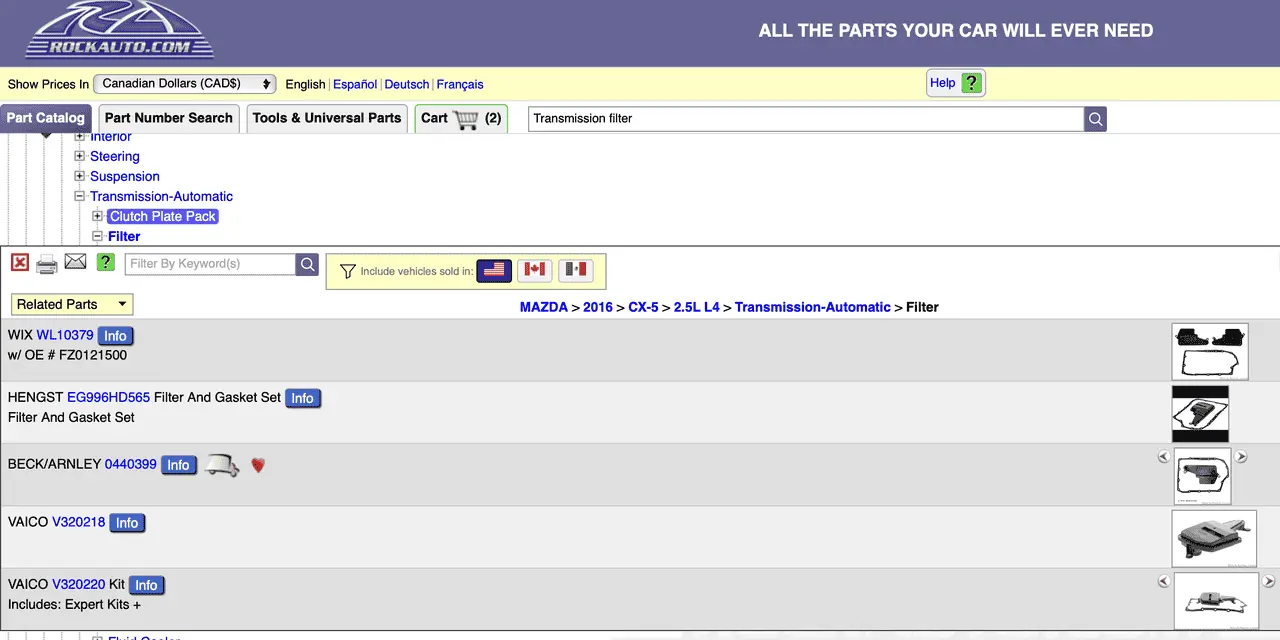

I think it was your comments about having good experience with WIX? filters that peaked my interest in considering them. I took a look at rock auto and the filters they offer all come with a gasket. Interesting.

If anyone thinking about using the aftermarket transmission filter with pan gasket, be aware that the gasket may not fit depending on your transmission pan. My guess is Mazda had changed the transmission pan shape when they added the cylinder deactivation for 2018 CX-5, where the transmission was also modified to add some components to fight the vibration by CD.

The WIX filter and gasket I got from Rockauto had a different variation of gasket (similar but 2 holes were about 3/4" off), so I ended up buying RTV from a local auto parts store, I was a bit pissed about that.
I use Wix filters, which includes a gasket. I use the gasket every time, and I've never had a leak.
Wix part number on the filter for my 2013 CX-5 with the 2.0 is WL10379.
Used that same filter today on my 2020 2.5L NA Touring.
Two holes on the gasket were about 3/4" off - couldn't use the gasket. That had me a bit pissed. Ended up using $15 tube Permatex from my local parts store - the price of the RTV was nearly as much as the filter and gasket, which had me more pissed.

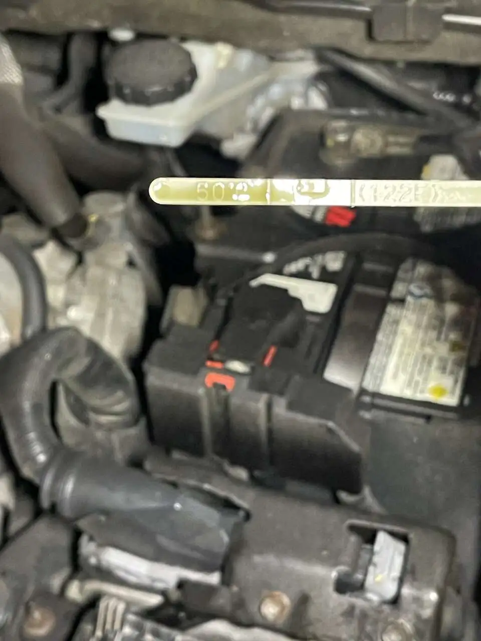

Added atf fluid today … took me 275 ml (~ 0.291 qt) to get to the middle of the rectangle mark from my earlier photo of fluid being at just past 50 mark.
So in case anyone is needing that information here you go.
Oh and 250 ml got me just below the rectangle.
Sorry photo is 💩 couldn’t get camera focus and lighting to cooperate. This is what I got.
Cheers
Ya I’m not sure why it was low tbh. I’m a new owner and I only have service records which show no transmission service. So seems it came this way 🤷‍♂️
