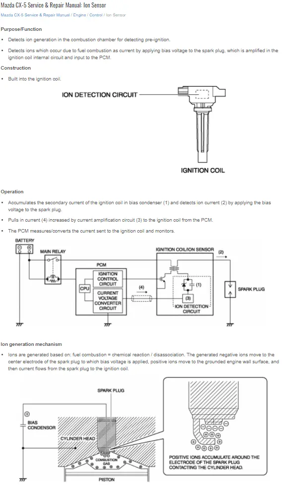

For spark plugs, I personally would prefer getting very expensive PE5R-18-110 OEM spark plugs. The spark plugs used on SkyActive-G have to be ion-sending compatible and the resistance of the plugs needs to be 3.0 ~ 7.5 KΩ.
As for whether or not you should use OEM spark plugs or aftermarket NGK Laser Iridium spark plug ILKAR7L11 / 94124、or Denso ZC20HPR11 plugs, it’s your call.

Sounds like most of the sensing function is built into the ignition coil. Presumably the key parameter that matters for the spark plug is the resistance. So if that is in spec for a replacement plug, maybe the function will be fine.

There have been several people who had replaced plugs that did not have the proper ion feedback and it created a lot of trouble codes so you can watch out for that. I remember a 2013 that replaced a lot of parts before he purchased oem plugs and the codes went away. I suggest you search for engine codes on this site and read other experiences...
Until I know that non oem plug meets the workshop manual resistance of 3.0*7.5 kilohms) I wouldn't use a non OEM plug. The ecu uses the spark plug as primary knock sensor. If the resistance is out of spec then you could end up losing power and or mpg. I've been meaning to buy a cheap plug from Vatozone and test the resistance.
What Chris_Top_Her has said does have his base. OVT (OrangeVirus Tuning) had posted following comments several years ago here.
Without getting into too much detail...you guys really...really..really want to use OEM plugs....
the reason is because the ECU uses the ignition coils, which measure a resistance across the OEM plug for pre-ignition, and extremely low levels of knock retard the knock sensor cannot pick up, along with that it gives the ECU individual cylinder information, the spark plugs are actually used "as a sensor."
How it works exactly is proprietary information that I am not willing to share, you want to use OEM plugs.

I'd pay the extra for OEM plugs that are more likely to have consistent resistance vs OEM aftermarket which have been proven to have wildly varying resistance, among the same exact plug.. since it functions as the primary knock I don't want unnecessary power reduction

So the spec sheet for NGK ILKAR7L11 calls for a resistance value 5k ohms. The OEM CX5 service manual for the OE spark plugs calls for a resistance value of between 3k and 7.5k ohms. So that means the NGK plugs should be right in the middle of the factory resistance range.
