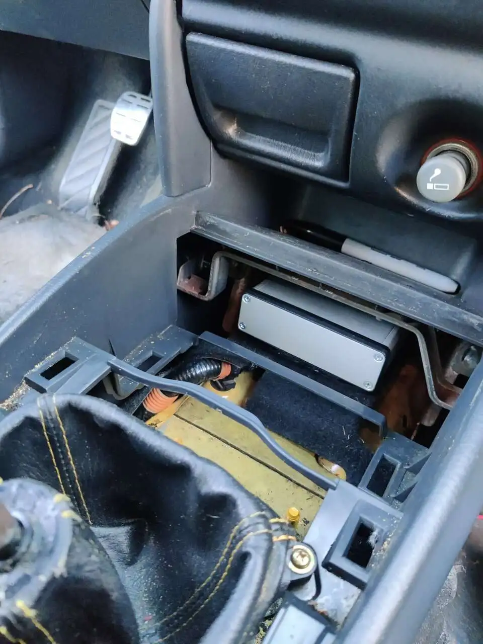

I'm going to build out this Thread with details on how to use a Speeduino to run the MSP, P5 or BJ Chassis with the FSDE in a piggyback Configuration. If you have ever successfully installed a SSAFC by soldering the wiring and not using those cheap vampire wire clips, then you can install a Speeduino. This is a great affordable unit for anyone who is capable of doing minor soldering and crimping of some wiring. The Speeduino will be have full control of Fuel and ignition, and the stock ecu will keep control of idle, AC, alternator charging etc. As of this weekend 3/16/24 I have successfully managed to get my MSP starting and idling with the Speeduino unit installed.

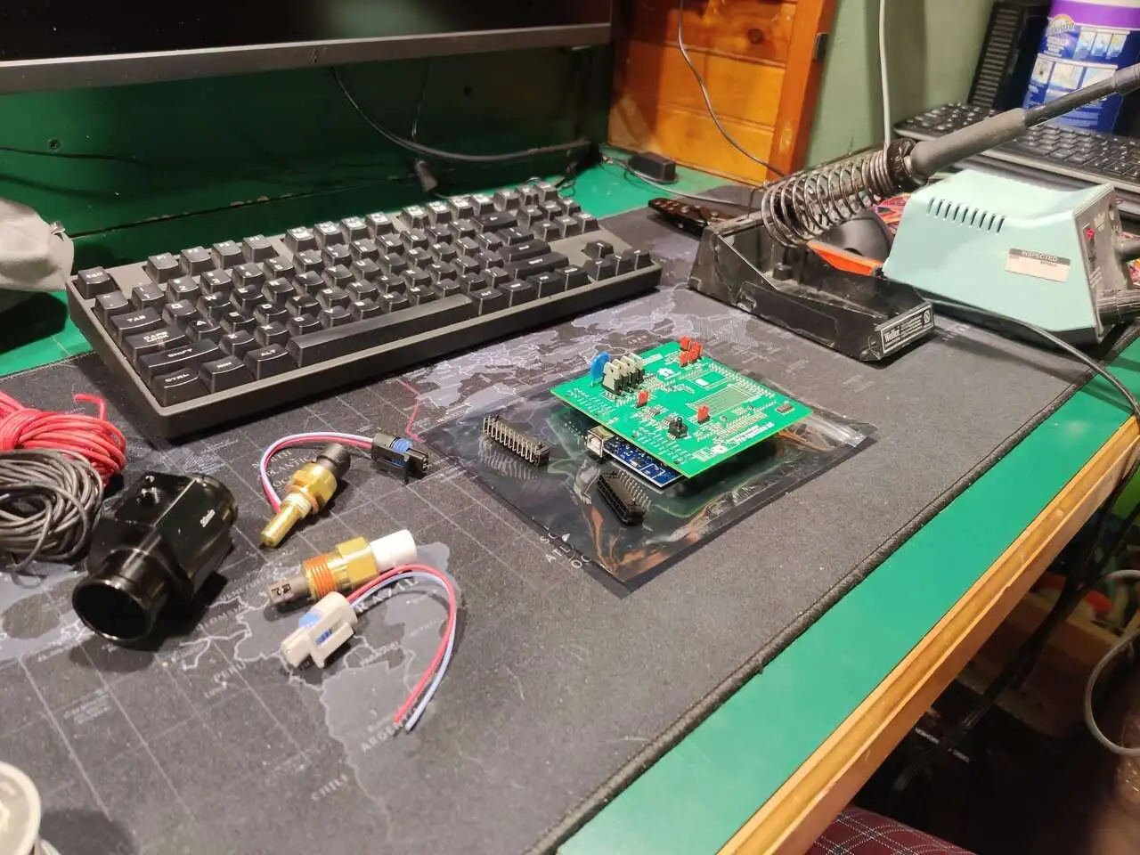

The Speeduino unit I installed was a unit from Openlogic EMS and can be purchased here:

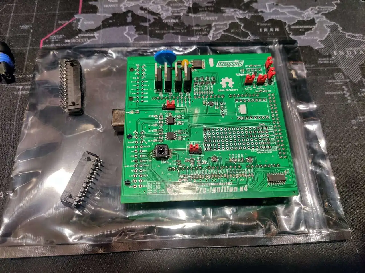

Because our cam and crank sensors are VR style you will also need a VR conditioner for the unit:

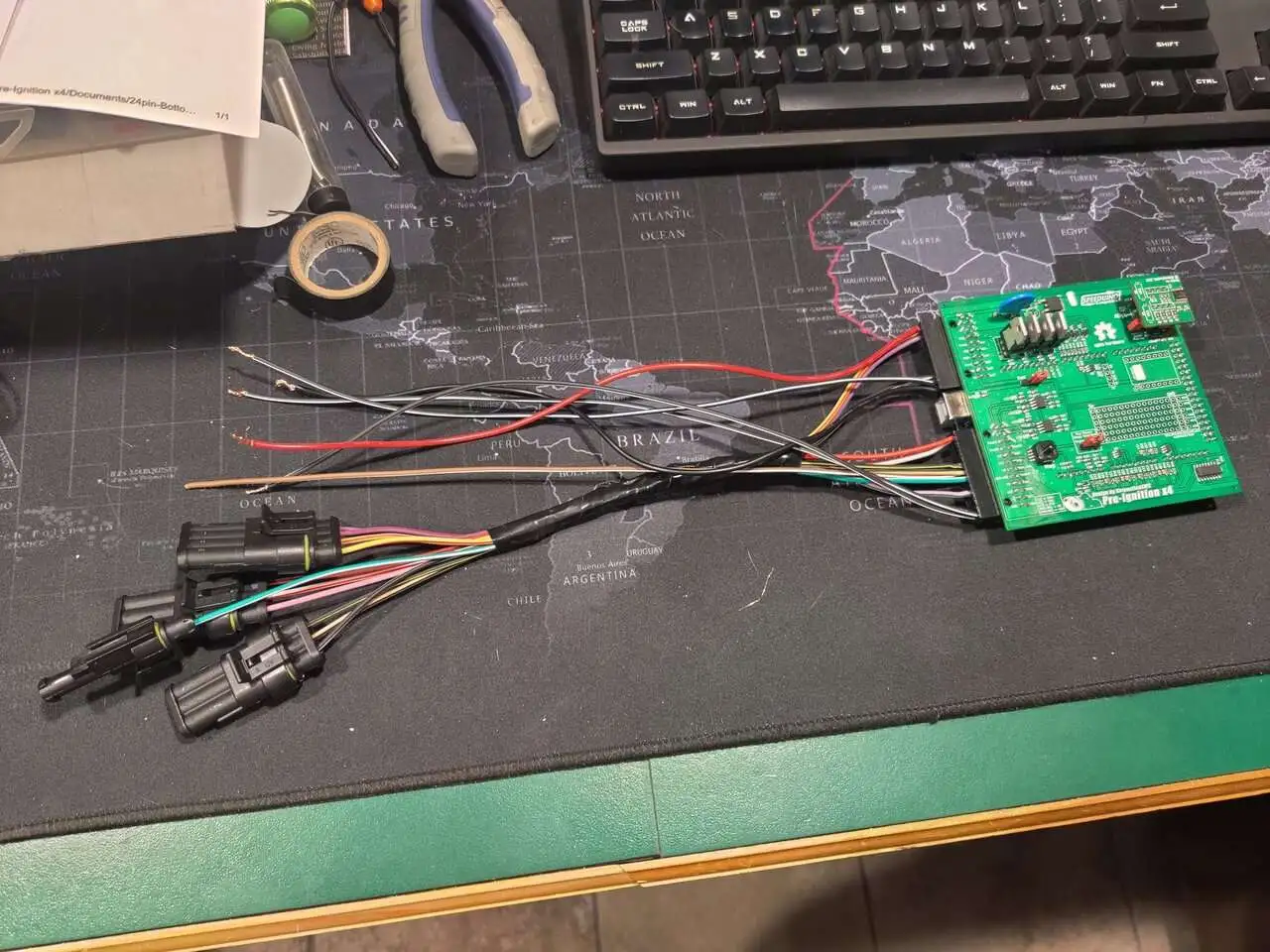

If you're not comfortable with some minor soldering of some through hole PCB components, you can get a ready to go unit that contains the VR conditioner and a 2ft pre-crimped harness for approx $300 here: Fishdog (UA4C Seawolf) Speeduino ECU.
The only thing you would need to do on this unit is set the jumpers for VR on the board and do some wiring into the factory ecu harness.
All of these differennt Speeduino options all run on the same code and have the same options, some just need some additional assembly, order based on your experience, any of these options are still far easier than assembling megasquirt from the ground up.
Additional Parts that you will need for install:
GM IAT sensor and pigtail: Fast Response GM Intake Air Temperature Sensor IAT/MAT/ACT Kit 25036751 25037225 | eBay
GM Coolant temp sensor and pigtail: https://www.amazon.com (commissions earned)
Coolant temp sensor housing: https://www.amazon.com (commissions earned) (this comes with 1/8 npt thread, but can easily be drilled and tapped to 12mm x 1.5 thread to accept the GM coolant temp sensor.
A spool of automotive grade wiring for building your harness: 18 AWG TXL HIGH TEMP AUTOMOTIVE POWER WIRE 16 STRIPE COLORS 5 FT EA PRD | eBay

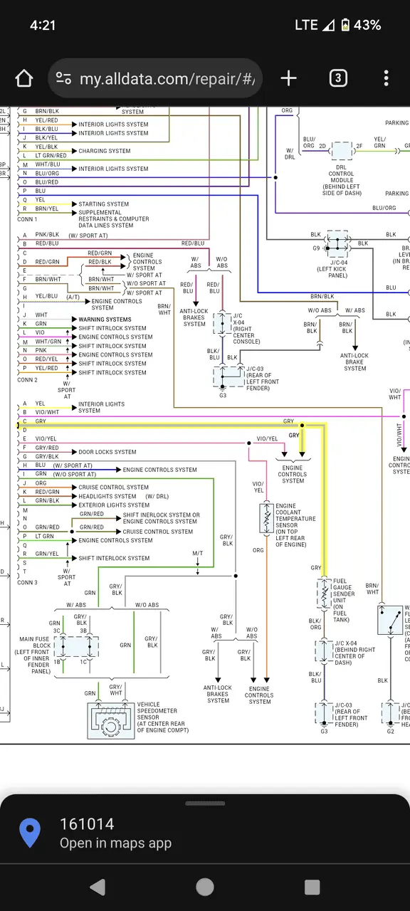

Attached at the bottom is a PDF of the Pinouts for the Detonation EMSx4 unit and what corresponding pin number of the stock ECU they get wired to. The pin numbers are listed at the beginning and end of each row of the ecu plug, making it very easy to count forward or backward through the rows to find the pin number you need. Once I get a decent startup tune squared away I will post it up here also.

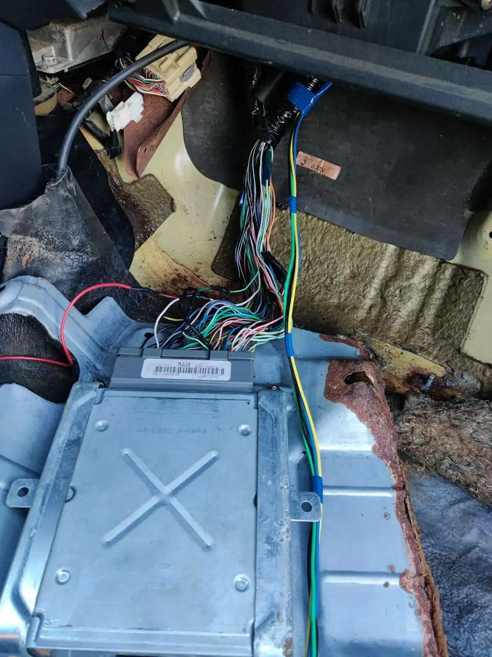

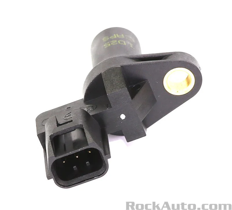

I switched to sequential injection once I upgraded to WRX injectors for a more stable idle, this required some tweaks. A 99 Miata camshaft position sensor and pigtail, changing the idle IAC valve to the speeduino for control and some wiring tweaks, I will update this once I get all the bugs worked out.
Word of advice, Unplug, or blockoff your EGR Valve. I found at times it would make my tune inconsistent, probably due to the factory ecu still opening and closing the valve like normal, this would throw off my air fuel ratio at times do to the oxygen change in the intake manifold.

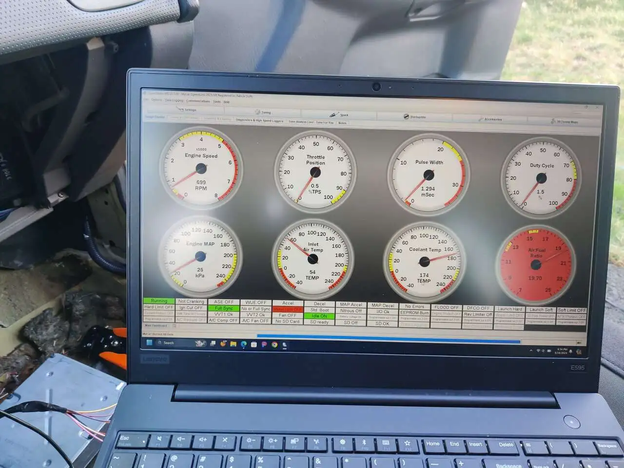

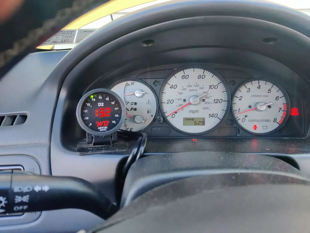

I'm still dialing in the tune a little bit at a time, but the Speeduino hasn't skipped a beat. I'm currently running low boost at 6PSI holding a steady 11.8-12AFR in boost and it feels solid. I'm getting ready to bump the boost up to 9psi soon, but have been monitoring for detonation just to be safe as we know how fragile the FS-DET is. I put together a headphone based knock monitor that works very well once you know what detonation sounds like.

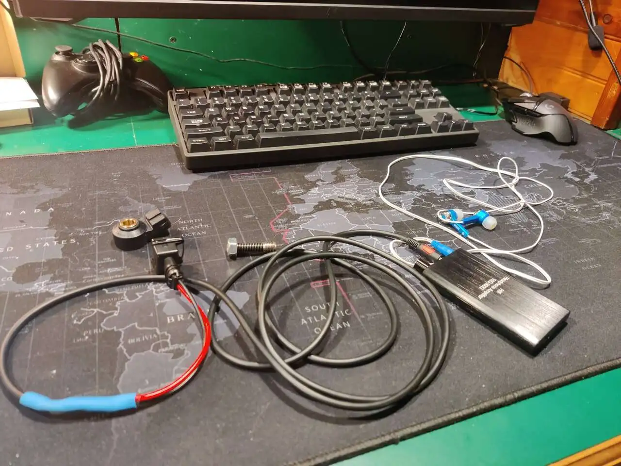

Details on how to put it together can be found here: DIY - Independent Knock Feedback (Knock Ears)
Parts list is as follows:
Knock Sensor: https://www.amazon.com (commissions earned)
Aux Cord: https://www.amazon.com (commissions earned)
Headphone Amp: https://www.amazon.com (commissions earned)
Thread adapters: https://www.amazon.com (commissions earned) you will need one of these and an 8mmx1.25 appropriate length bolt or stud to fit the Bosch knock sensor in the factory location.
Bosch EV1 Harness Plug: https://www.amazon.com (commissions earned) you really only need 1 but it isn't very cost effective to buy 1 vs. an 8 pack.
Add your preferred set of ear plugs or headphones, something that blocks out some environmental noise will obviously work better. Bluetooth is not recommended as there is a lot of latency.
A little tip with Datalogging in Tunerstudio is that you can press the spacebar on the laptop and create a "mark" in your datalog. I'm able to do this in any event where I heard some DET, and was able to successfully back off timing on that cell.

Quick Update. I had a lot of trouble getting Sequential Injection to work. I would get a random misfire at idle speed below 1000rpm. It turned out to be the Variable Reluctance style camshaft position sensor not providing a reliable signal at low engine speeds. I decided to switch to a Hall Effect style sensor like the NB Miata uses instead, but research suggested that that sensor had some reliability issues. I found that a 2006 Kia Optima 2.4 was an upgrade for the NB Miata and decided to give one of these a try since they are quite affordable. I only had to oval out the mounting bolt hole a few millimeters and use a 1-2mm washer at the mounting hole to space the sensor out just a bit. I'm now happy to say that my Idle is perfectly stable.
