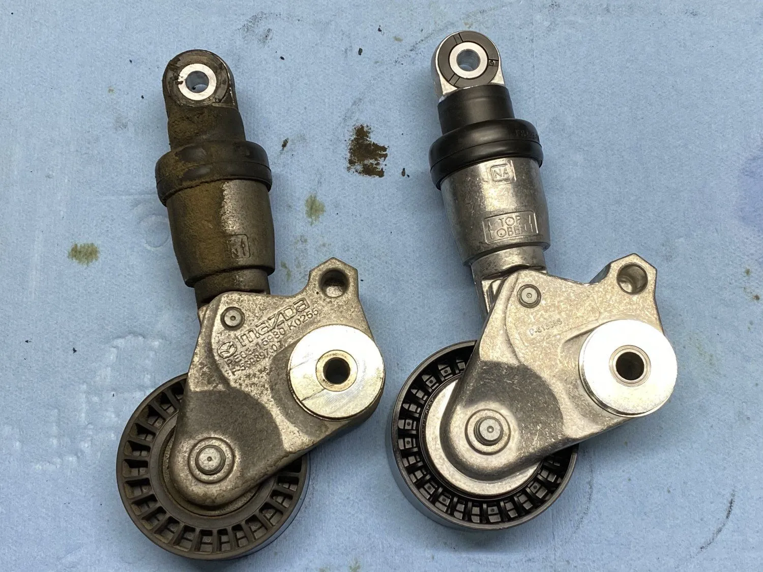

Just received my RockAuto order. The INA tensioner appears to be marked F-613586-0100, and then it says Slovakia 01.10.20. Given the European date format I would assume that means it was manufactured on 1 October 2020 (not January 10th). Not sure what that means as far as whether it matches the latest Mazda revised version or not, but I don't really care. The price was low enough that I can just replace it again later if needed.

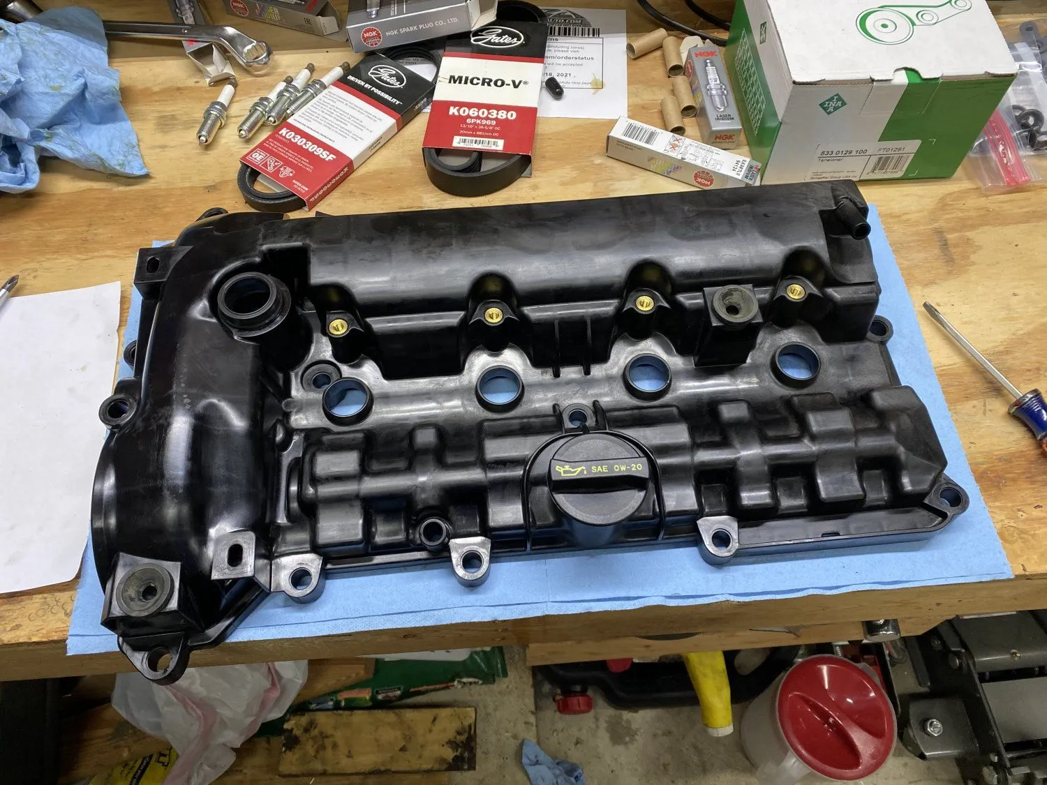

Alright so I got most of the parts done today. Belts, tensioner and valve cover and OVC gaskets. Did not do the final ATF drain and fill as I’ve decided to drop the pan and replace the filter, so next weekend for that.
that stretch belt was a bear. I struggled with it almost 2 hours. Tried the zip tie method several times, couldn’t get it, and one time it broke the zip tie. Finally I put 2 zip ties right next to each other on the water pump pulley, holding the belt, and that got it. Then I had to struggle a bit more to get it aligned on the right grooves on the crank pulley.

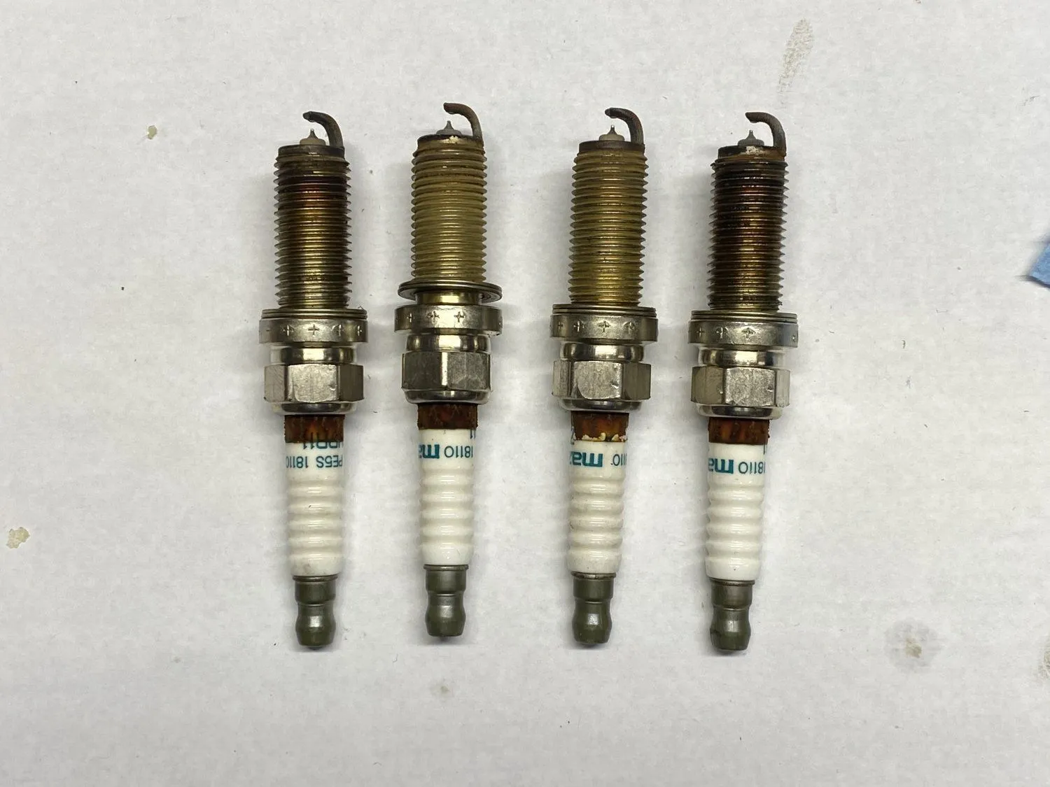

On spark plug resistance, new plugs measured right at 5K ohms. Old plugs were about 6,700 ohms. New plugs measured right at .044” gap while the old had .045”. Not bad for 110K+ miles I’d say.
Comparing your NGK ILKAR7L11 / 94124 plugs ordered directly from NGK website to the same NGK plugs Digbicks1234 got from RockAuto, I just can’t help believing yours at least are having better quality with more consistent resistance, not to mention possible counterfeit issue.

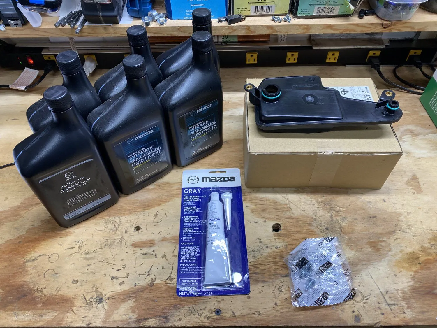

Alright so I finally got everything to finish this ATF replacement job. Got another quart of fluid from the dealer for $15, and the OEM sealant for $11. Package says it’s gray colored.

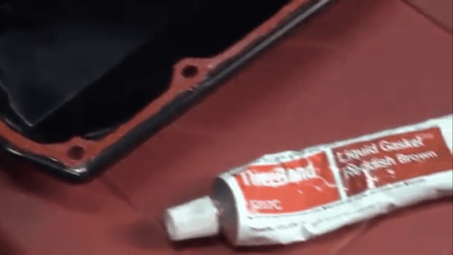

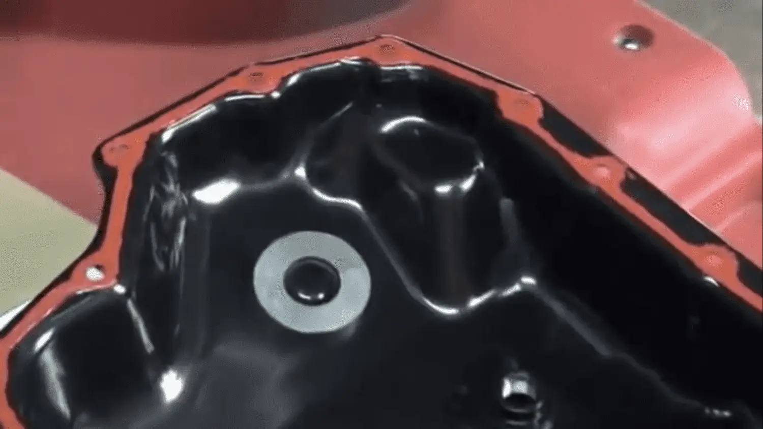

OEM RTV Silicone Gasket Maker 0000-77-1217-ES is gray colored. The factory silicon seal on ATF pan is red / brownish color. The video from Japan uses ThreeBond 1207C Liquid Gasket Reddish Brown which looks like factory seal.
