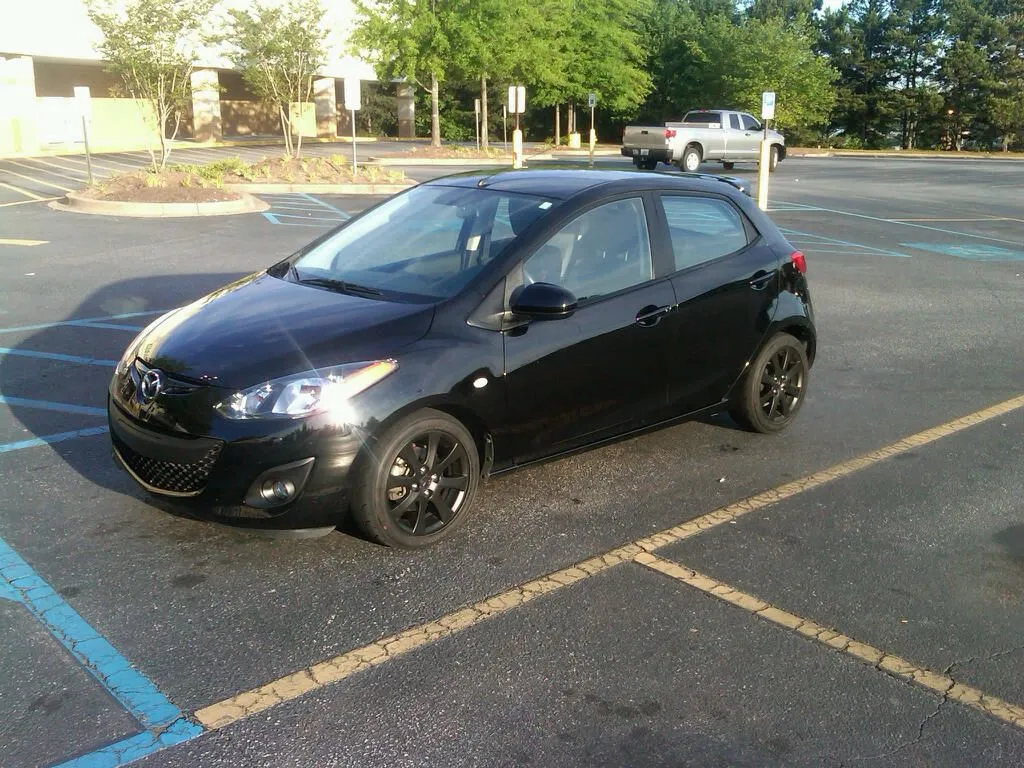

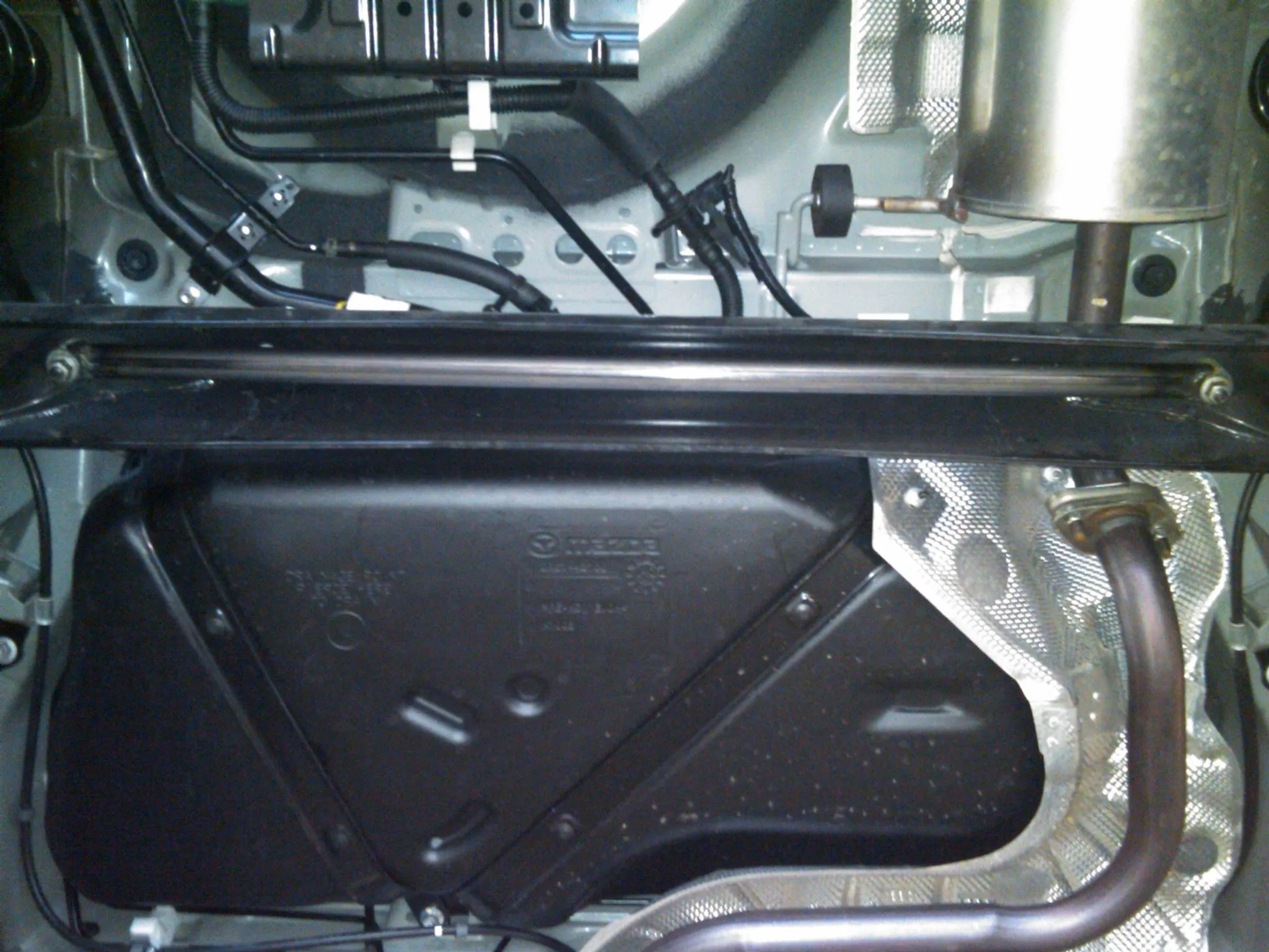

Currently I have eibach lowering springs, fat cat motorsports strut bump stop for the fronts, slotted front struts for -2.5 degrees of camber, a 1 0.120 wall steel torsion beam stiffener which I made. I also have stock wheels painted black with 195 Star Specs. I have the fog light rings painted black. If anyone has any questions about what I did, feel free to ask. I mainly wanted to see if I could make a car handle properly with lowering springs. It was an interesting challenge. Also, I had no money since I was saving up for a house which I not have.

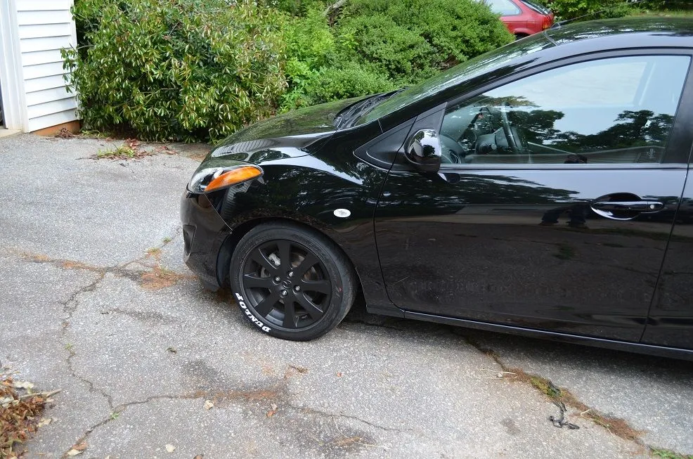

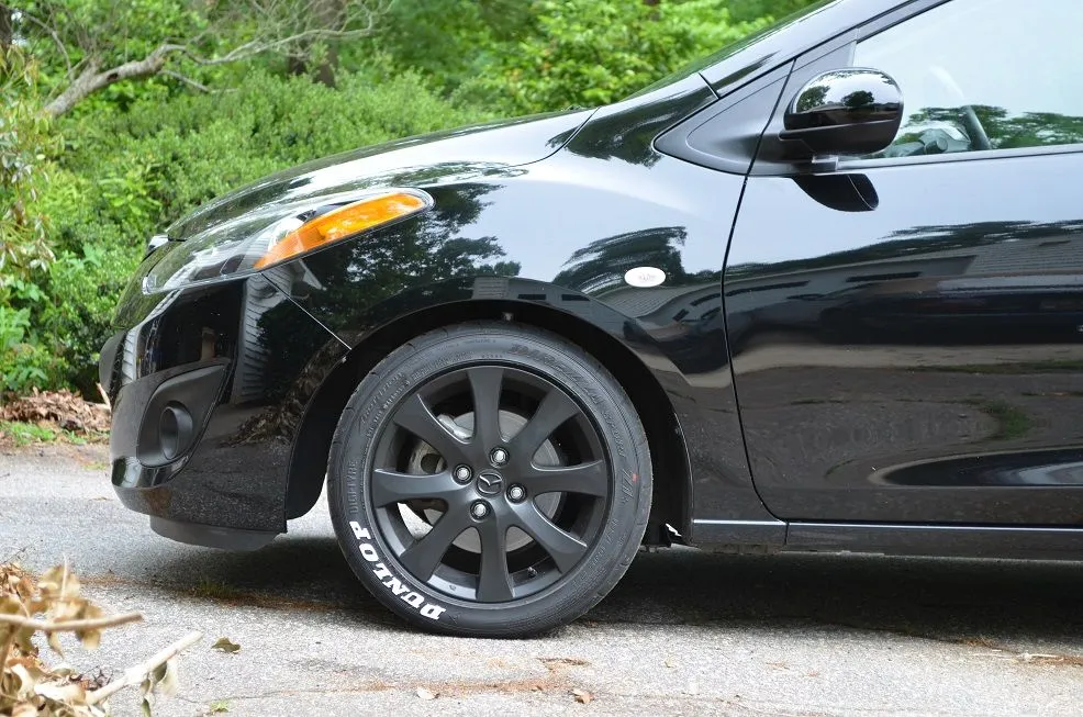

Well I made some paper Dunlop letters to see what it looks like on the tire. Hooray for arts and crafts!! I like it. I want to at least have my wheel spacers first so the wheels sit nicely before I actually go and paint the tire. Any thoughts on color. I can do white, but maybe green or red?
I'm doing white lettering on my new tires again.. Did it last year on my Falken Azenis' and loved it.
