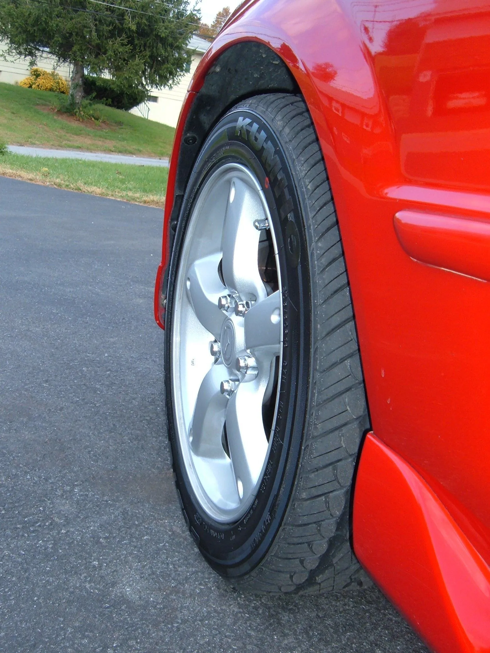

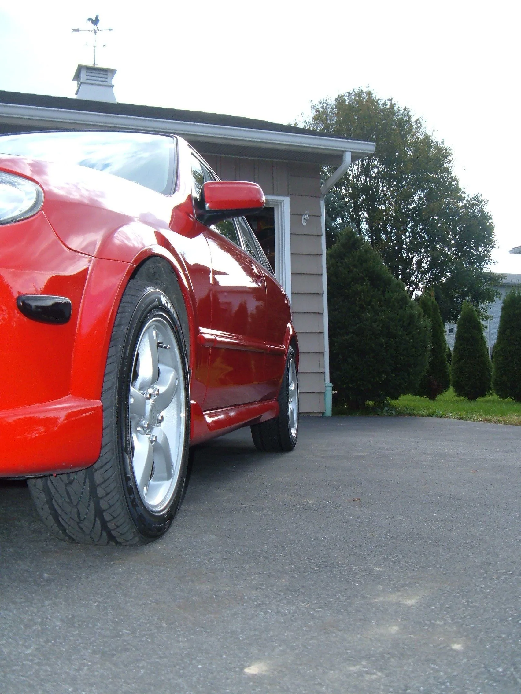

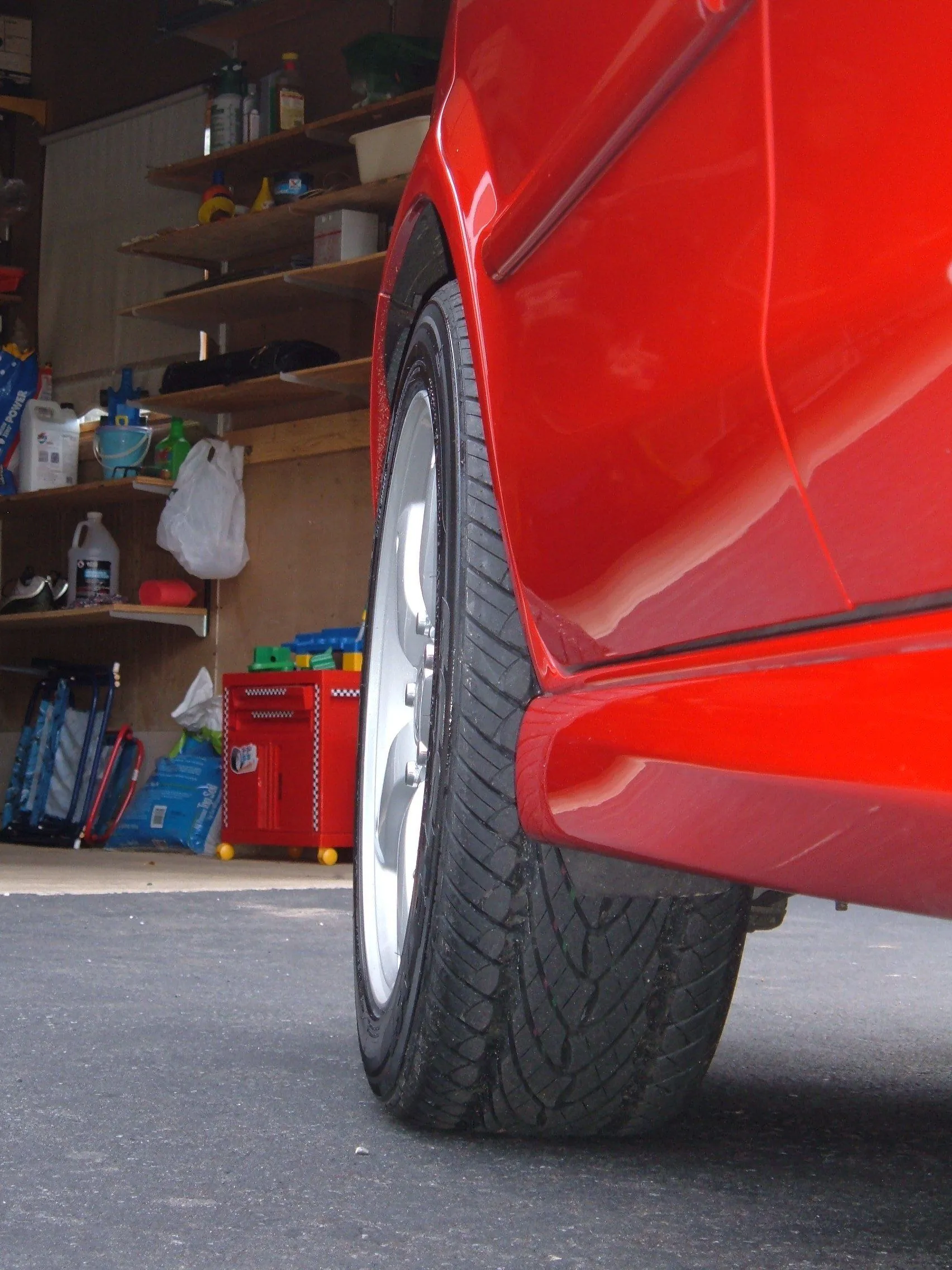

I hear ya, but according to the rep at tirerack the +45 offset will work with either tire size. Here are some pics of them on my P5 to give you a visual idea....maybe it will help, maybe not?

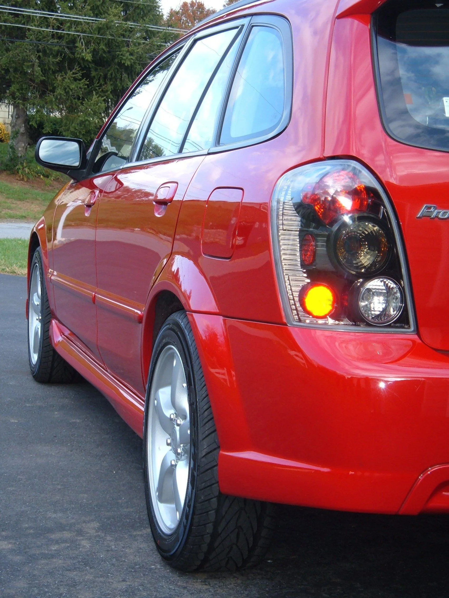

Those pics were taken right after I had them mounted. I curbed the one a few months back and honestly it isn't bad.
I did post a pic in my f/s thread but it didn't come out the greatest. Here is a better shot.
