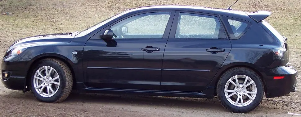

Not too sure what are the SportEditions but they could be the ones in the pic that SpeedMica posted (16" snowflakes?).

That's the wheels I have on mine. Here's a 16 inch option for the op that doesn't want steelies.

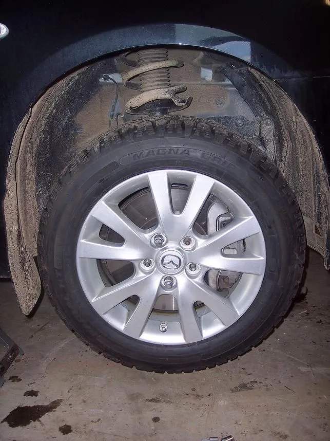

Mazda 3 16's
Regular 3 16"s also clear the front brakes. Bolted up and spun freely, didn't try the rear, but no reason i can think of why the wouldn't fit back there...
No comments about my muddy wheel wells...the last 50 yards of road before my house is dirt, and they just leveled it...(encourage)
