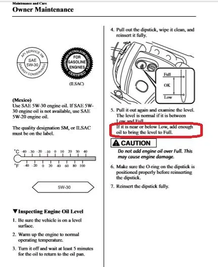

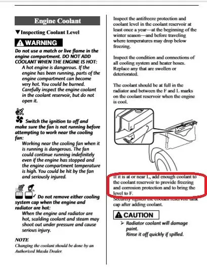

"You don't need to top off a new vehicle and probably shouldn't."
Then why our owner's manual always says adding enough oil / coolant "to bring the level to Full"? ;)
