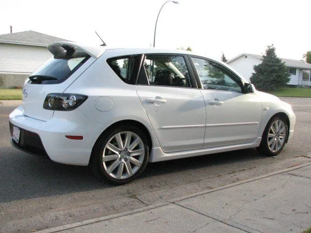

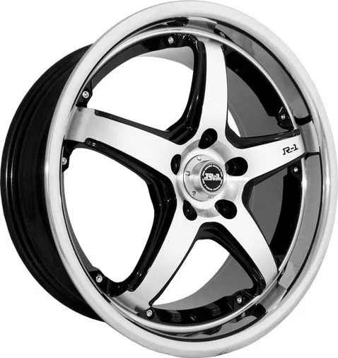

Here is my version of the best looking MS3.
White, with these wheels. I already ordered the car, now i just need to get the wheels but they only come in a +40mm offset. Thanks hirudin for the info. a popular wheel website said they could machine the hub. im not goin to if i dont have to. i do want to lower the car with cobb springs, so thats about a 1.2 inch drop in the back. i dont mind a little rubbing but none at all would be better. forcefed, do you think i should trust this wheel website to machine the hub?
