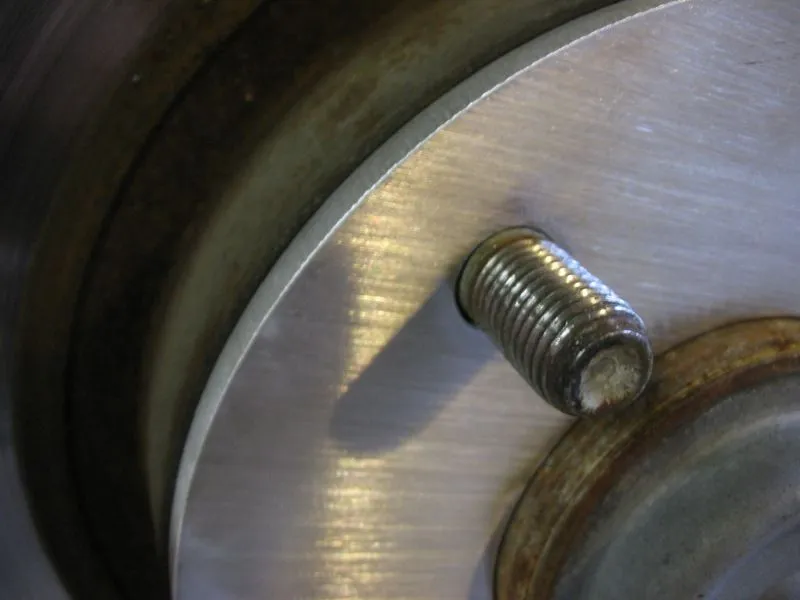

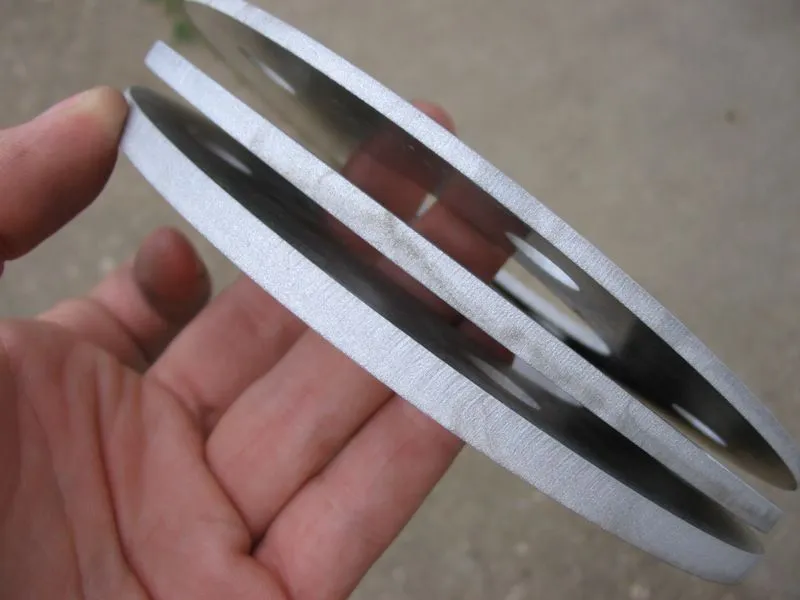

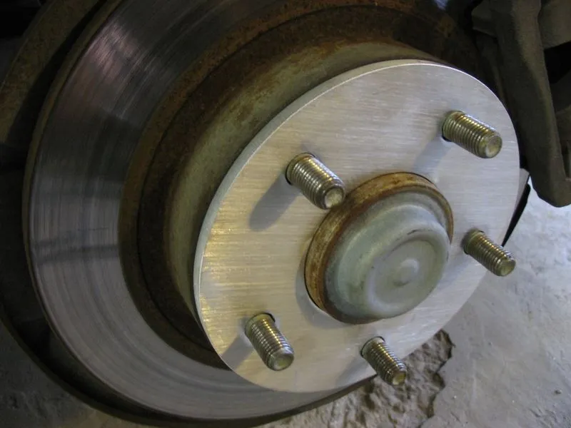

Fit is nice and snug and matched to the hub as you can see.. the 3 you see in my hands are the 1/8, 3/16 and 1/4 spacer which is the 3 sizes I have on hand right now.. more are coming next week.
here are some pics for you guys..
thanks!
Steve
got a few in today... need to sort out what I need and will try to get some shipped out right away if I can.
thanks!
Steve
they look nice , the spacers fill the whole area of the brake disc that's covered by the wheel ?? just wondering
Yep, there is about a 1/32" lip where the brake hub is bigger than the spacer, but that's about as much of a mismatch as is there.

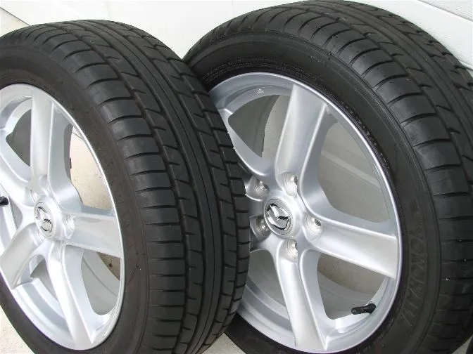

I've been thinking about getting 16x6.5+55 '07 Miata wheels for my P5. But I'd need about 15mm less offset there--are spacers stackable?
really, you would only want a 5mm spacer to match up with the stock pro5 offset of 50 - then, no problems
Stacking "shouldn't" be an issue, but you'd use as few as you want to.
And yes you are exactly correct on the wheel bearing thing.... lower offset makes it the same difference.... and why I typically discount it as a non issue, but it's what some people will bring up, so I wanted you to hear my side of it before somebody comes on and makes it sound like impending disaster, when as I said, I've never heard of any actual instance of it happening.
