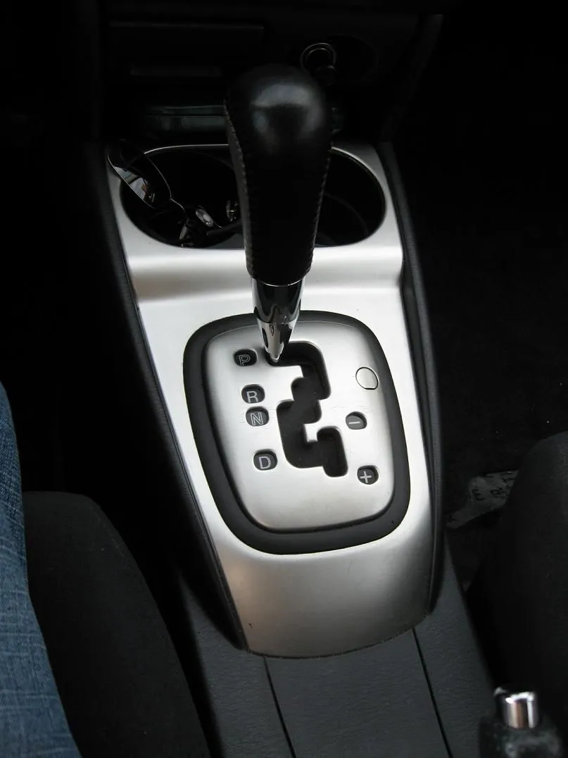

Question?
Anyone with an auto...
My lights on the transmission console aren't working. I noticed them on one time, then when I hit a bump, they turned off. Something might be loose. Anyone know how to take the cover off and get to the lights? I don't want to break anything.
Open arm rest, pull up on e-brake surround and remove, pull up on the back of the shifter surround then remove and work from there.
