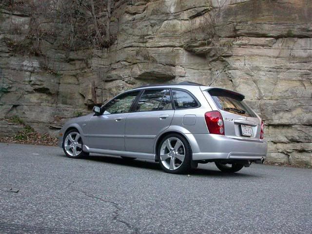

soon my preciousss soon
I was just thinking the other day about these rims! I do not think I have seen them on a P5 yet (drinks)
