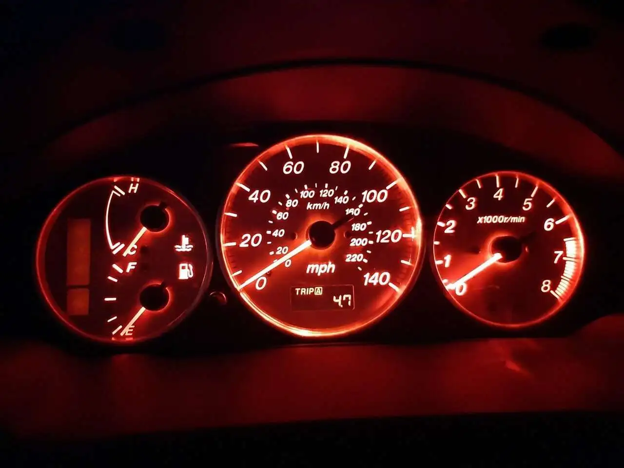

Let me know what you try for bulbs. I tried some cheap LEDs in the past and they had very uneven light distribution and would flicker intermittently. Right now I have a set of LEDs on the right and left sides and some halogens in the middle so it's a variety of different brightness and shades of red/orange across the cluster. Would be nice to have it be brighter and uniformly lit.
I’ve heard the stories about LED issues, so I’m not sure which direction I’ll take. Hoping that a name brand LED will work better than the eBay cheapie stuff but who knows?
Just sharing my experience with gauge cluster LED bulbs that light up evenly!
Okay yes I do remember this. Just never got around to trying the bulbs from that site. But if Blue Pro5 goes that direction I will probably do the same.
I've got a set sitting in a box. Have been debating whether to install them or not. I feel like they don't match the rest of the interior but maybe I'll give them a shot having seen your picture.
You won't regret it. They are an elegant but subtle touch to the gauge cluster.
Yessir. Found an old listing here and reached out, luckily the seller still had them.
Thinking about grabbing new gauge cluster bulbs before getting into it and installing these.
Wow! This is why it never hurts to ask.
Thinking about trying the blue LEDs for the gauge cluster.

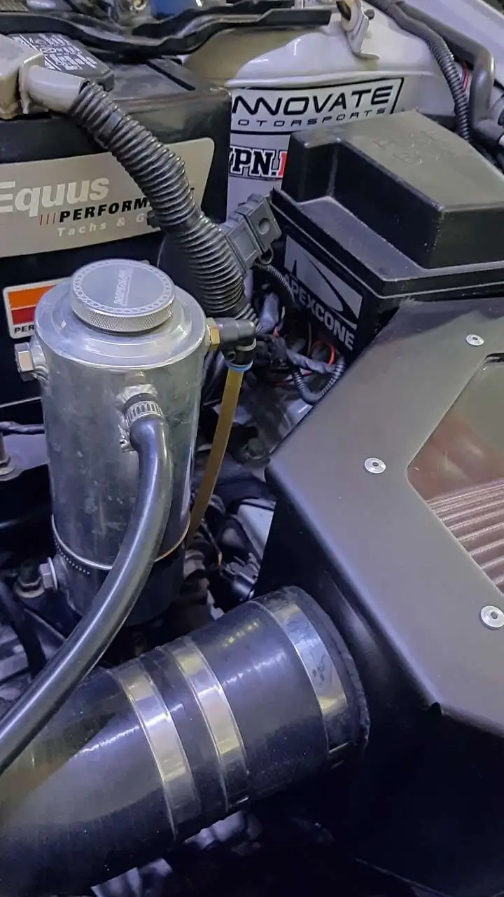

Had to pull sight tube off weapon r aluminum overflow jug and plug holes with bolts. the tube failed and was leaking. luckily i found this out in garage running the car for first time in a month or more. just staring under the hood after lettin it wake up the neighborhood with some revving. beat the hek outta finding it out driving and it making huge mess and overheating the thing. will just have to unscrew the cap to check the level that way......oh, the hassle, lol......callin today a big win to catch that at home.
ugly long 1"x3/8x24 pitch bolts until i can order a coupla 1/2"x 3/8x24 allen heads
or were they 30mm m10x1.00.....dangit, lol...

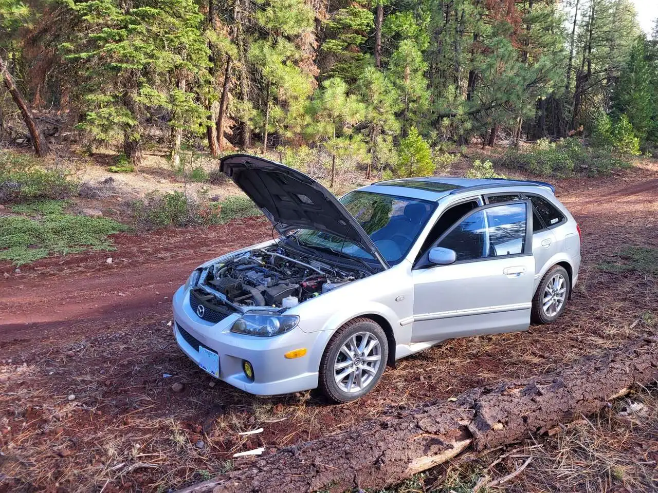

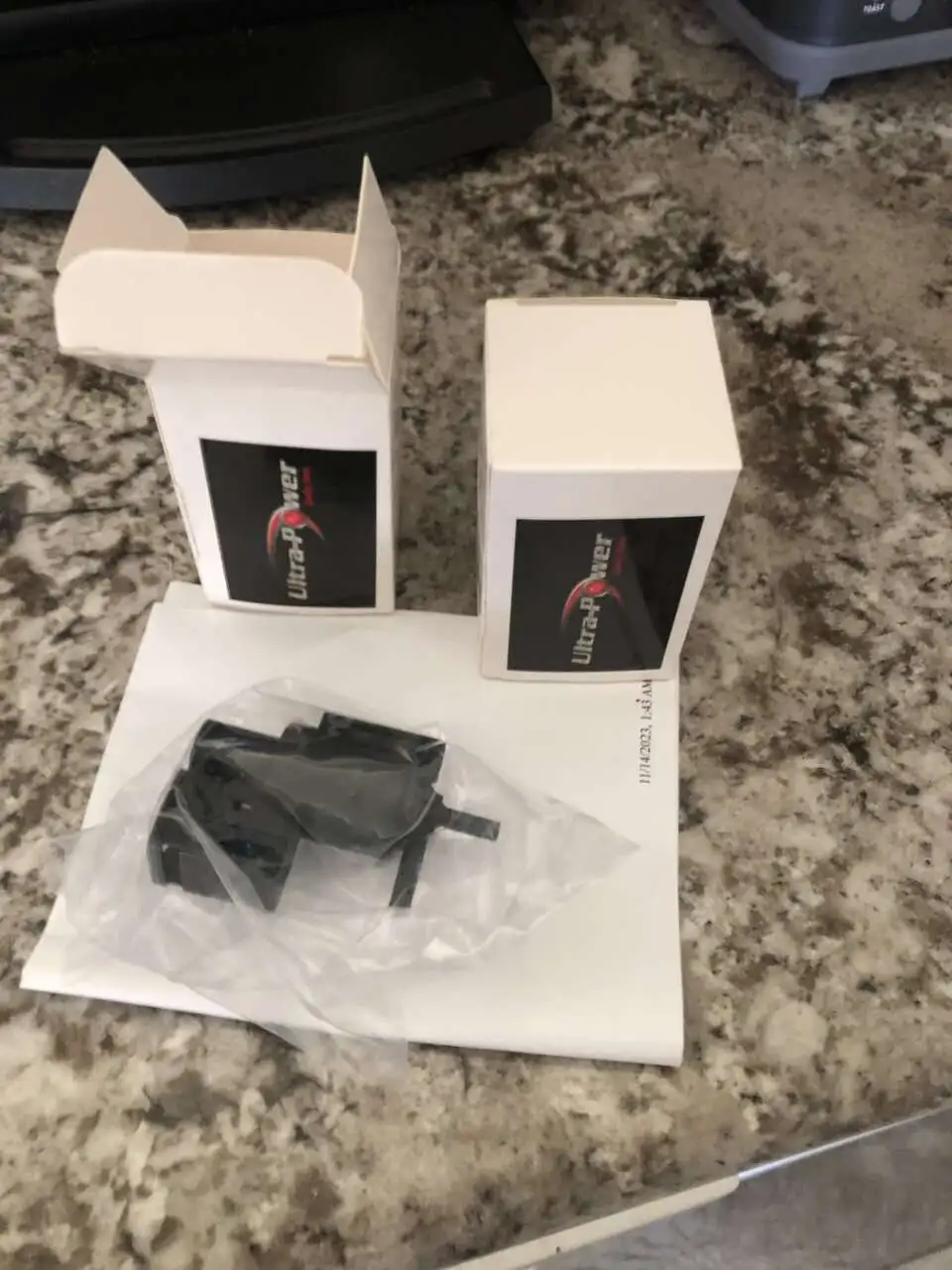

I think I finally fixed this, but of course only out of absolute necessity since I've been putting it off. It finally got bad enough that I was completely stranded, and or course in the absolute middle of nowhere, while alone (see picture).
With the battery disconnected, I was pulling out and tapping (rather aggressively) the main ignition relay and it wasn't doing anything. The relay is easy to open so I even opened it up, plugged it back in, reconnected battery, and pressed the contacts together myself and still no luck, so I was at that point pretty sure it was not the main relay.
Eventually decided to push the car to a hill and then bump start it down, which avoided a stupid expensive tow bill. But after that it would not start at all. Same symptoms I originally described.
Got it back home and started debugging. Eventually realized one of the bolts holding the ground wire to the terminal connector (which I replaced with a cheap aftermarket one like 3 years back) was missing it's nut and the ground wire was corroded. Cleaned that up, replaced the nut, loctited all other terminal bolts and it starts great now!
Several of you guys suggested battery terminals so kudos to you all. Should have checked more closely...lesson learned. Just happy to have it fixed.

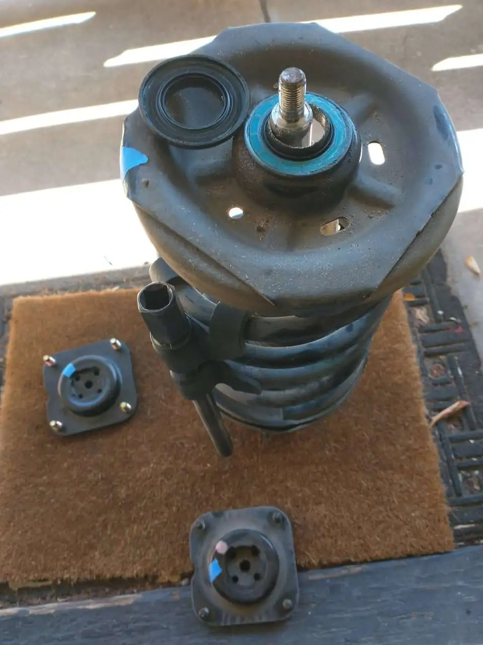

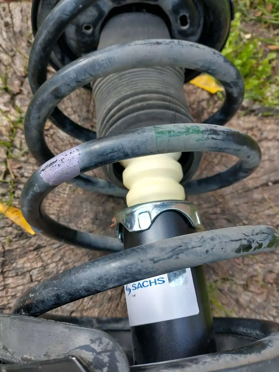

Parts used to rebuild front strut assemblies today:
Bought Chinese-made Sachs (~$60 apiece) from Rock Auto instead.
Reused the original springs, dust boots and upper metal "spring sheets."
Bought OEM bump stops and upper and lower rubber spring seats.
Bought Monroe strut mounts (included bearings).
I only did one side today. After removing the KYB strut, I compressed the piston on it and the rebound rate was almost non-existent. That strut was six years old and had only 10k miles or less on it. This lack of rebound may explain why the front end didn't always keep its footing when going through dips in intersections at quite reasonable speeds. The ride is quieter now, but the passenger side is still making so much noise that it's hard to tell. 😮 I'll replace that strut soon.
At this point, I've replaced nearly the entire suspension, front and back.
The upper spring seat was in pretty rough shape. The lower one looked pretty good, but I wanted to replace it anyway.

I replaced the remaining, passenger front strut and there was some carnage on that side. I couldn't get the upper rubber spring seat off the coil spring without my mini sledge. The original factory bearing had separated on this side, whereas it was "only" oozing on the driver's side. The KYB bump stop was split in half on this side and intact on the driver's side. I must make some crazy left turns... :)
The ride is now a little quieter and feels more competent, but I've still got some clunks and clicks. At this point, I've replaced all suspension wear parts in the rear except for the pair of forward lateral arms. As far as potential noise-makers in the front, I still need to replace the outer tie rod ends and the axles as they are both torn/lightly clicking, respectively, as well as those damn near inaccessible stabilizer bar bushings. I haven't been doing a great job of identifying the parts making noise before replacing parts... But hey, I say that it's not a parts-cannon approach if the parts you're first replacing are obviously shot and need replacing anyway. ;)
As with the driver's side, when I compressed the old KYB strut off-vehicle it took forever to return. I don't think that's normal, and it certainly isn't compared to the new Sachs. Speaking of which, the Chinese-made Sachs brake line eyelet was too small to properly receive the metal part of the brake line hose, so I wasn't able to mount the hose without expanding the eyelet with a pry bar.
Anyway, KYB struts are off the list for me. I've got a friend that's had good luck with that brand, but I have not.

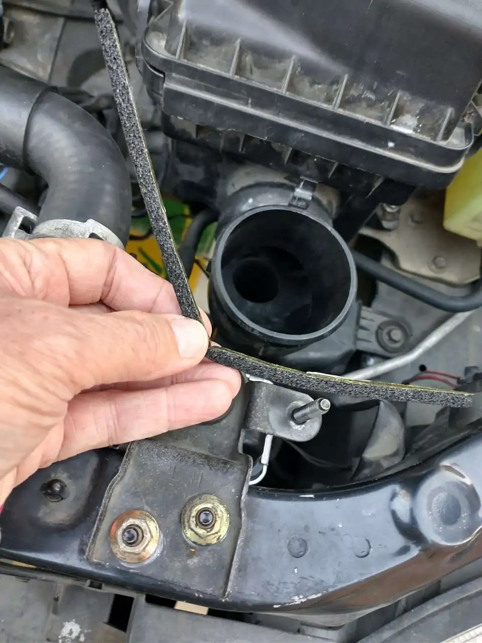

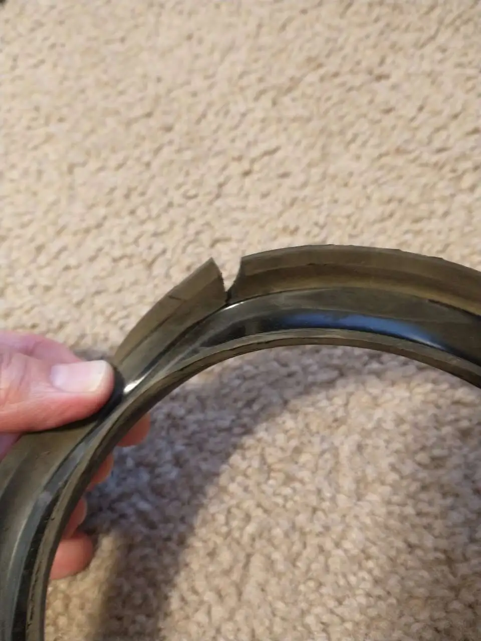

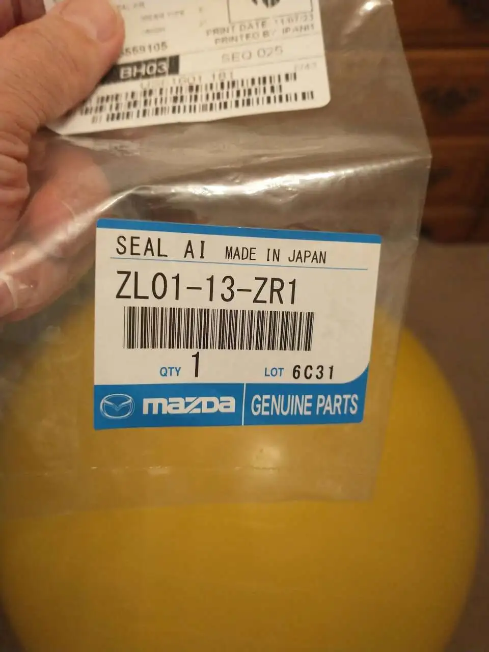

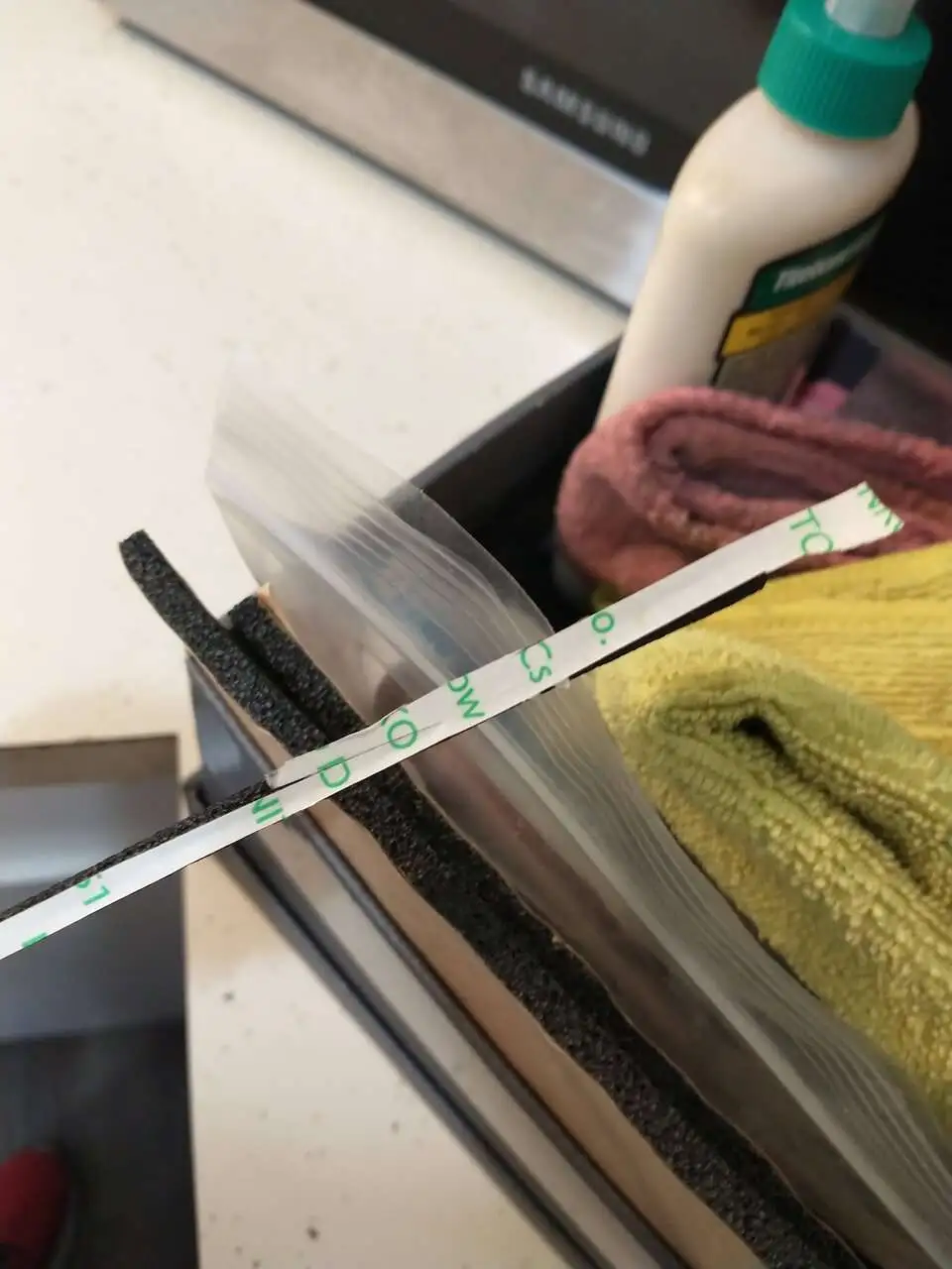

I replaced the little foam seal on my air intake. The old one was crumbling, and while it wasn't allowing unmetered air or anything, I wanted to replace it. I already had the OEM "part" from my strut rebuild order above. The part isn't circular, but simply a strip of foam insulator with tape on one side. That was a bit of a let down in and of itself, but what was *way* worse was that the item itself was really poorly cut. I was shocked to see anything labeled "Made in Japan" look so awful as the Japanese are insane about quality control, even for a $2.50 item.
What made things more entertaining is what I found in the same storage box as the glue that I retrieved to repair the lacerated part: An entire sheet of foam insulator with one side having a tape backing that I didn't know I had. I literally could have measured and cut a strip of this sheet and been better off than what I received from Mazda.
The seal ready to be installed under the lip of the circular air intake tube shown below:
"Part" from Mazda with flaws, with glue and the sheet of material I could have used in the background:
"Made in Japan." Pfffft...
