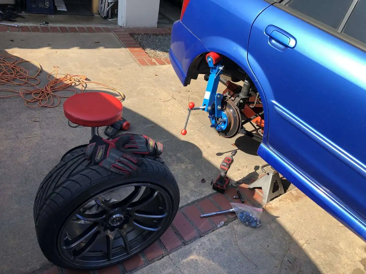

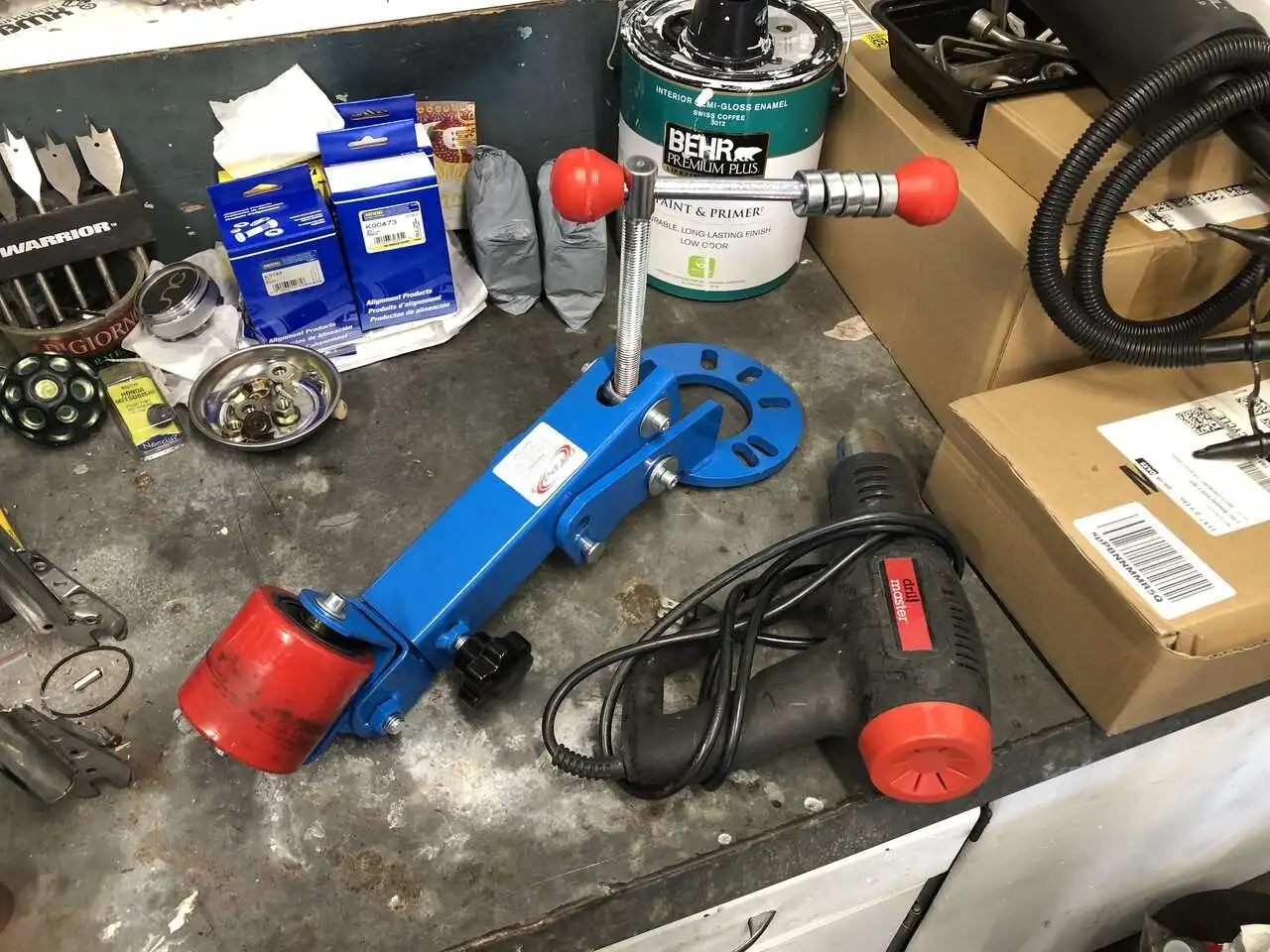

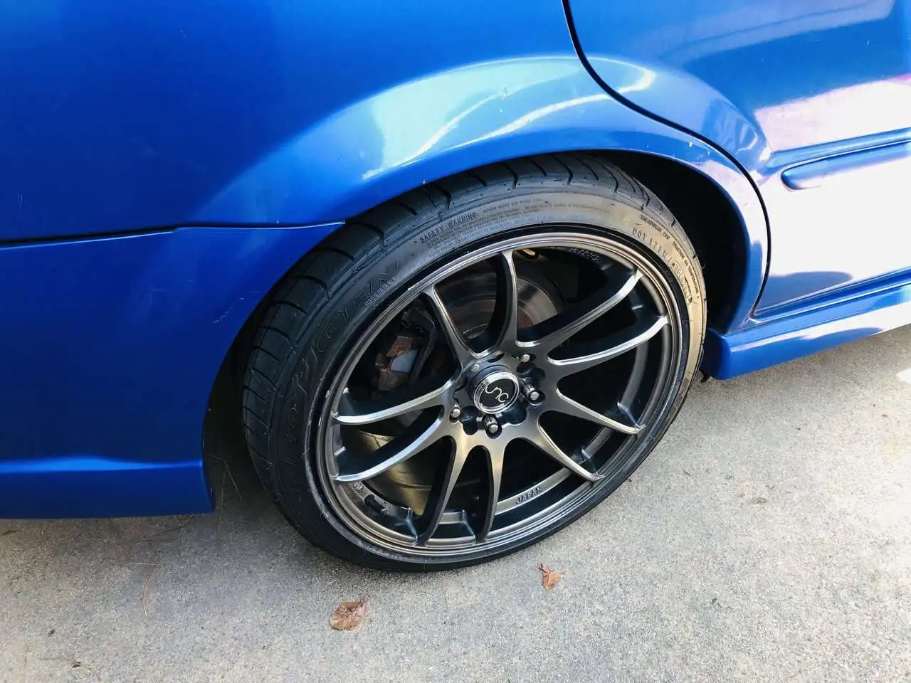

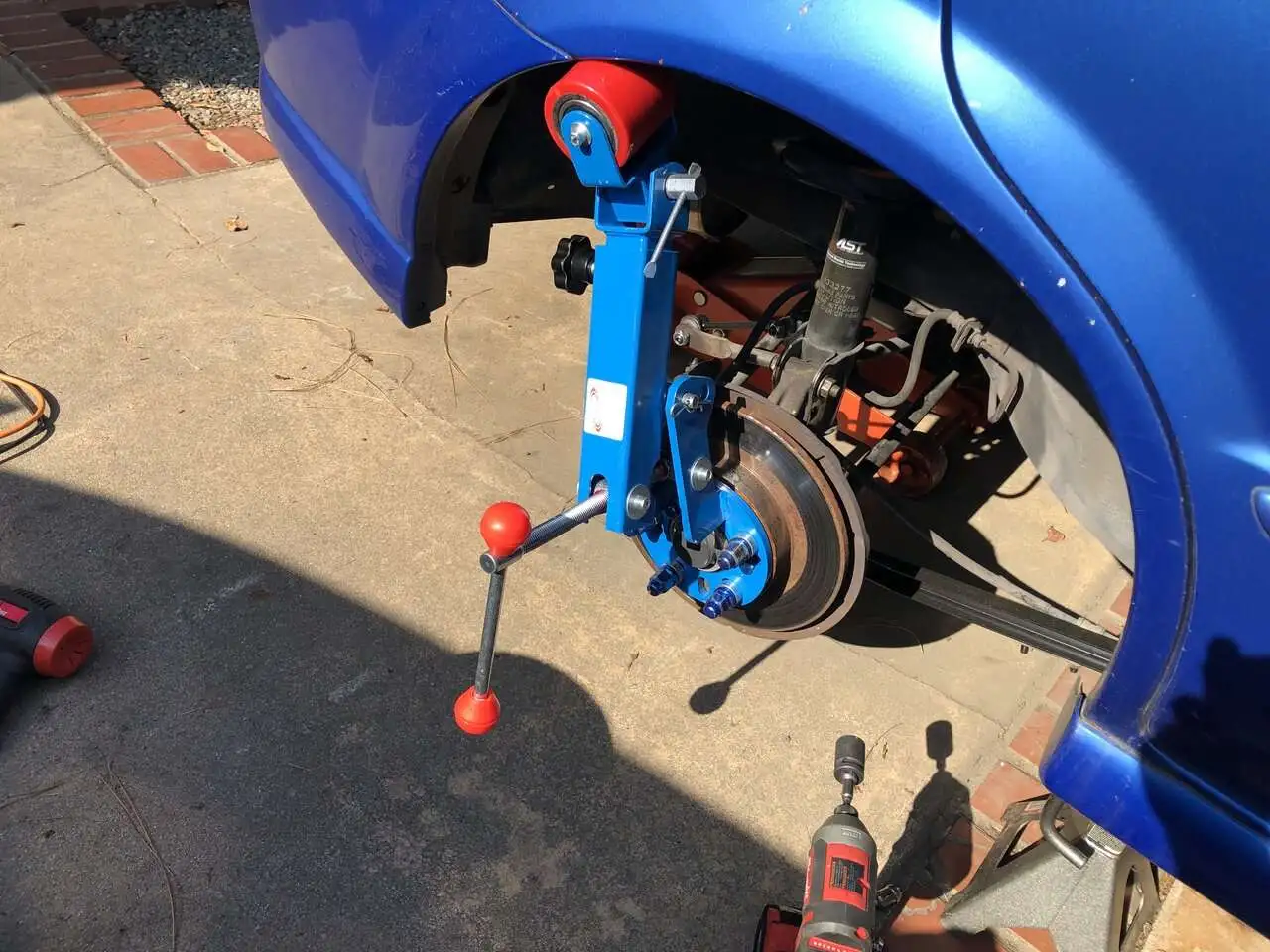

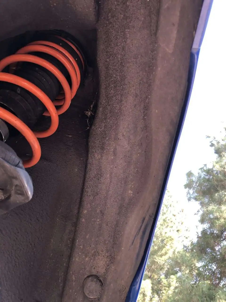

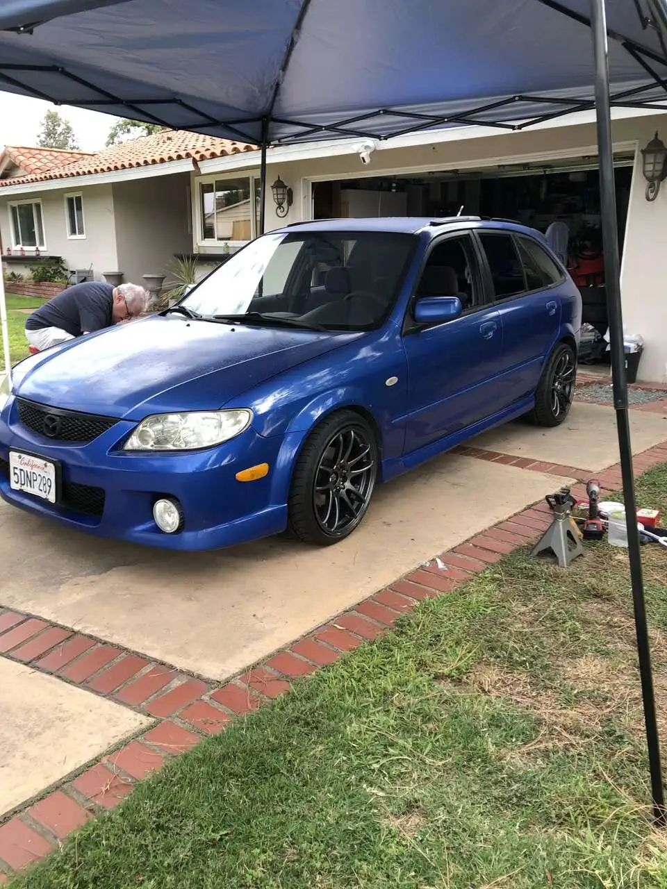

Knockoff fender tool and the HarborFreight heat gun
It took a minute to feel comfortable with the adjustments, and this tool is extremely janky and loose, but it did the job.
Like all the videos say, use PLENTY of heat and small adjustments, expect to take at least 30 minutes per fender.
No cracked paint or ripples for me, I’m happy with it, and after taking her out for a spin there is no more rubbing. 😎

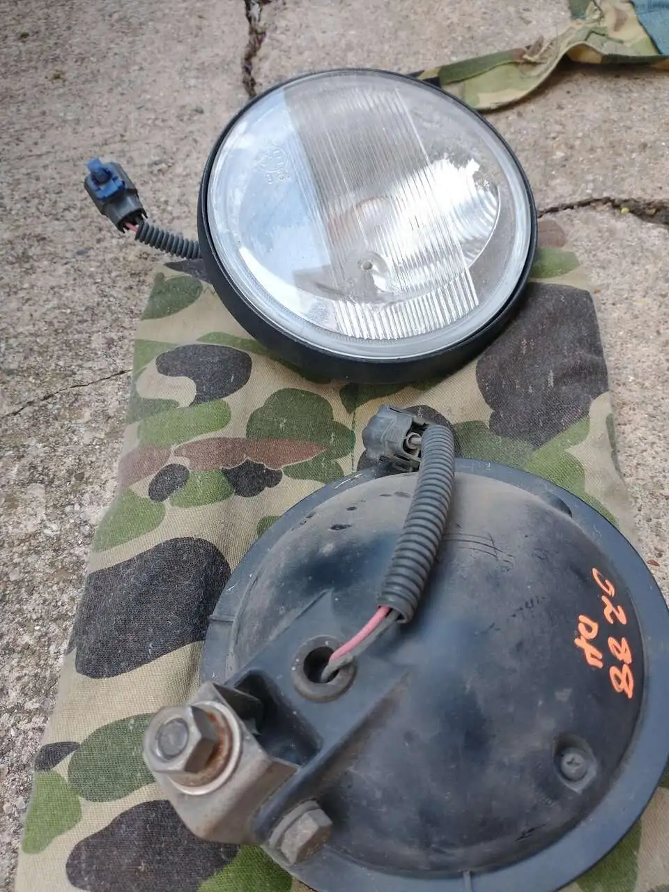

Went to the salvage yard today and got a fog light to replace the one which has had a hole in it for ten years. Better late than never, eh? Picked up an extra master power window switch since I'd had one go bad in the past. I went spelunking in several Mazdas for a roadside jack, but they usually pull those out of the cars so that people don't use them and crush themselves under vehicles while on the lot, I guess. They had what looked to be a similar Nissan-branded jack on a shelf at the register and I bought that. Luckily, one of the cars I looked in still had both the jack handle and T-bolt used to store/secure the jack while in the vehicle.

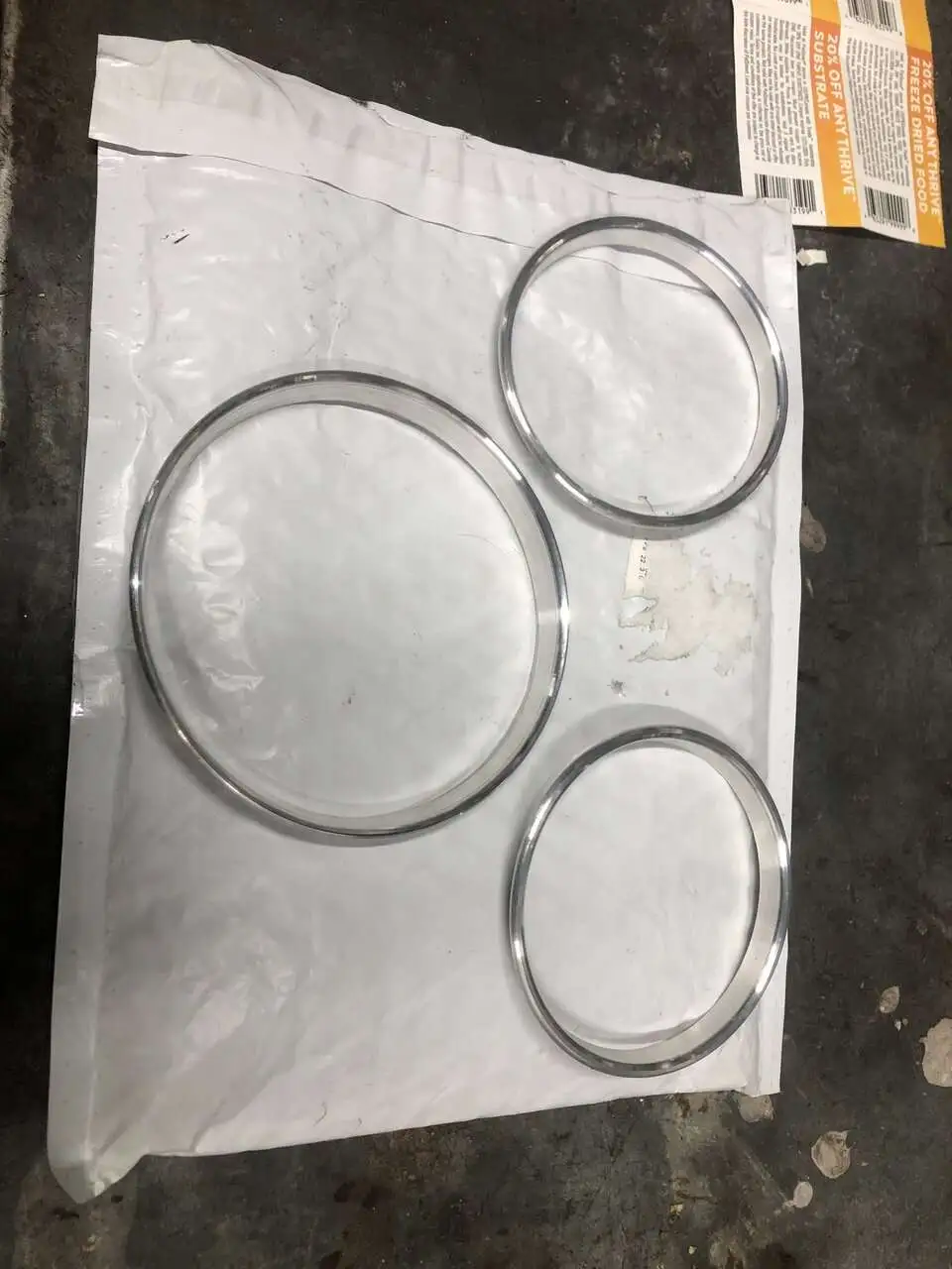

@Blue Pro5 Are those the rare OG polished DaveB rings?! If so, nice score! IMO they are the best visual mod for the interior.
daveb1-jpg.190198
I've got a set sitting in a box. Have been debating whether to install them or not. I feel like they don't match the rest of the interior but maybe I'll give them a shot having seen your picture.
Yessir. Found an old listing here and reached out, luckily the seller still had them.
