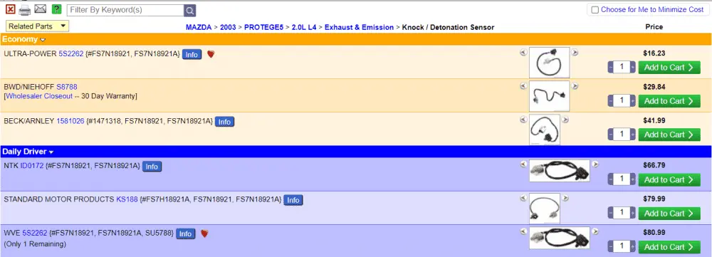

I know that good knock sensors at Rock Auto cost north of $50, but I was a little surprised to see a price tag of $462 for the dealer to do it as it looks bog simple to replace.
Just buy an OEM knock sensor (ignition detonation sensor) online, and install it yourself, if you want OEM.
(The drawings of the parts aren't always correct and they were drawn by 6 year olds with crayons. Lol
Cross reference the part # to make sure.)

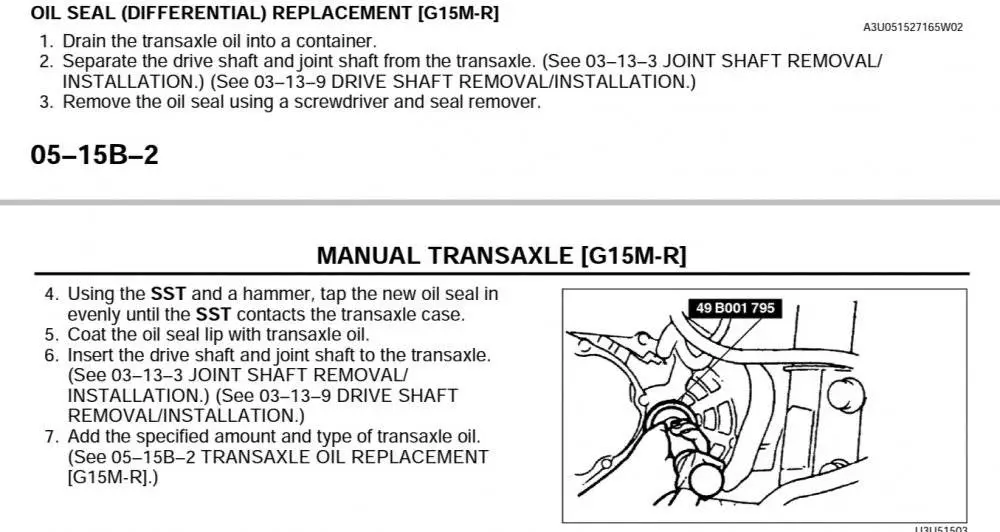

The other recommendation from their multipoint inspection was to fix a leaking left-front axle, and their price to do that seemed quite fair at $276. Note that they can't get their hands on a Mazda OEM axle right now, and would use a third party part so that might be part of the reason that the price seems low.
Where is it leaking from?
If the boots are leaking, you need a new axle.
If it's leaking at the transmission, you need a new oil seal, not a new axle.
My right side axle seal started leaking after having the axle in and out 4 times to replace my alternator.
I paid $184 for the seal and labor.
The axle needs to be removed to replace the seal, and that's a big job on our car.
You should be able to replace the oil seal yourself.
You've done some major work on your car already.
You should be able to pull it off.
You don't need the SST.
You can just carefully tap the new seal into place with just a hammer and maybe a block of wood.
You just have to keep it square.
The seal is about $15.

I wonder if I should try replacing it then. My car makes all sorts of noises and vibrations that I don't understand, but I also tend to be a little too concerned and obsessive with small stuff that probably isn't important.
$150 is steep for a non-essential "fix". I can buy a used OEM one on eBay for like $20 shipped. I don't see any brands I particularly like/recognize on RockAuto though...

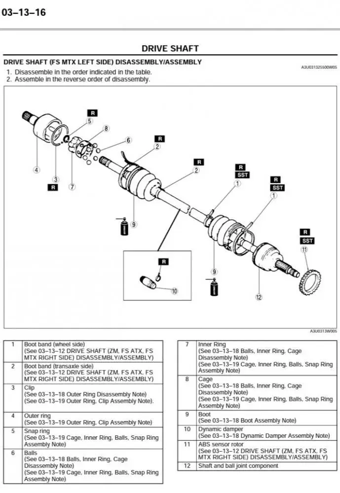

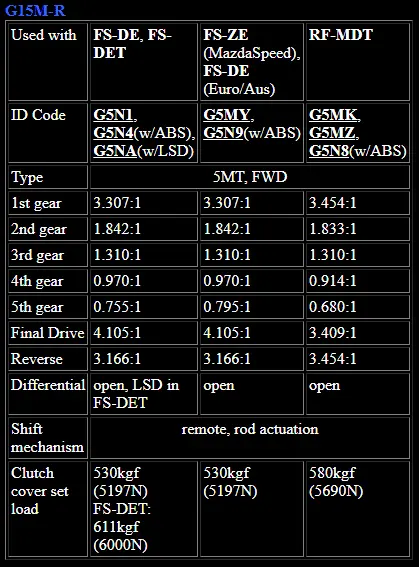

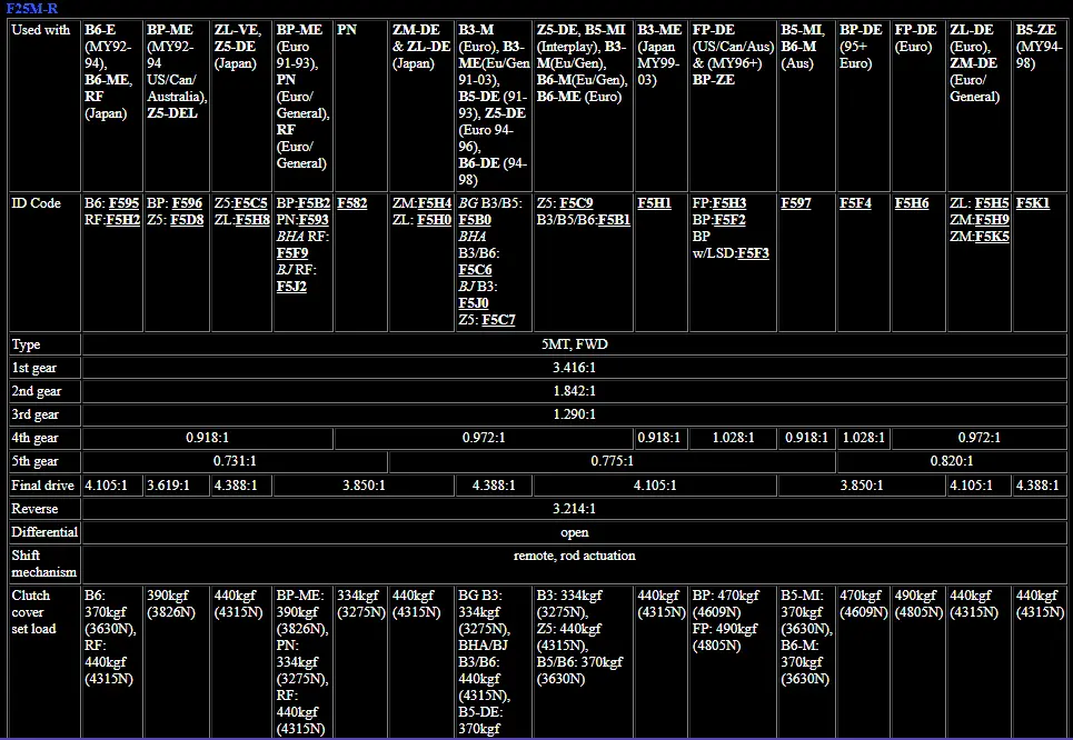

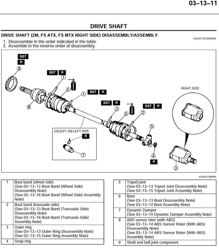

The left front axle is different for the manual transmission.
It looks like it's a much beefier axle, but I have no idea why they would only beef up one side ??

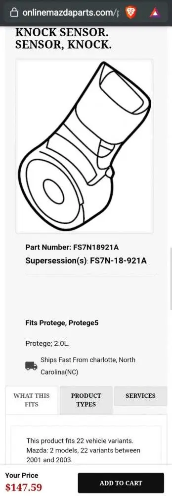

It may not even fix anything.
I'm ignoring mine until I notice a problem.
I would worry that it would be an original OEM sensor and they just wiped the goo off. Lol
I don't really know about brands, but at least with RockAuto, it will almost certainly fit and work.
How long it lasts and the quality has more to do with the brand I guess?

Well, I can tell you when I was a teenager and stuck my head under the front of Mom's VW Rabbit (diesel) that one axle was thicker than the other. I didn't understand it either.
Part of that might be to keep the weight of each axle the same.
I think it was my GLC that had a big rubber weight on the shorter axle to weigh it down.
If one axle is lighter it will have less inertia, it will get more power during acceleration and the brake on that side will grab harder during deceleration.
On our car they use the same axle for both sides on the ZM automatic and standard transmissions.
The FS has that same axle for both sides on the automatic but the standard transmission has a different axle (not necessarily heavier, but stonger) on the left side only.

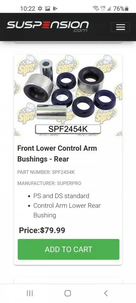

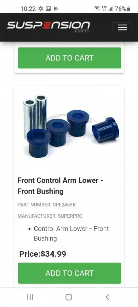

One thing you might be able to do is replace your bushings with urethane bushings.
Urethane is a much more durable rubber and you might be able to pick your durometer.
The specialty shops should have something.
The guys from down under don't replace their LCA's, they rebuild them.
They press a new ball joint and bushings in.
They just use a hammer and blocks and pound in the bushings and there's a tool to press in and out the ball joint.
They wonder why we keep buying new LCAs...
So you might be able to replace your bushings with something sporty.

It looks like your Delphi LCA's use regular rubber.
Urethane appears to last 3 times longer, but doesn't offer original ride quality.
Urethane is harder and transmits road vibrations into your car.
You may prefer that feeling and may like it. (like a go-cart).
You can get all carried away with solid engine mounts and Urethane everything but your eyeballs might start to bounce, your rear view mirror vibrates uselessly, and your fillings will rattle out out your teeth. Lol
Plus,... if you tighten up your LCA's, the vibrations are sent into your steering knuckle and start to pound on your bearings and everything else for that matter.
Everything starts to take a s*** kicking, and you need to upgrade and replace all kinds of components.
Not to mention the cost of having all your fillings replaced at the dentist. Lol
It's your call.
If I were you, I'd spend the $115 on new LCA bushings instead.
It may not be an "essential fix" but you get a lot more bang for your buck.
Your bushings sound like they are shot anyway.
Yes, this is something I have considered. I like to browse eBay for cool mods and then save them to my watchlist, never to be looked at again. But I do have some poly bushings saved that are fairly cheap somewhere in my eBay.
I should have kept my old LCAs so I could work on them in the background and keep driving my car. I would need a press though I think.
Yes, that's the tradeoff. I don't want to roast my ride quality. The car is comfy enough now for being a small light car, so maybe I could sacrifice a little.

Apparently there was a sticker on the transmission saying which one it was, but mine fell off before I bought the car.
The "easy" way I can suggest how to decipher, is, if it's got the FS-DE, it's a G-series transmission. If it's anything else, I think they put the F-series 'box in there.
ProtegeFAQ had a pretty good transmission section that also linked engines with transmissions.
  • Like
Reactions: pcb
Oh, OK. I must have have the G-series then.
I remember skimming through the two transmission sections in the service manual, and they appeared to be identical.
Perhaps there's internal differences?
I didn't look into it too much.
Internally it looks like "yes" is the short answer. Given the lack of part numbers, I couldn't give you interchange between the two transmissions, but I can say that I think the F-box is "less stout" given the engines the two were attached to.

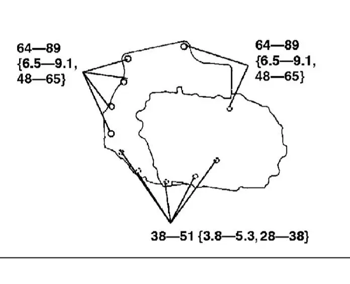

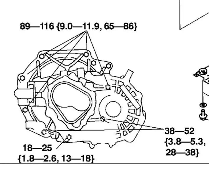

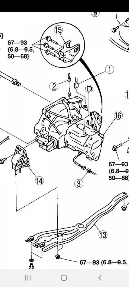

I checked again, and noticed that the front mount bracket is different between the two transmissions...
The bottom picture is the G-series transmission and it looks like a stronger connection to the front mount.
The bolts on the G-series have more torque and are probably bigger bolts...
