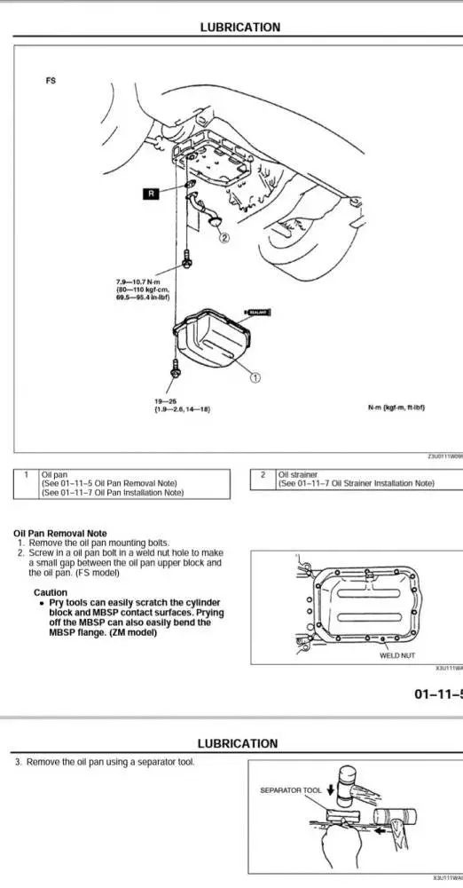

and an oil leak from the pan gasket as well.
There are oil pan gaskets available but a few people had problems with them leaking.
The ended up removing them and using silicone.

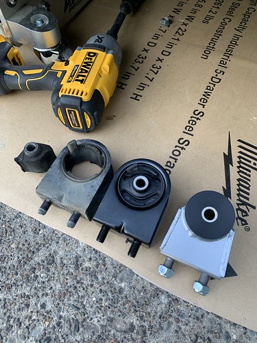

Just finished doing the front motor mount and passenger motor mounts (the easy to reach ones) on my P5. Doing the same job now the my MSP. Make sure you order a mount kit where the passenger motor mount already has the mounting ear to the engine installed. Otherwise, it's definitely a project staller.
Shout out to AWR for this front mount. Ally at AWR said the Front Mount made the most difference, so I knew, having a P5 and MSP that it only made sense to replace them on both cars. Got a killer deal to boot at $80/ea!
The quality of the AWR is readily obvious and the difference going from the two completely worn mounts to a fresh poly front and side mount is drastic. They recommended the 70 durometer for street cars. Yes, I'm sure the rear mount and transmission mounts are worn as well, so those will get replaced in time. Not sure yet if I'll do those as AWR or not. Based on everyone's stories, I'm really not looking forward to the rear mount.
broken, from the replacement kit, AWR
The AWR mount is SOOOO much beefier!
Originally, in my P5, when accelerating from a stop and turning right, there was a weird NVH/grinding that has completely disappeared. No real surprise since both mounts I replaced were broken. There's a little increase in NVH, but A) no kidding B) I haven't put many miles on the car yet. Initial feel has been great. Such a balanced chassis right out of the box. No wonder Mazda changed this category so much with this car. Can't wait for the MSP to get the passenger mount replaced - that thing is a ton of fun to drive already.
Notes:
The passenger side mounts claimed the life of my Craftsman 14mm deep socket. I purchased a DeWalt 20V impact and a full set of regular and deep Impact sockets and was able to quickly triumph.
I used a single ramp on the passenger side + a floor jack under the oil pan to manipulate the engine position when replacing the mounts.
Passenger side mount is extremely easy. The Front AWR mount is finicky to force in place. I ended up using a 3" long wooden stick and my dead blow hammer to finesse it. To install the bolt securing the mount to the engine bracket, I used a screwdriver to lever the mount as I changed position with the floor jack.

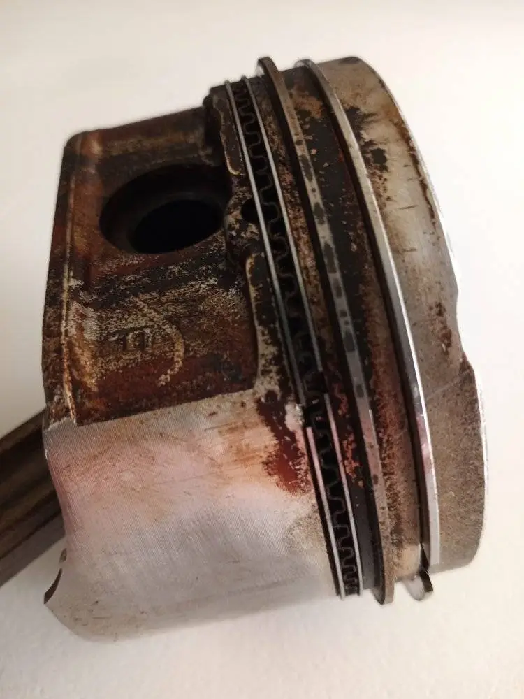

Well, the good news is: I found the problem of cold start smoke.
Bad news: Well, it's the rings...
Worse news: The rings are fine, not worn out, not scored, not broken...So, what is it then?
Ok, here's the details:
Mazda's pistons are crap! So f#"$%&ng bad, because they have one design flaw. The flaw that mazda jerks did not put any improvement in the pistons dept in 20 years!
The oil ring channel on the piston, has just 4 (four) tiny oil holes. Theese holes are used for the oil that was scraped off the cylinder walls while the piston was moving down to escape to the sump.
Naturally, more holes, bigger holes, the easier it is for the oil to sink down...
Ok, so, during time, oil and gasoline carbon deposits gradually plug these tiny holes up, preventing the oil from flowing down, and cooling the pistons, and bla bla...
The pistons overheat slightly, causing the oil that gets caught in the oil rings retainer to get sticky and guey and carbonised, turning it self into that hard -impossible to clean- resin / gunk / lacquer that sticks to your kitchen fry pans...
So, at the end you are left with the oil rings that are so badly stuck, glued, burned into the oil channel of the piston, that the oil rings do not even touch the cylinder walls.
The compression rings are a whole different story, and they are doing their job pretty good.
To make things worse, oil rings have sooooo weak initial tension, compared to the compression rings, that it is almost natural to have such a result.
Take a look in this picture. Look at the gap between ends of the compression rings, and compare to the gap between oil rings... You will get the idea..
Ok, so why does it only smoke on cold starts...
Well, here's why:
Once you start up the cold engine, there is increased idle rpm, creating a huge vaccum in the intake manifold, as well as in the cylinders, as the pistons are trying to suck the gases in, but the throttle fully closed prevent thet from happening...
So, as the oil ring doesn't seal the oil, the vacuum sucks the oil past the compression rings ** and into the combustion chambers, and.... tadaaa! Bluse smoke. Now, the oil is fresh and cold, hence, there is no pale blue smoke, but thick white smoke, clearly smelling like oil.
As the engine runs, 10, 20, 30 seconds later, the piston warms up, the compression rings warm up, expand a little, close the gap, so does the crappy oil ring, that finally starts to touch the cylinder walls, and the oil stops sipping up onto the piston.
There is stil some run by, but not so noticable, so the oil consumption is pretty high.
The solution:
Rering the sucker, but drill some extra drain holes in the piston oil channel, and make the existing ones a bit bigger.
** Compression rings are designed to hold the pressure, but not to scrape the oil of the flat surface. it is like your rain wipers on the windshield. They have to be thin, almost blade-like, to be able to scrape.
That is the reason why the compression rings do a perfect job of sealing the compression but leak oil past them like swiss cheese. And why oil rings are thin, blade-like!

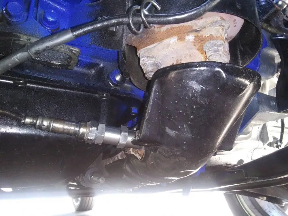

- Installed the Downstream an O2 sensor "Defouler" adapter to get rid of the
P0421 CEL (Pre-cat) code that recently popped up a couple times after clearing other codes (photo attached).
-- I used PB Blaster to wet the 02 sensor base down overnight and right before removing the sensor and used a 3 piece 02 sensor "free rental kit" (pay for it and get reimbursed when you bring it back) from Advanced Parts Store that worked REALLY well removing it.
- Installed a piece of 2" I.D. Sch40 PVC Pipe X 3" long into air inlet pipe where upper cover enters lower pipe (no gluing-just drop it in).
-- That area doesn't have a good seal (at least not on this P5) so it bridges the air gap so air can flow straight through to the air cleaner and beyond.
-- The pipe sits above the 90* turn opening to the air cleaner so does not interfere with the air flow.

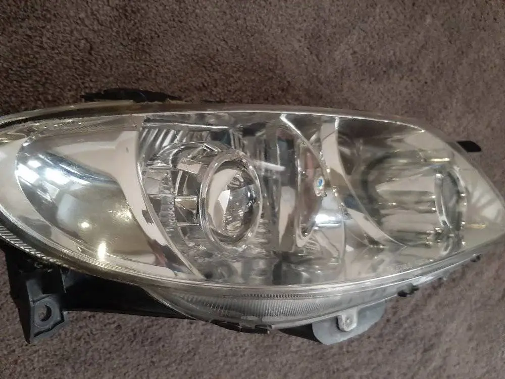

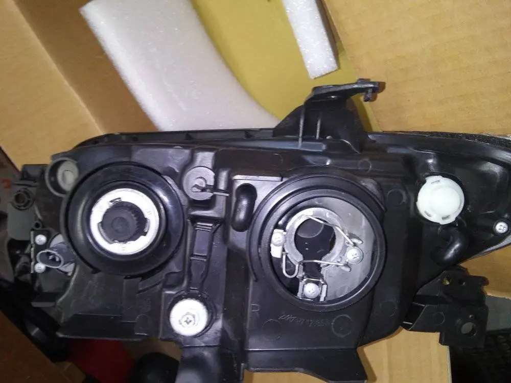

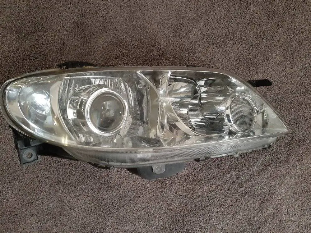

- After finishing installation of front bumper and new aftermarket headlights (that have 2 beam adjusters vs 1), I tried to adjust high and low beams and found out that one of the adjusters on each fixture is buried behind some of the radiator support/fender metal work that can't be accessed from the back (photo below).
-- The company brand (DEPO) made a slotted adjusted wheel provision to turn them with a tiny screwdriver along with a "capped" headed Phillips/Bolt head, and is a PITA to rotate in those tucked away areas.
-- If someone chooses to buy these fixtures, I would recommend cutting a little bit of metal away in the corner where they will mount to where you can have access to get at the adjuster from the rear through the fender-well area.
eBay Links - P5 Headlights - with Seller Pics
-- The do have bigger screws and wire clip holder arm shown in the photo below so that's an improvement over the (IMO) crappy original equipment lightbulb installation design.
I personally like the plug it in and rotate-it-to-lock design.

-After finishing installation of front bumper and new aftermarket headlights (that have 2 beam adjusters vs 1), I tried to adjust high and low beams and found out that one of the adjusters on each fixture is buried behind some of the radiator support/fender metal work that can't be accessed from the back (photo below).
--The company brand (DEPO) made a slotted adjusted wheel provision to turn them with a tiny screwdriver along with a "capped" headed Phillips/Bolt head, and is a PITA to rotate in those tucked away areas.
--If someone chooses to buy these fixtures, I would recommend cutting a little bit of metal away in the corner where they will mount to where you can have access to get at the adjuster from the rear through the fender-well area.
--The do have bigger screws and wire clip holder arm shown in the photo below so that's an improvement over the (IMO) crappy original equipment lightbulb installation design.

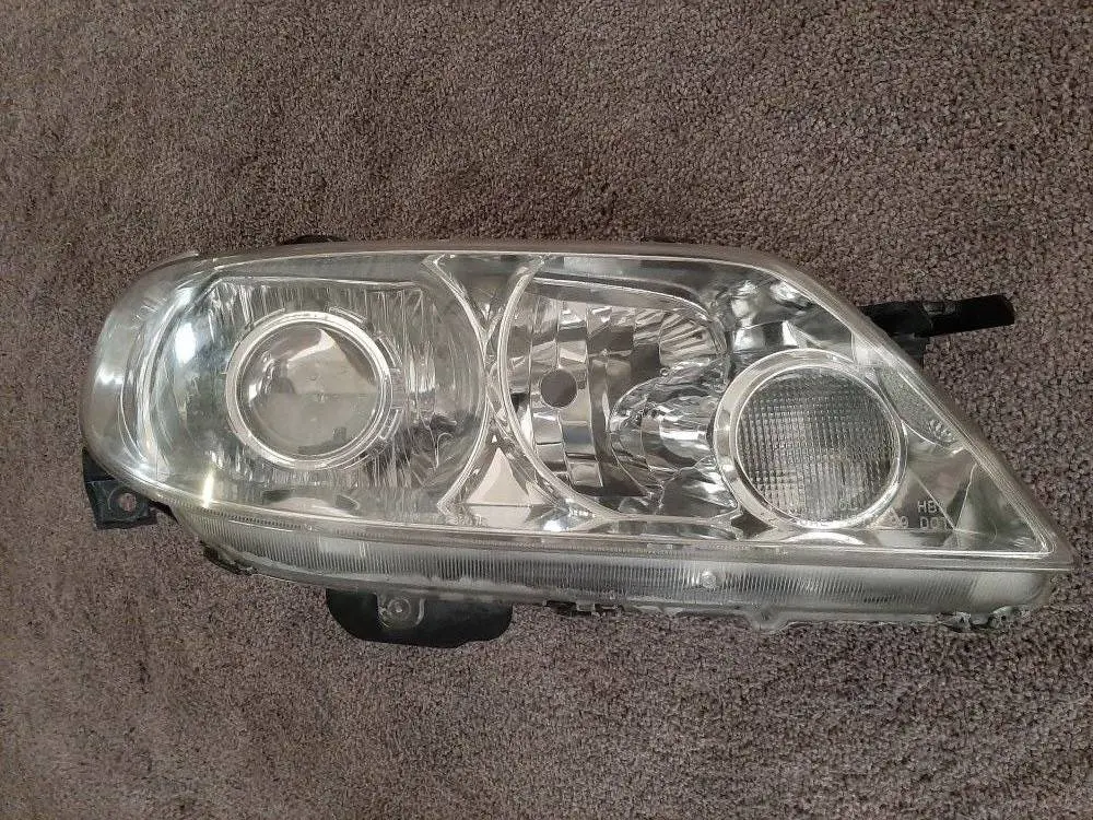

Shoot, I've got a stock pair of P5 headlights that just need a polish. I should have put them up for sale on here earlier heh.

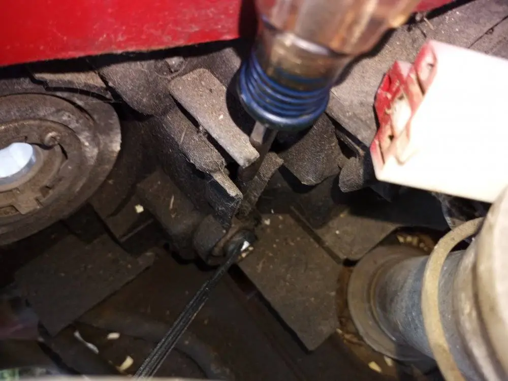

Not sure if you tried this, but I believe that adjuster is meant to be rotated using a Philips screw driver. I figured that out when I installed my retrofitted headlights a month back or so.
^^^ What he said.
You can reach down from the top with a Phillips screwdriver to adjust them.
The plastic "wheel" has notches in it to fit a Phillips screwdriver.
These are the options...
The pictures are from my parts car and I have half the engine removed.
I don't know how much crap would be in the way on my DD.
A regular Philips screwdriver is probably the easiest.
Huh, that's why I couldn't figure out how to adjust the ones on the spectra I sold before I got the p5, they didn't have the 10mm head, just the Phillips head in the center and the little teeth. I dealt with that car being cross eyed for a WHILE.
