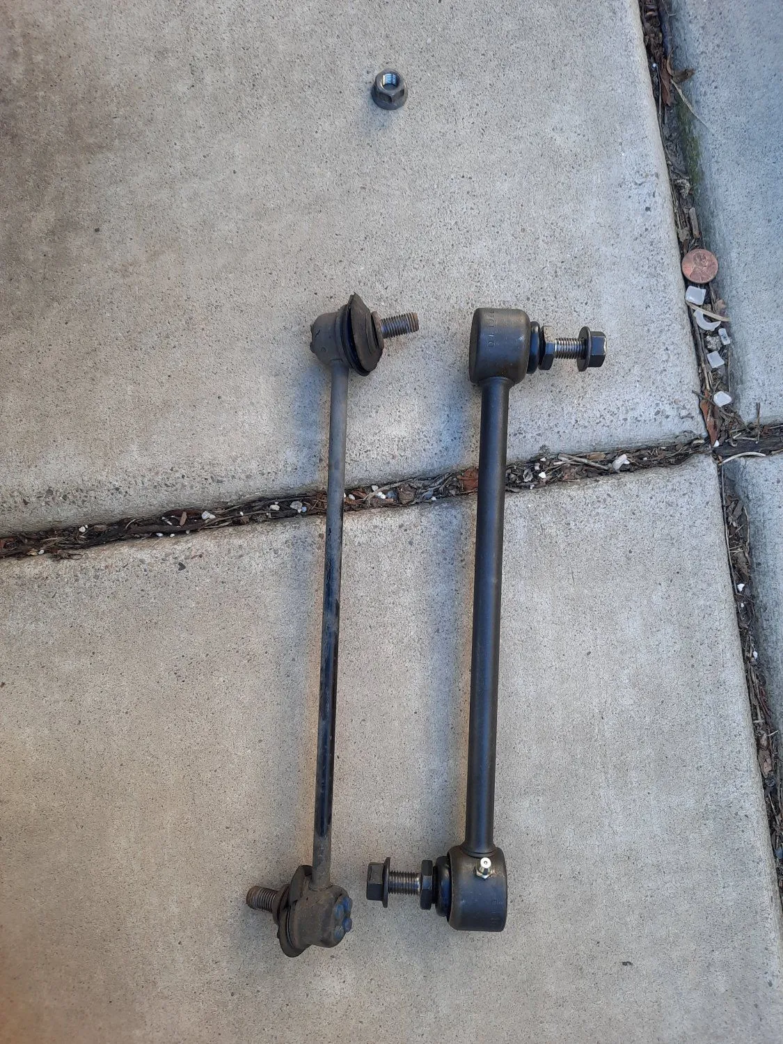

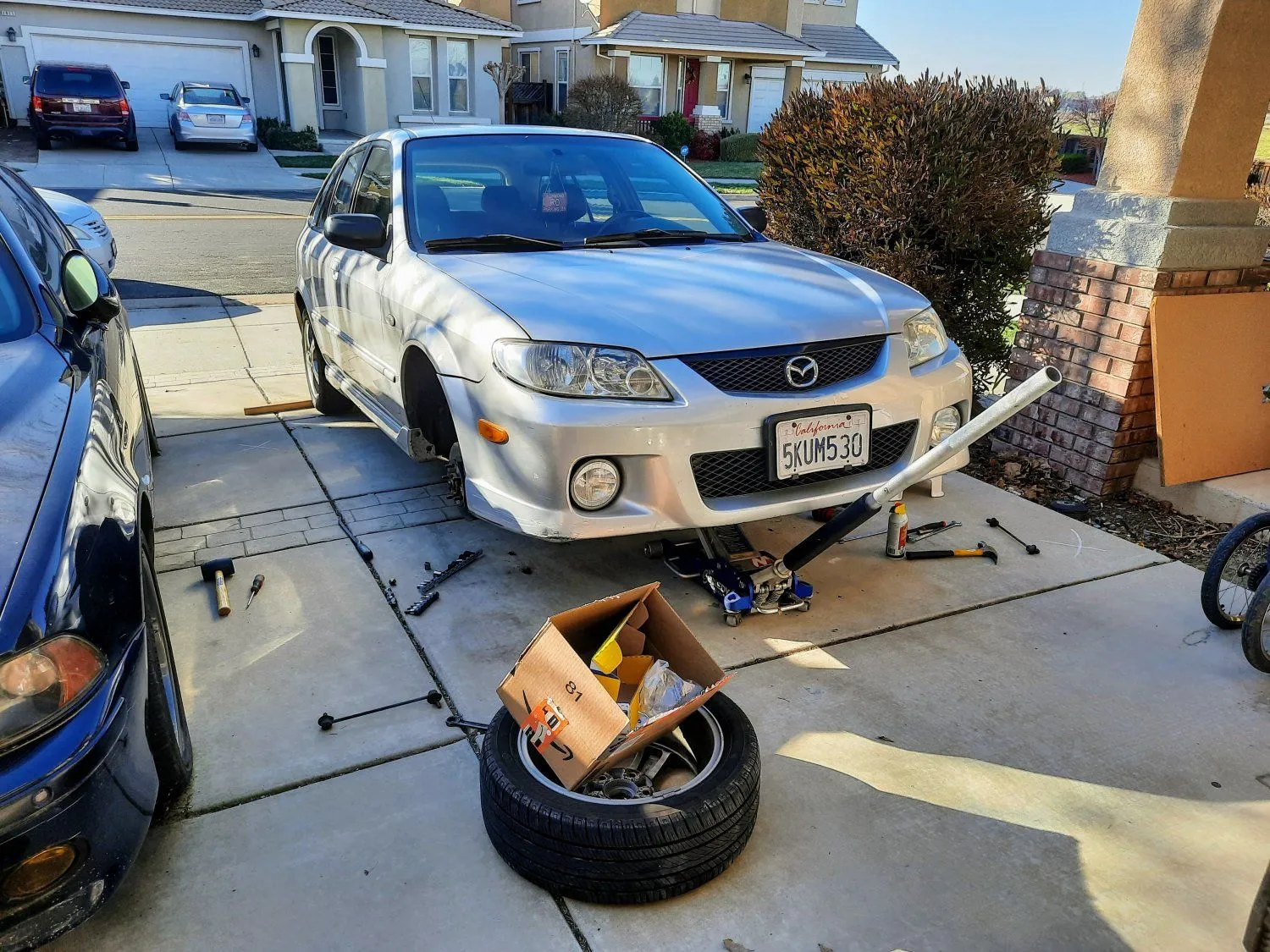

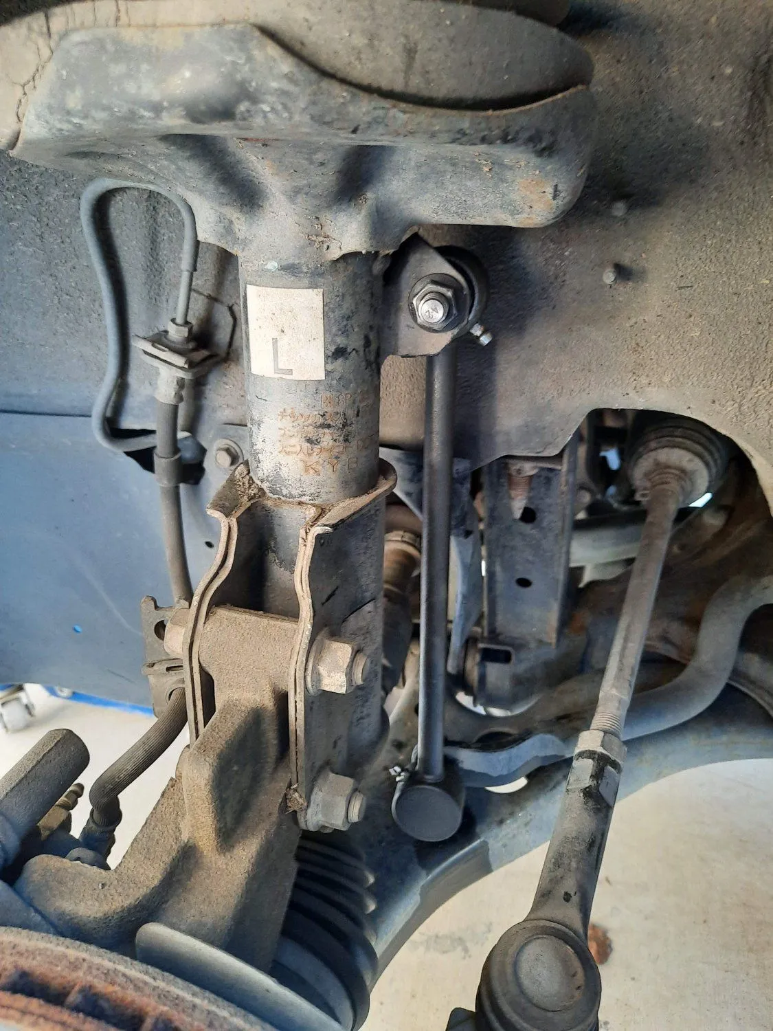

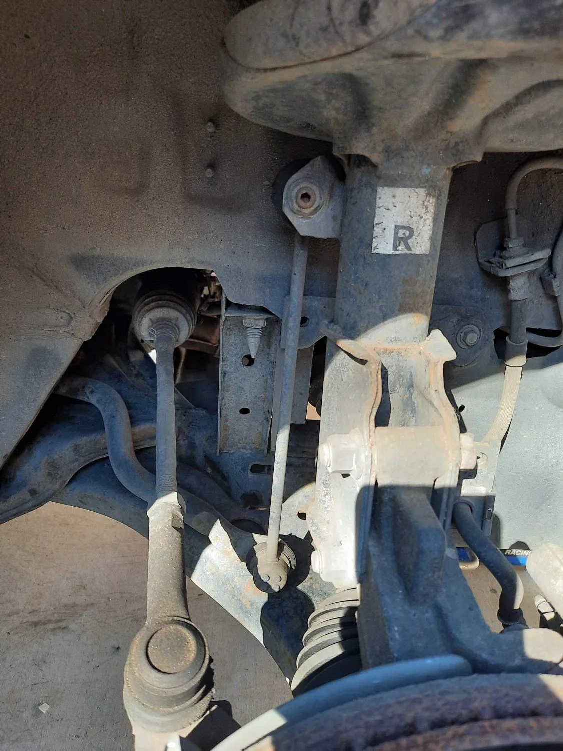

Swap end links Saturday. Replaced stock with Mood Ford Escape end links. Much beefier and with zirk fittings to boot. Stock ones are worn and boots torn off. Unfortunately, this was not the source of the clunk I've been haunting.
@dorihachigo nice work on those swaybar links! They look miles better than the oem links. Check your lower control arm bushes and swaybar mounts for wear, that's where my clunk was hiding :)
Thank you, I am planning to install new control arms along with struts, tops, and lowering springs soon. Outer tie rod could could use some replacing as well.
