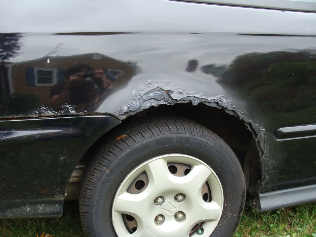

back when i had my civic, rust would constantly come off from bumping into the car when walking around or pulling bikes off the roof.
