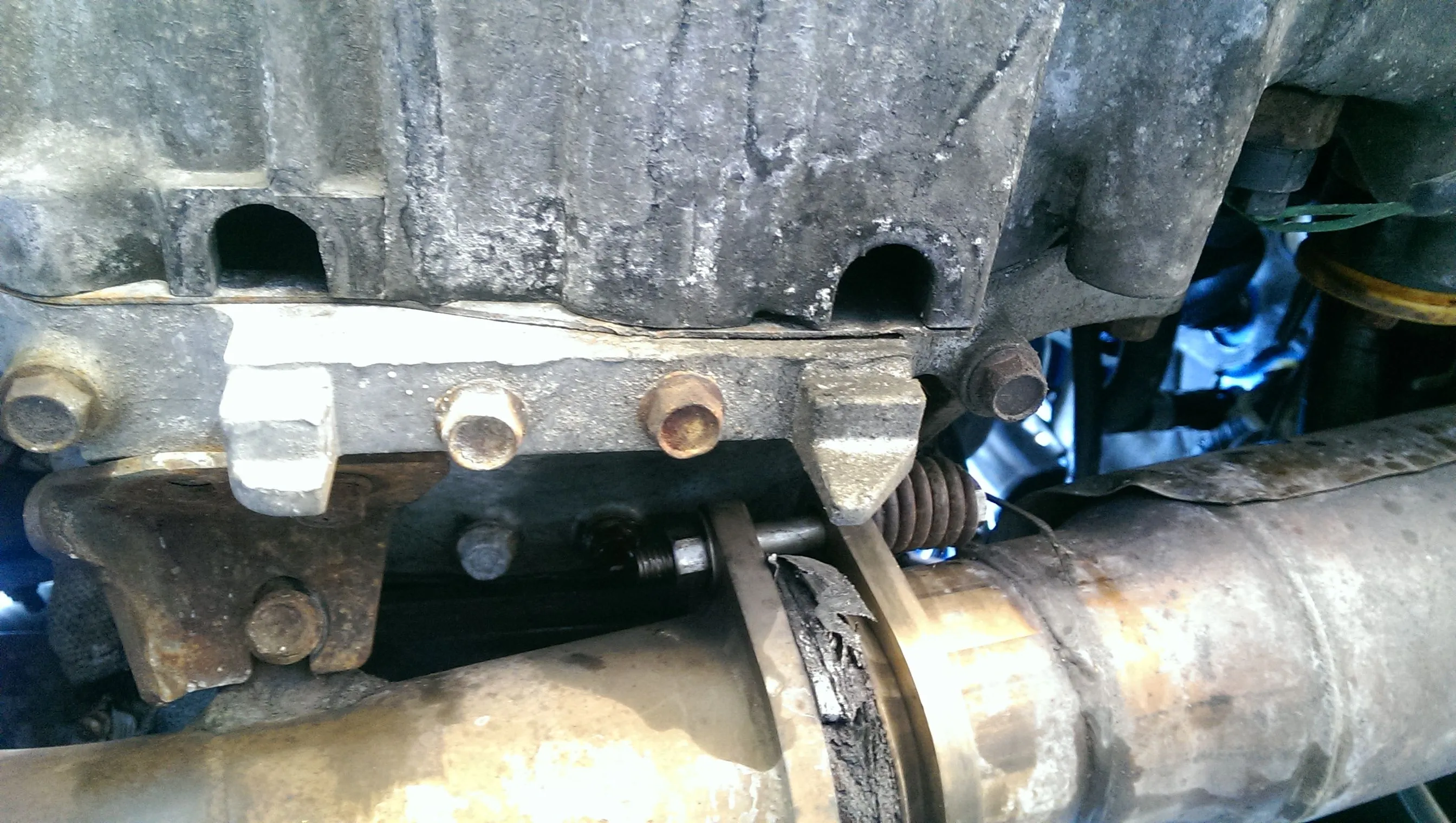

Here is were the holes to remove the mbsp need to be located.
Holes need to be big enough for a 10mm socket and long extension.
It's funny I have one speed no access holes and the the second the look like they came that way from the factory.
sheesh. not a lot of room to turn the wrench lol. I guess ill just have to drop the trans and pull the plate this time. i didnt change the rear main bearing seal last time so i guess this time there is no excuse. just a lot more downtime is all.
