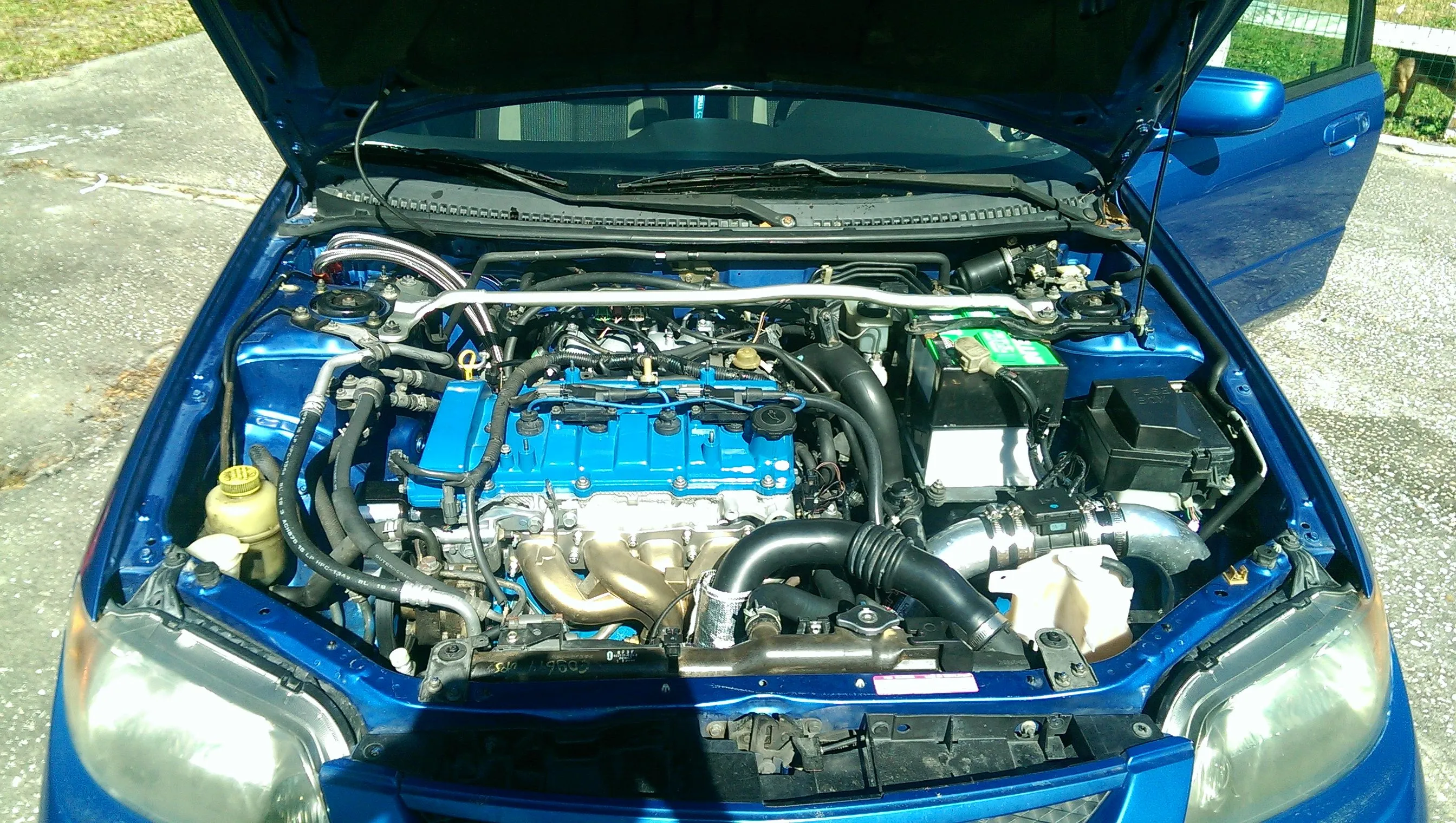

I put my new tube beading tool to work and beaded all my intercooler piping. The next job is to get the disco potato clocked properly and solve the misaligned wastegate actuator problem.

I wish canada had production numbers...might have to paint a p5 valve cover soon. Looks sharp.
