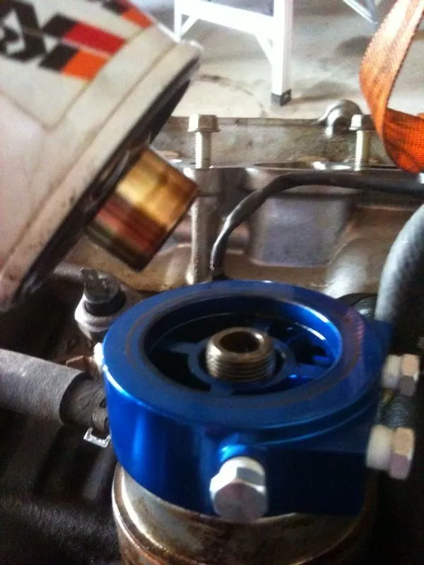

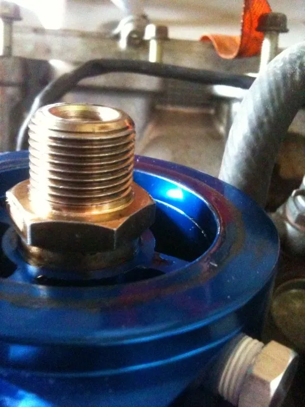

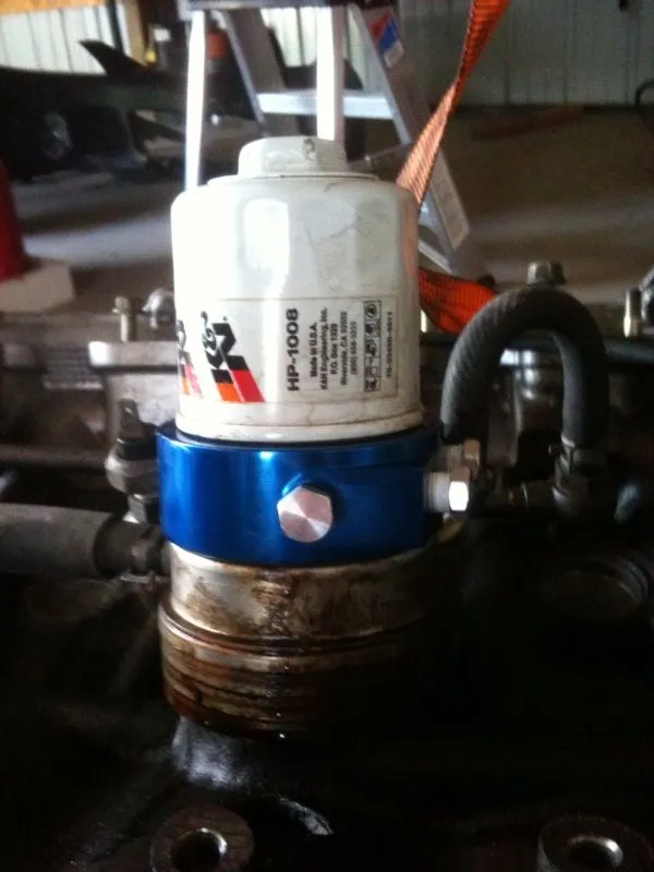

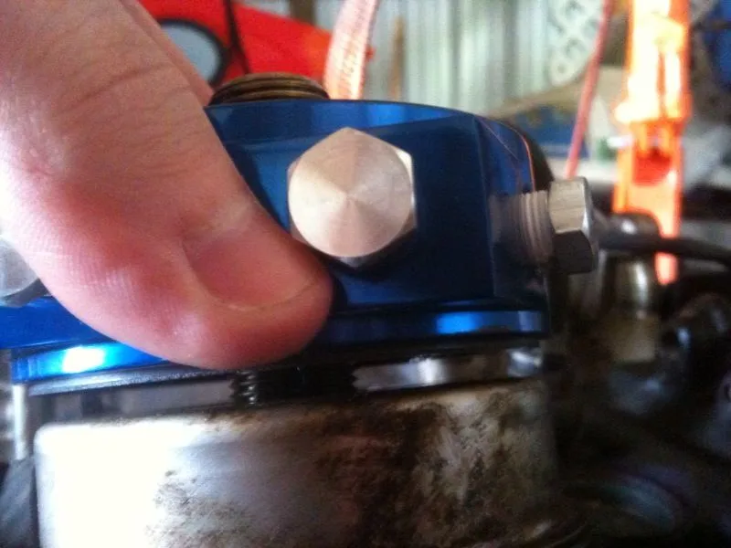

See its fits for me, But as you see the first pic is it installed.
Second is how I was able to, I just screwed it on the filter and put it on (which doesnt need tobe done could just tighten over the stud for the oil filter, but then that leaves to slack (picture 3) But when the oil filter goes over it it tightens it down to how pic one is. And the last pic just show how far off it is from being 100% tight. But It does fit. just when you put it on it wont be tight till you have the filter on.

Yeah I was just mainly messing around trying to see why It didn't fit, then BAM! It went on hahaha.
I don't want to be the bad news guy, but I would be willing to bet that you will end up leaking oil doing it this way. The sandwich plate really needs to be secured to the cooler tightly before putting on the oil filter or oil is going to seep out under pressure (when the engine is running). I know this because when I first put mine on, even after cutting the threaded pipe so the plate flushed up tightly to the cooler, I didn't have a deep enough socket to tighten the nut down well and the leaking got progressively worse as it continued to loosen. I ended up buying the correct socket and taking it all back apart to tighten everything down correctly. Now I have no leaks, the oil pressure sensor sends a steady signal, and everything works well.
