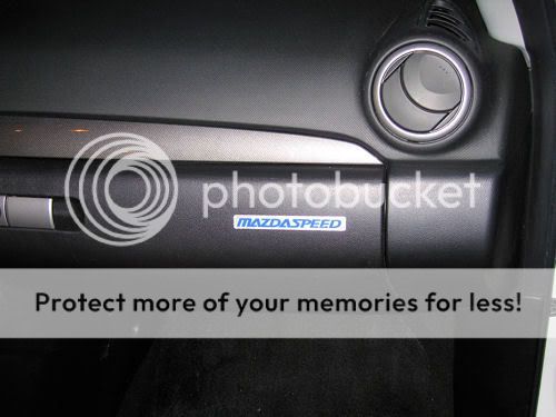

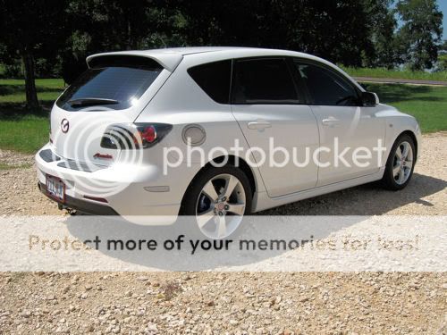

Man, it's been a while since I've been here... I don't even remember what the last mod I listed as being?
Here are some new/newer ones....
Alum Fuel Door
Pilot Shift Knob (Yeah, it's a cheapy, but I like the way it feels in my hand, and it's heavier than the stock too)

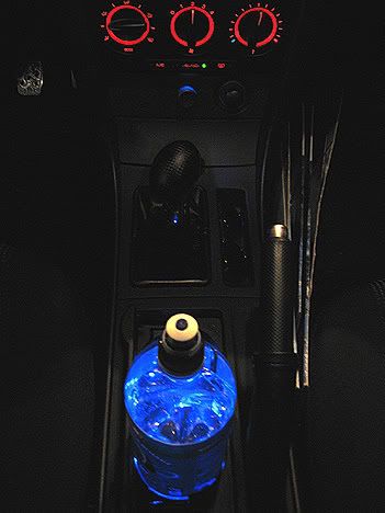

LEDs in the cup holders. Output is controlled by the pot just above the ash tray.

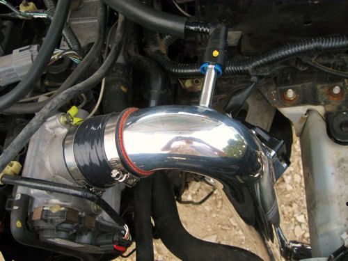

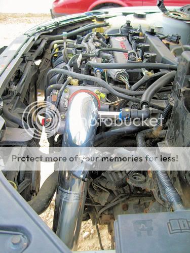

MS CAI

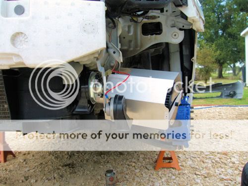

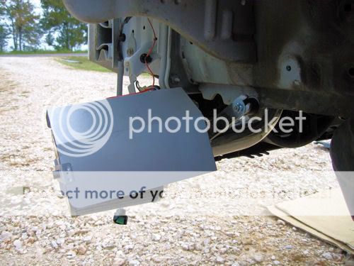

Dual Horn Mod
And not pictured: H&R's; Koni Yellow's; RB HD Sway bar links; REDLINE Hood Quik-Lift Kit installed; Castrol Synthetic 75w-140 gear lube.
Also, on order (will receive in a couple of weeks: ) Kosei's K1 TS's, 17"x7"x+50mm and Kumho ASX's, 225/45x17" The tires are 2lbs heavier than my Falkens, but the wheels are nearly 5lbs. lighter. That should lighten things up a bit!!

At 7500 miles, synthetic oil change and service, Redline MT-90 in the transaxle, and finally got an MS CAI. Pleasantly surprised that it isn't too much louder in everyday driving.

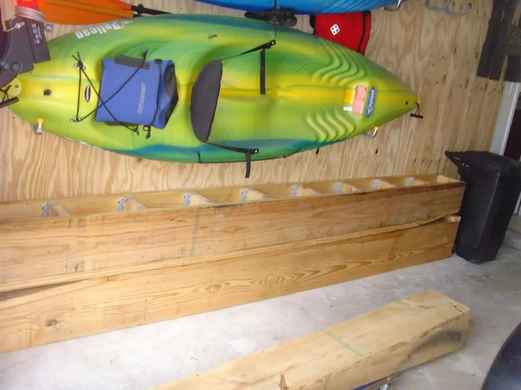

Geez, thos are massive....hope u have room to store them!!!
look nice and solid though!
I was thinking the same thing, but WOW, instant grease pit!! (lol) And I'll bet they weigh a ton too.
Won't help much if you need to remove the wheels though.
I especially like the finger in the first picture. (rlaugh)

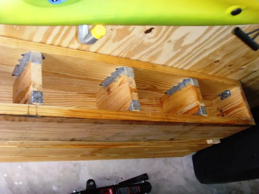

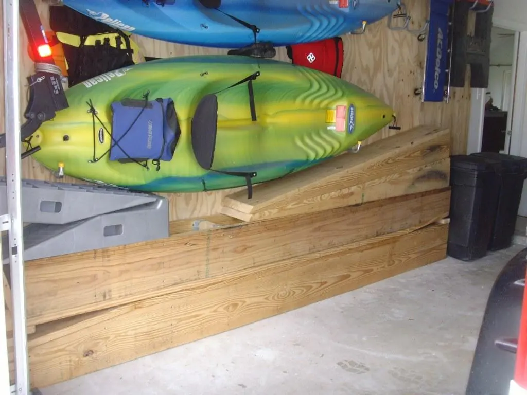

How about posting the dimensions and parts list ,it would save me some time building a set
sorry about the wait.
i used 2x12x12 for the main ramp. The car is too low to use the rhino ramps to get up on so i used 2x12x8 for the wedges. I also used 3" wood screws all over it to keep it together with steel joist hanging brackets to secure. I put in vertical sections every 16" to strengthen it (cut the wood so grain id running vertical for strength.
Not a very good explanation i know but i've had a bad day so sorry.
Here are some pics, next time i will build from steel, it'll prob be lighter, stronger and no doubt last for ever.

Thanks you have give me all the info I need to make my own.

for the sides of the wedges you can use a 2x10x8 and cut it diagnally to make the 2 sides from 1 peice of wood. That is actually what i did but for some reason it was just easier to to say 2x12x8 in my last post.
