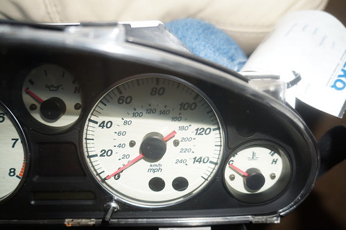

As promised, here's a picture of the instrument cluster I bought while away. It doesn't really show the beige faces well, but you get the idea.

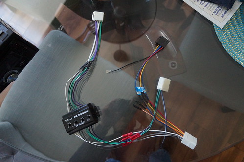

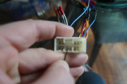

When I got home I installed the CarbonMiata seat belt extenders. They went in with no problems, however the seat belts don't retract properly now. I'm going to see if having the belts that accessible outweighs the inconvenience of the retraction issue. I then went about getting the wiring harness together for the new radio. Got that all done only to find out I had no output. Looking at the drawings, I no longer have a power input to the Bose amp. I think I can move an unused wire from another connector in order to fix this but I have to do some more research.

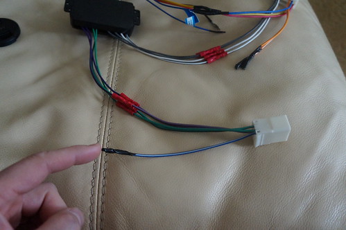

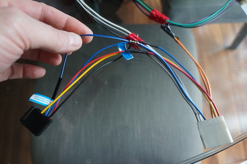

Got the radio harness figured out. Turns out the wire I needed (blue/white) is in the connector that '99-00 doesn't use. I was able to coax the pin out of the connector and then put it into the correct spot on the connector I use (the blurry picture below, I got the location off Miata.net). Then all I had to do was solder it to the power wire coming out of the radio connector (also blue/white).

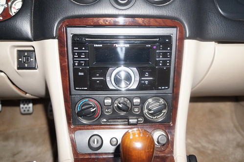

Now all I have to do is figure out how to connect the antenna so it only powers up if the radio is on, and connect the radio to my dimmer circuit. I am also going to make some better side brackets out of steel so the radio is more secure than it is with the plastic brackets included with the kit. Here's how it looks installed:

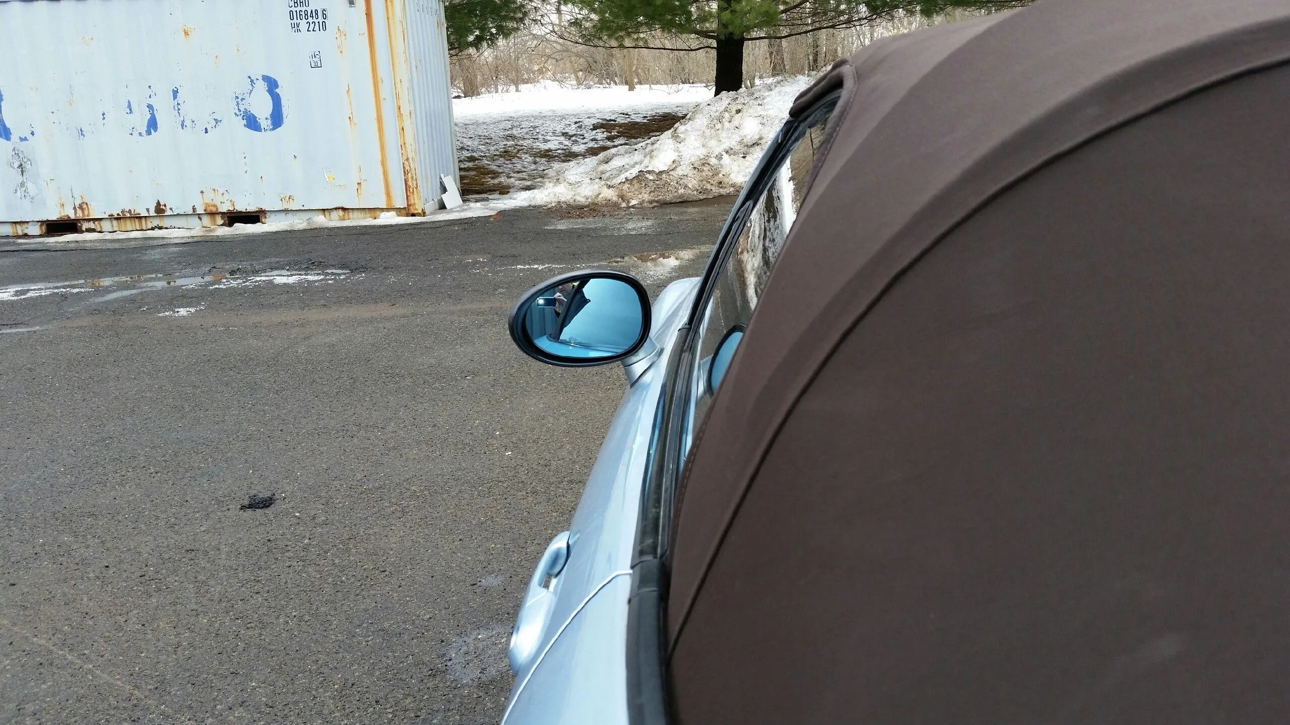

Got my Moddiction blue tinted convex mirrors in today and installed them this morning. Haven't driven with them yet but from sitting in the seat to adjust them I def. have a much wider view of the area behind me. All the better to see those tractor trailers! I'm thinking I should get an insurance discount for them. lol
